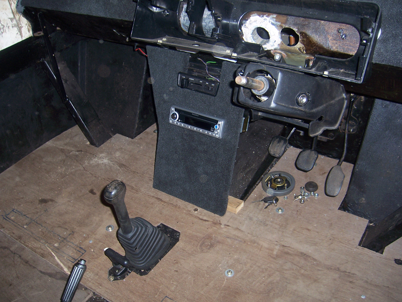

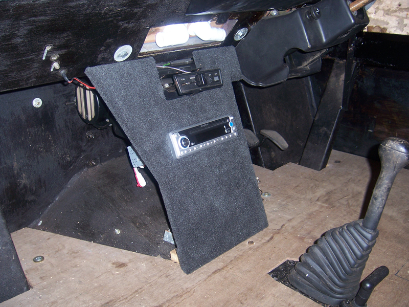

Well, electrical problems notwithstanding I've at least managed to make some progress in other areas.
Interior:

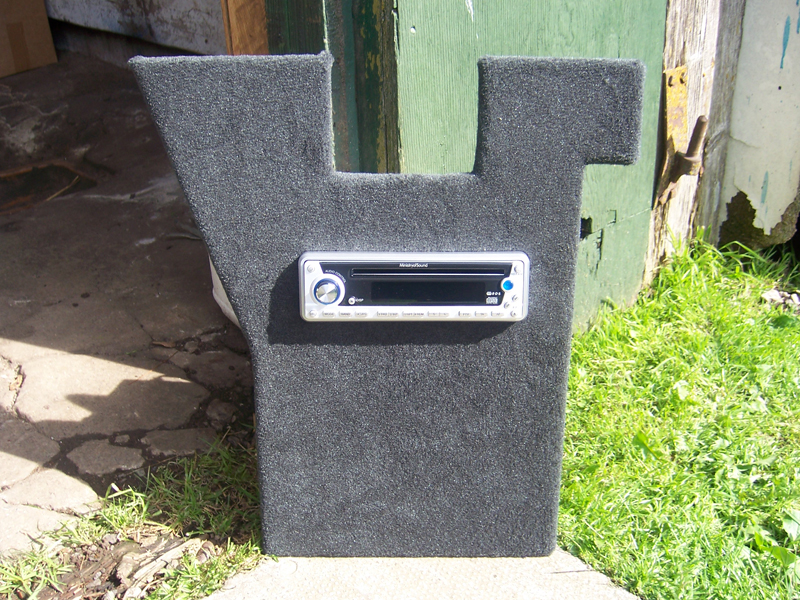

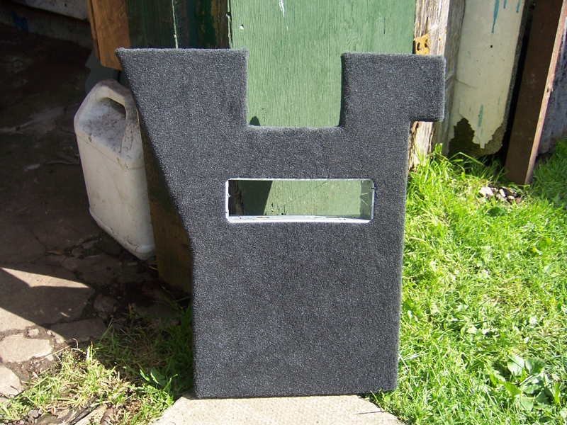

Made a panel with plywood, carpeted, to act as a centre console which will house the CD/MP3 player. It also acts a support/surround for the heater and controls.
Made a new panel for the back of the cab. This will be carpeted and installed on the next trip (after sorting the electrics of course).

Got the pictures off my brother's camera today for the centre console work I did for the 'Rat. It's just a sheet of plywood cut to shape with the same carpet glued and stapled to it as the bashboard panel.
