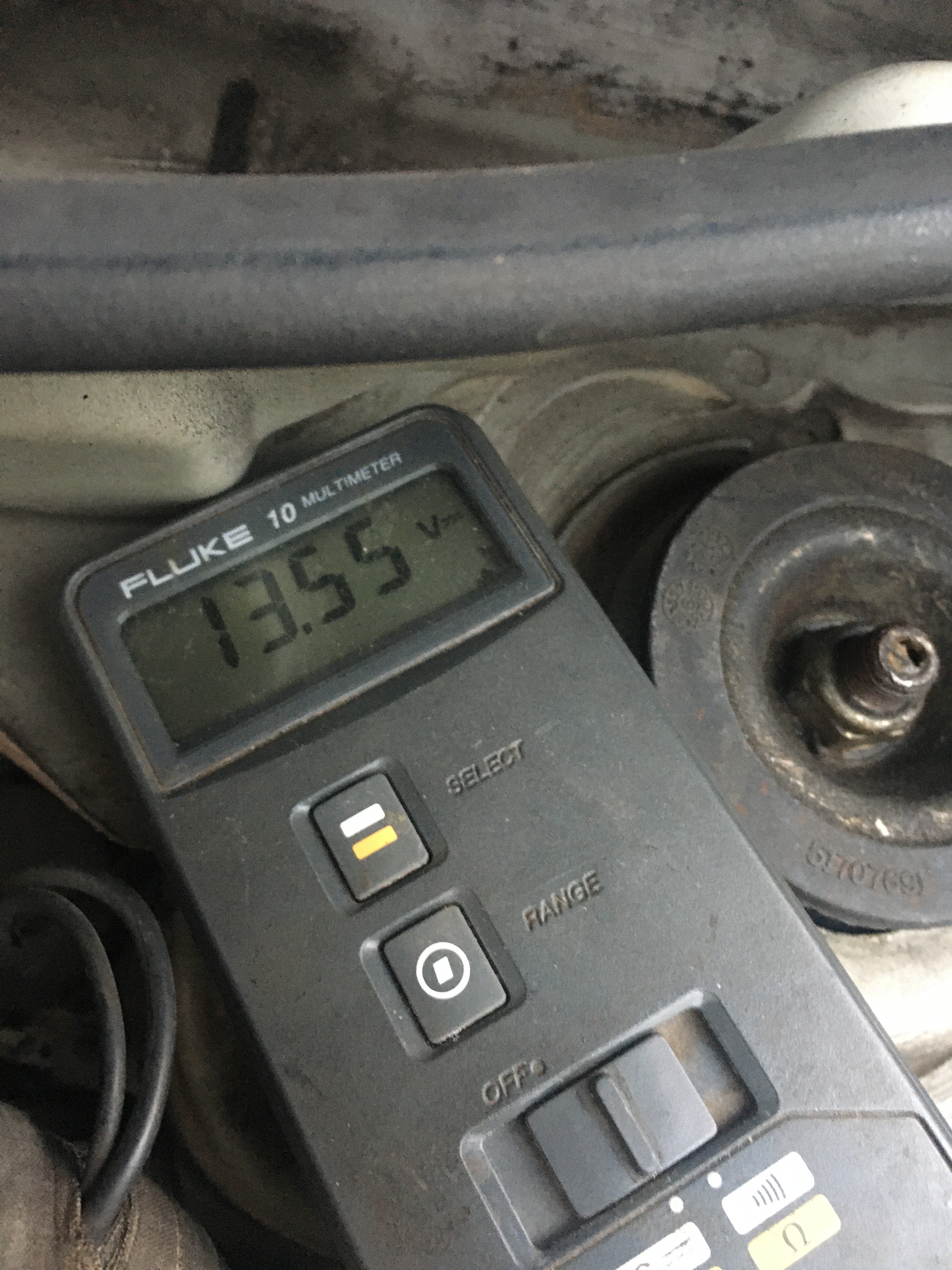

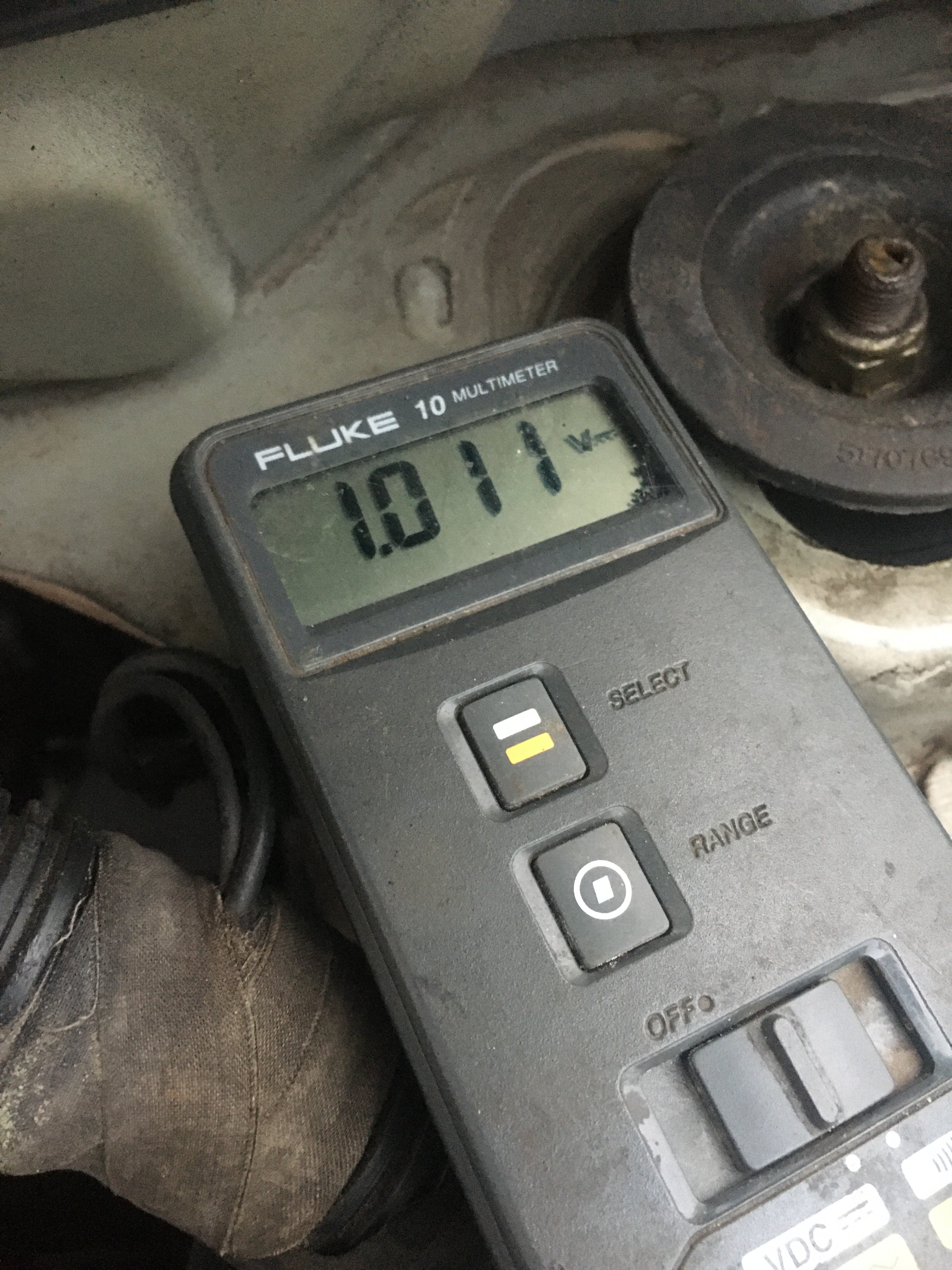

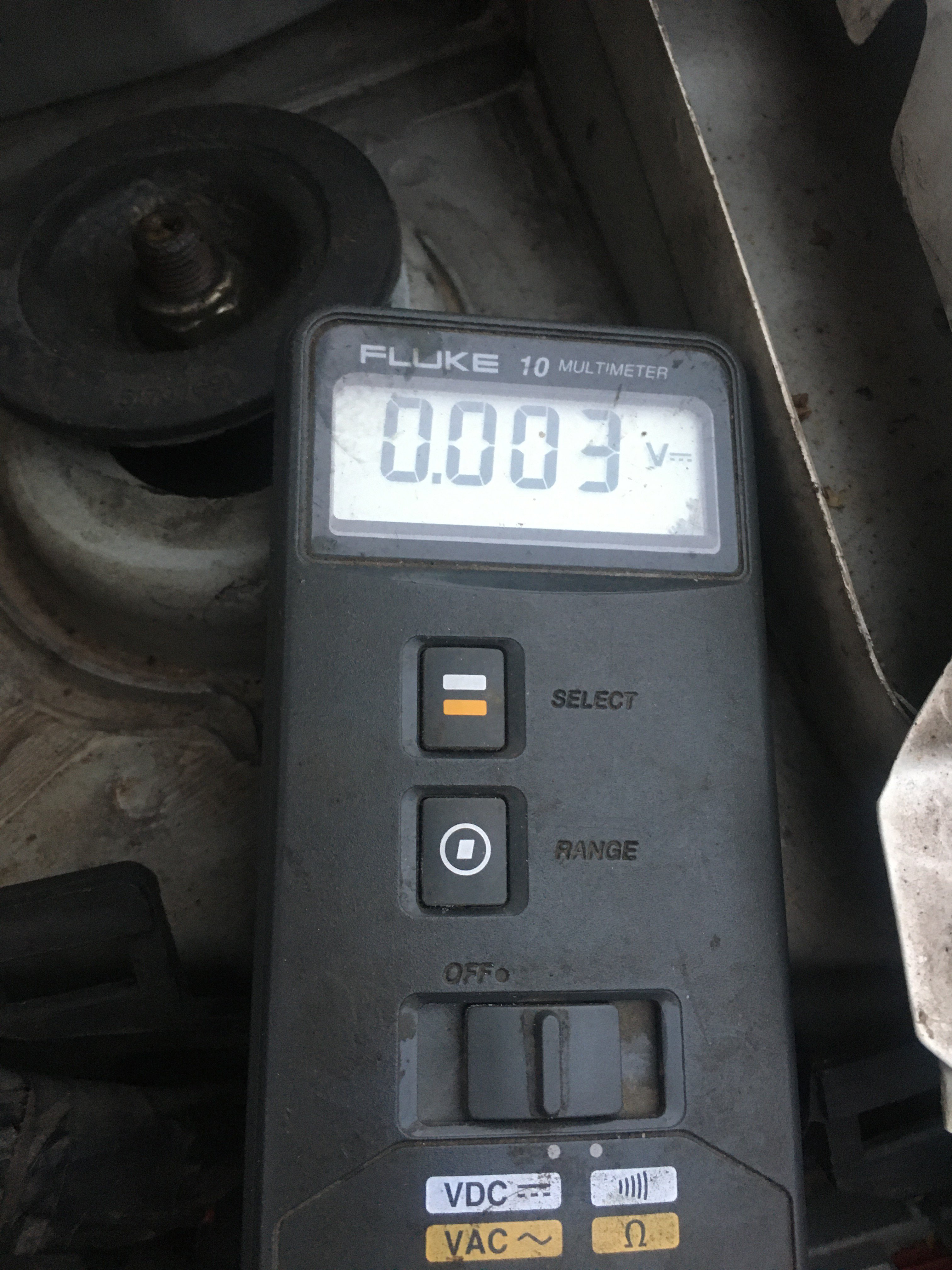

If you have access to jump leads, put one between the battery negative terminal, and the engine. If the problem goes away, the cable is at fault. A voltmeter across the battery will show if the alternator is charging. Should give around 14v with the engine running. If not, wriggle the earth cable, (under the battery, so be careful not to touch anything moving, or hot.) If the voltage changes, that again shows the cable as the problem. If the cable if fine, the alternator is the most likely problem.
