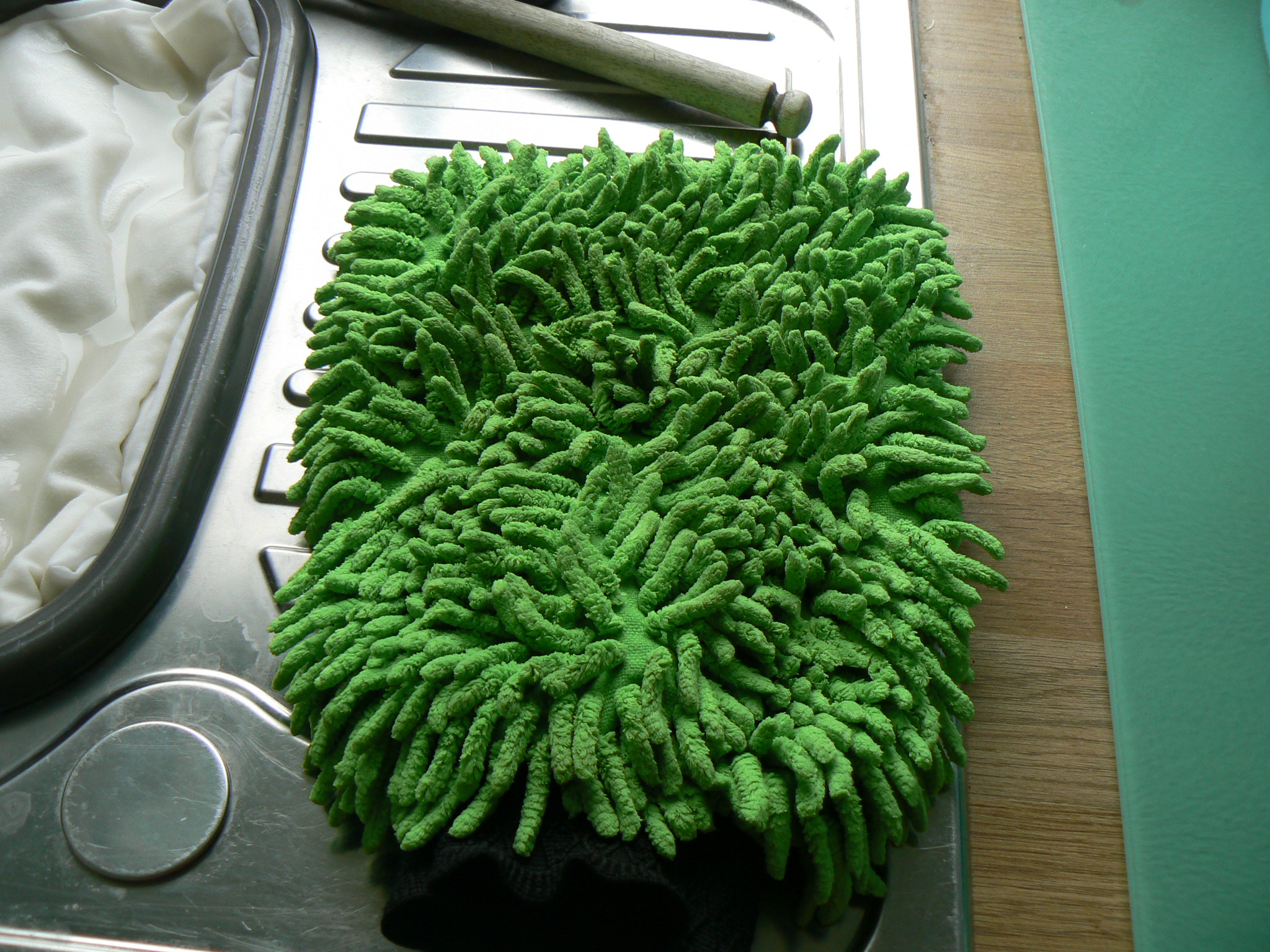

I didn't like the idea of getting too aggressive to begin with so I filled my bucket with some quite hot water, but not so hot I couldn't put my hand in it, and emptied about twice the normal amount of car shampoo into it. I was feeling most concerned about the Ibiza as it's my "good" car so decided to start on an out of the way bit on the rear bumper. I first gave it a rub over with the shampoo solution and left it to soak while I made a cup of tea. Then I started rubbing at it, in straight lines so I was not creating swirl marks, with the noodle mitt:
and slowly, very slowly, it all came away.

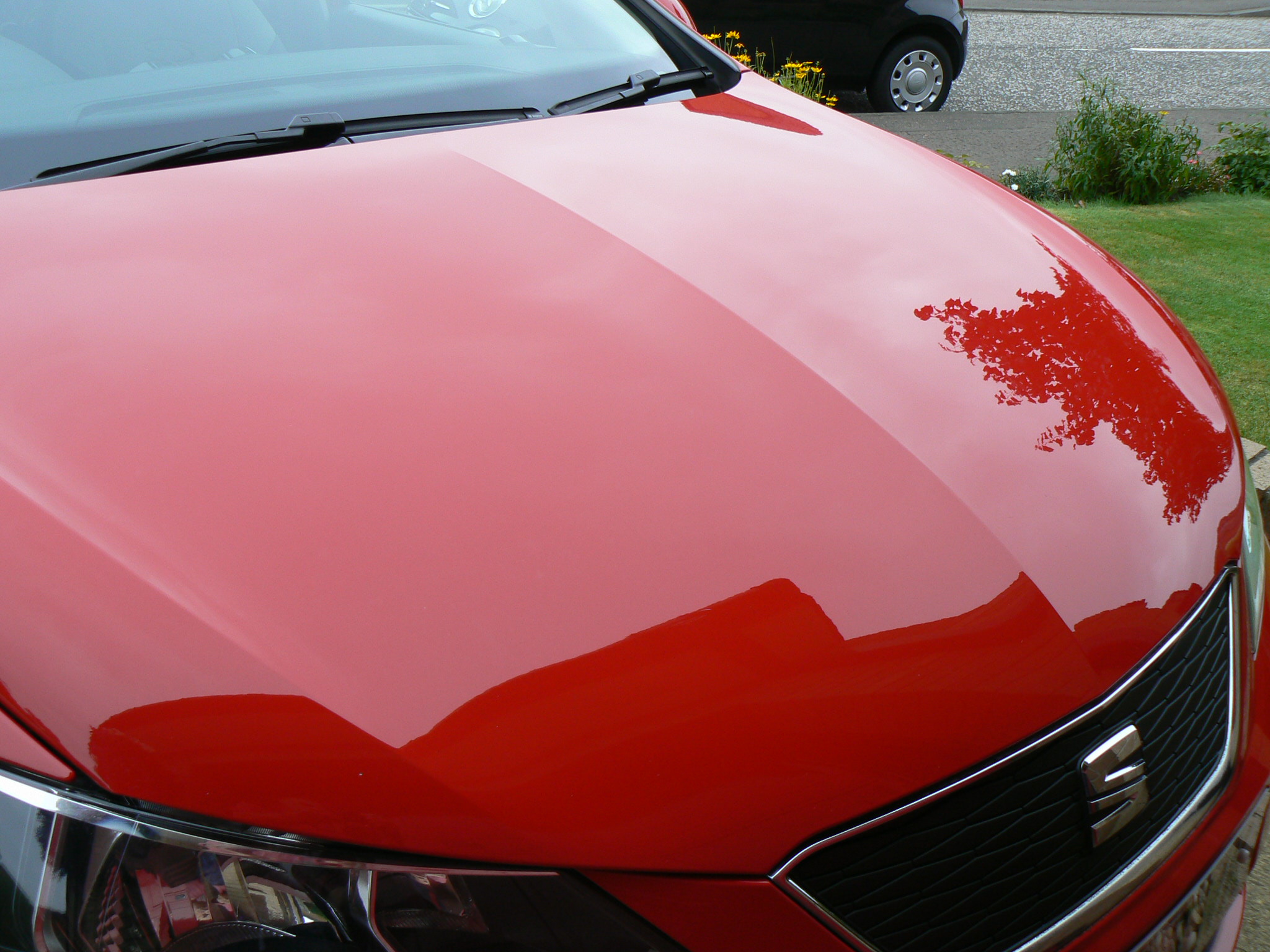

Encouraged by this I next tackled the bonnet. Same proceedure. Wet it down first with the hot shampoo mix, leave it a few minutes to soften and then rub at it in straight lines without "leaning" on it too enthusiastically. I did the bonnet in two halves rubbing it from side to side, so I was standing by the front wheel pushing the mitt away from me and pulling it back again. Probably took a little under a half hour and then, thinking it was all done, I rinsed it off only to find that although much of it had indeed gone, some of the larger spots were still there. Further rubbing with the noodle side of the mitt didn't seem to be doing anything - Oh dear! The reverse side of the Mitt has a different, textured, finish to it:
but I can't remember what it's maker recommends that side is to be used for, maybe glass cleaning? Anyway, I had a good feel of it with my fingers and it actually felt quite soft, so I decided to try it on a wee area around one of the headlights where, if it left scratches, they wouldn't be very noticeable. It shifted the marks much more quickly and, after drying, I couldn't see any scratch marks. So, take big breath and try it on the stubborn marks on a wee bit of the bonnet. Great, seems absolutely fine. So I continued with the rest of the marks on the O/S of the bonnet, all the time keeping it well lubricated with copious amounts of the very soapy shampoo mix to lubricate it, rinsed it off and dried it with one of my big microporous drying cloths. Almost too frightened to look, and, whoopee, black spots all gone and no scratches I can see!

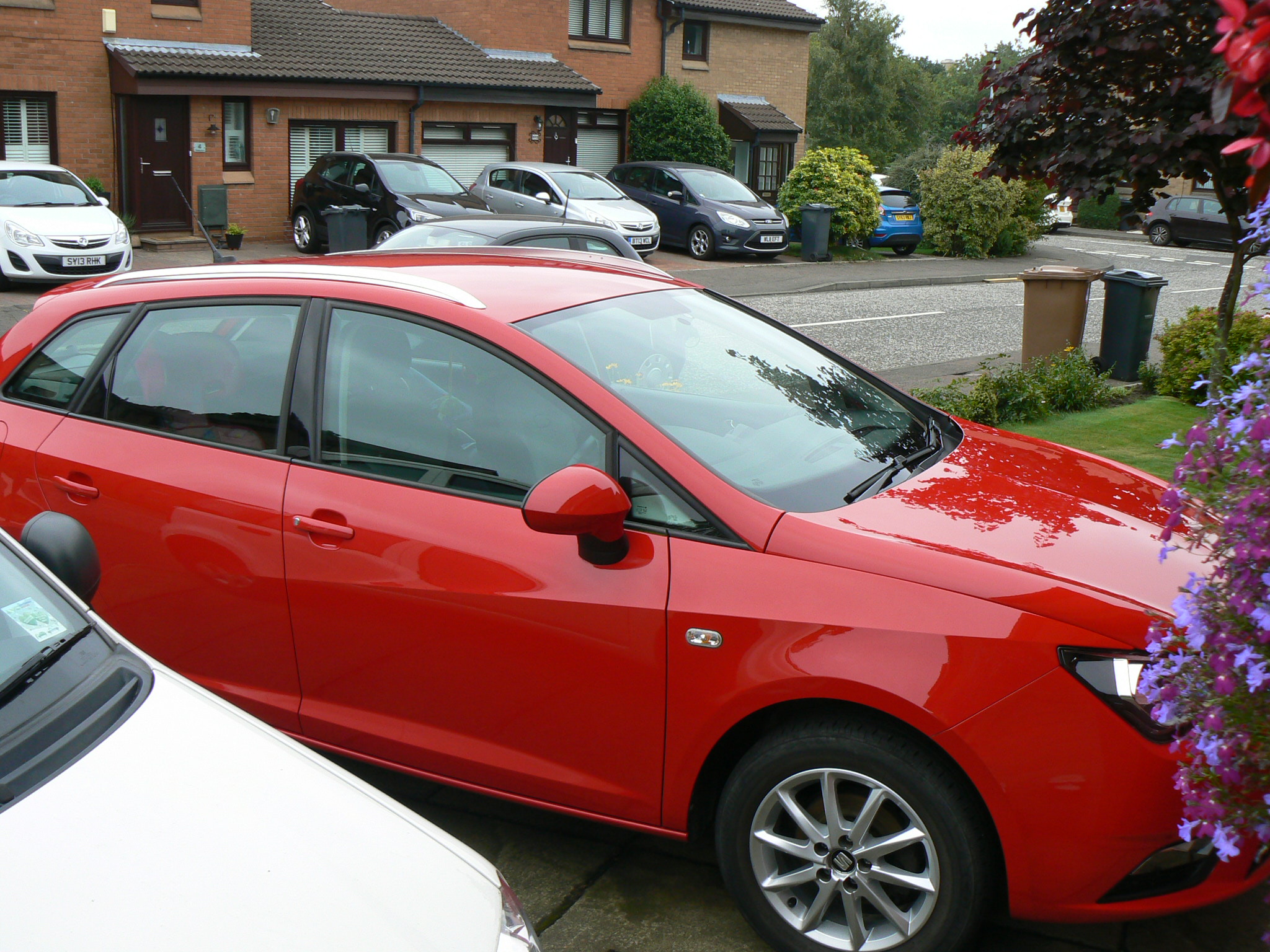

Here's some pics of the end result:
The slightly mottled effect on the bonnet is actually the clouds being reflected in it. You can see the shine is so good you can see the pebbles reflected in the N/S rear door. Unfortunately I didn't take a pic before I started - because I was feeling too panic'd - the transformation has been remarkable!

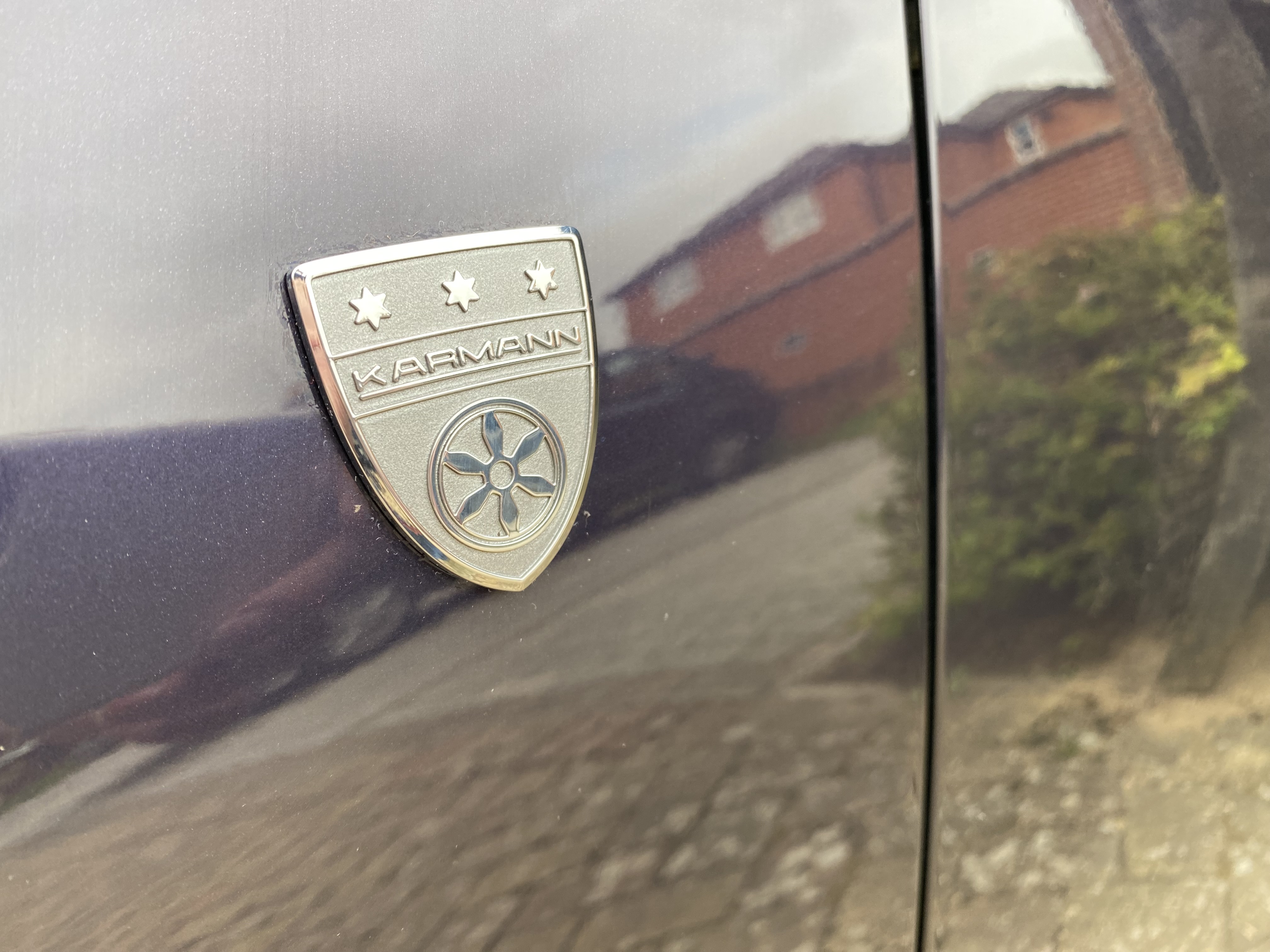

I recently fitted some Karmann badges but the picture I took shows the reflection and believe it or not this is the car dirty without having been cleaned for a couple of weeks
