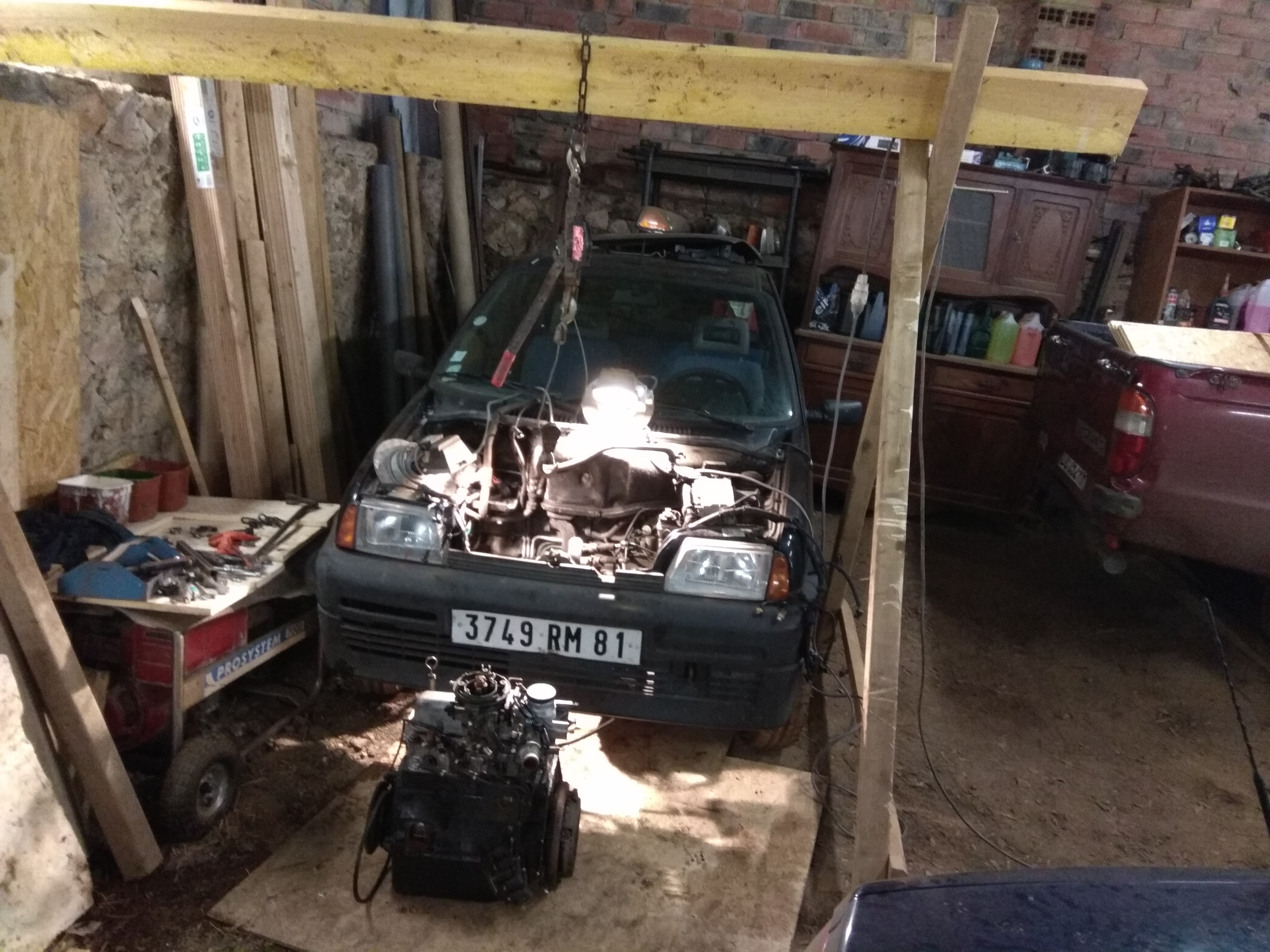

I am going to soon swap out the ropey 965 pushrod engine in my mkI 4x4 and replace with a 998 SPI from a cinquecento....I have a couple of questions though that I havent found elsewhere.
1 - what electric fuel pump did you use?
2 - did you mount it in the engine bay so its sucking through the lines or at the rear so its pushing through the lines?
3 - fuel filter...before or after the pump?
4 - did you fit the charcoal canister vapor recovery stuff? if not, did you just plug the pipe on the throttle body? does leaving this off effect the ECU...ie bring on the fault light?
5 - did you fit the cat converter? if not, how does it do on an emissions test?
Thanks a lot.
