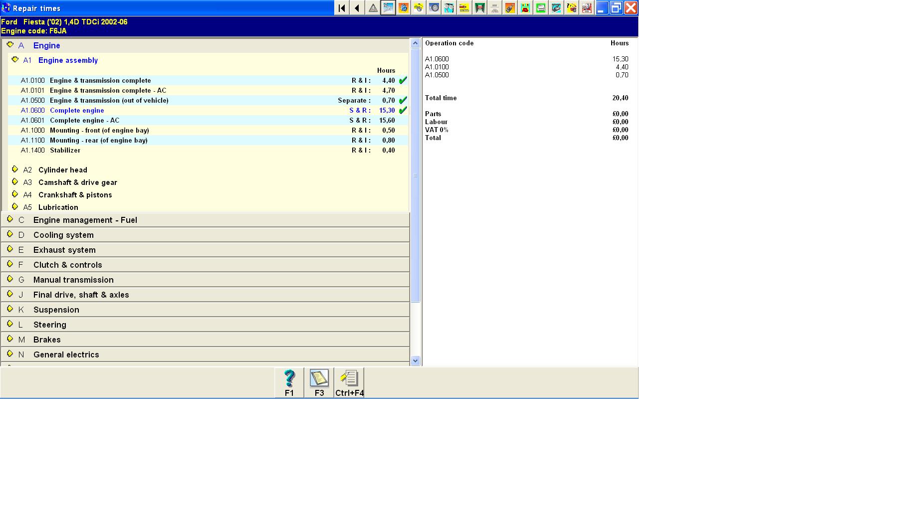

this any good?
it was behind the sofa
R & I = remove and install
S & R = strip and rebuild
separate is splitting gearbox and engine after that its normally only 6 bolts to change clutch, if its dual mass i dont know if its longer
so removing stripping and rebuilding refitting is half the time that they have said just for remove and refit
