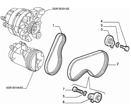

Ok, not often i'm asking Seicento questions but does anyone on here have one with air conditioning fitted?
I'm after photos of the drive for the compressor, the belt, the pulleys and compressor mounting points - the general AC compressor kind of area really.
If anyone has the Seicento workshop manual, some diagrams off that would be handy too :)

paulbfd said:
Won't the online eper thing have any pics?
You're not thinking of fitting a supercharger are you?
i couldnt find any good pics of the actual compressor and drive, only the piping for it

Hmm....I think I can guess whats going on here. Smells very Eaton'y :)
I have some stuff from the Cinq ripped off ePER, it takes its drive from a belt driven off the alternator pulley..dunno if thats much help mind!

ive got a 1994 899cc cinq suite with aircon (it doesnt work though) there is a large bracket which bolts to the side of the motor,the alternator sits on top of the comressor and the diagram of the pump is correct if you need some pictures i could take some tommorrow the prob is its as tight as a gnats chuff down by the pump so the may not be the best pics

it's the 1108 engine i'm after photos of really, but i'm sure there was talk of someone wanting to supercharge an 899, so them photos would still be appriecated :D
