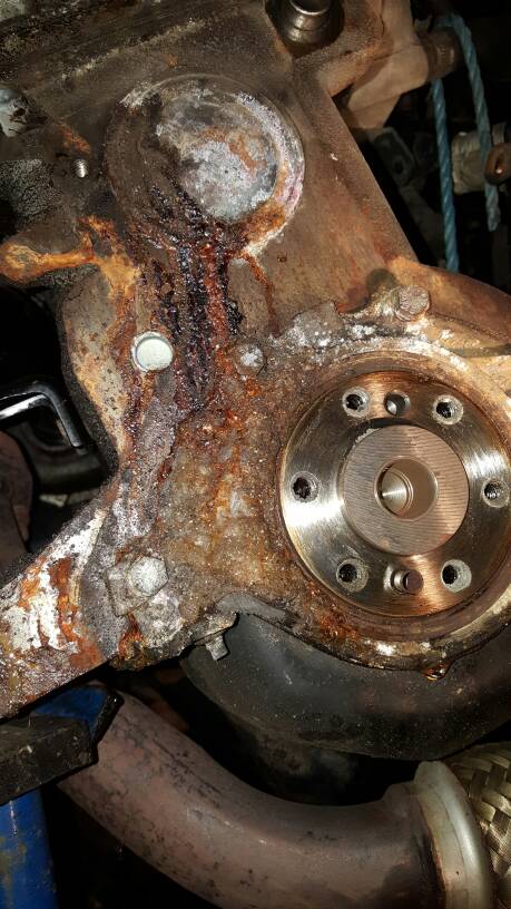

So picked up my 1999 Seicento Abarth on Saturday. Really decent guy selling it had said about the various faults/issues.
The main one being a coolant leak, dripping out of the bottom of the gearbox bell housing. Dohhhh.
So car was very good otherwise so the deal was done and with a boot full of coke/milk/lemonade bottles full of water I headed the 50miles home stopping along the way to top up the coolant.
Once home and in the garage I stripped the gearbox, clutch and flywheel out to be met by this beautiful sight.....
2 morals of the story
1. Always make sure you have the correct antifreeze/coolant mix in your car. All year round!
2. The previous owner had the clutch replaced a year ago so had he/the garage know about this problem they could have done it there and then. So if you're doing a clutch on your Sei/Cinq or a FIRE engine spend an extra 5 mins popping the flywheel off to check this core plug. Time well spent.
Core plug is £5 from Fiat. I will replace the rear main oil seal at the same time for good measure which is £8.
Then flush and refill the coolant with 50% antifreeze and 50% deionised water.
bit controversial as some love it some disagree with it. but in the case where coolant changes have been neglected I've had good results of a dishwasher tablet in header tank.
Flush out current mixture, refill with plain water and crush a cheap dishwasher tablet (pay attention to selection of tablet some have high salt and are no good) into header tank. Then go for a thrash. On return flush system out thourghly and refill with a fresh mix.
I've always been amazed the amount of rubbish this dislodges i believe this method gets used regularly on k series engines when k seal has been used in the past and needs to be removed
No Purf. Surprisingly the sump is in really good condition.
I think because where the core plug has been leaking it was running inside the bellhouseing and then dipping out of the box so never got near the sump, luckily.
Managed to replace the plug and put it all back together yesterday, always fun trying to put a gearbox back in, by yourself, on your back, in a cramped garage. ??????.
That's the worst job done so onto the other bits n bobs.

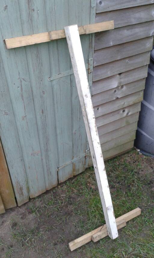

Last time I did a clutch on my Sei I made this to use rope to lift and support the gearbox. Made it a lot easier on my own.
