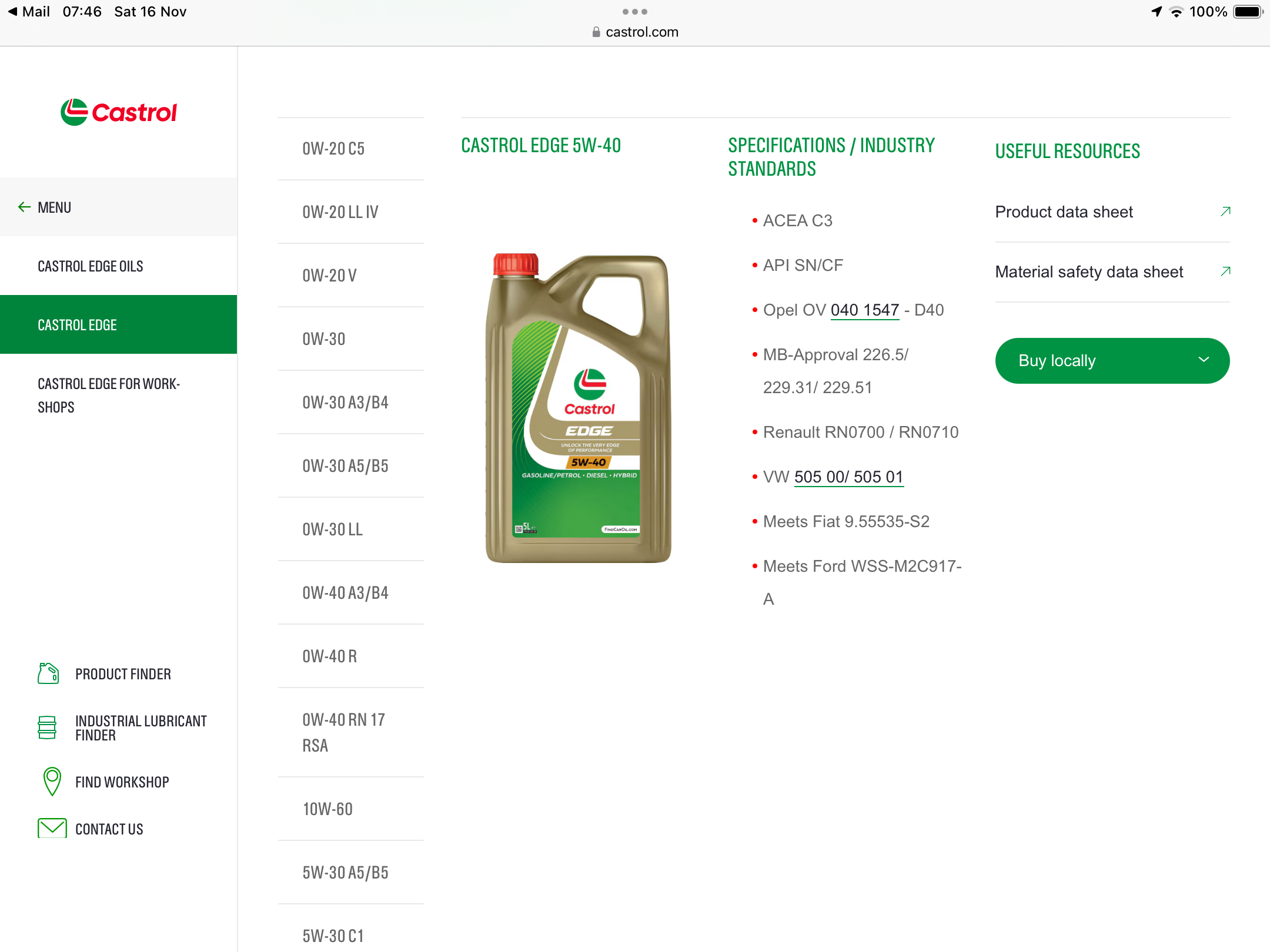

I’m just buying some oil now and I I’ll be getting Castrol Edge 5W-40.
It meets ACEA C3 and Fiat 9.55535-S2 (you quote -S3, but my owners’ manual says -S2).
And it is available here (UK) in a 4 litres bottle so enough for an oil change and some for topping up.
No idea if it’s on sale in NZ but it meets all the specs for my Twinair.

Re the Castrol Edge 5W-40, I have seen that but have been unable to confirm it meets C3 and Fiat 9.5553-S2? The pack I have for another vehicle states ACEA A3/A4, that indicates it doesn't meet C3?

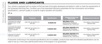

Because in 2016 Fiat changed the oil specs in the handbook. The first page is from a 2014 handbook. The second is from the 2017 handbook.
