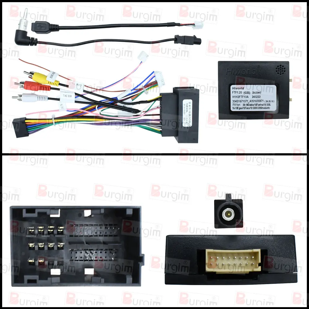

Hi all, we've got ourselves an Android Headunit as replacement for the stock radio to support apple carplay in the fiat 500 year 2010.
Now everything works as expected, canbus is integrated in the android unit as well as I can see on the screen when the doors are open.
But... the mileage in the ODO is flashing.
I tried proxi alignment procedure, that says radio is removed and Entertainment Telematic Node (ETM) is added.
So executed proxi alignment, got a timeout on the ETM (guess because this is atermarket. Now proxi alignment says all is fine though, but mileage is still flashing.
The headunit comes with a canbus box of HiWorld that allows me to set to Fiat Doblo, 500L, etc, but nothing works.
Any ideas how I can get rid of this flashing mileage? Any experience with android aftermarket radio's?
