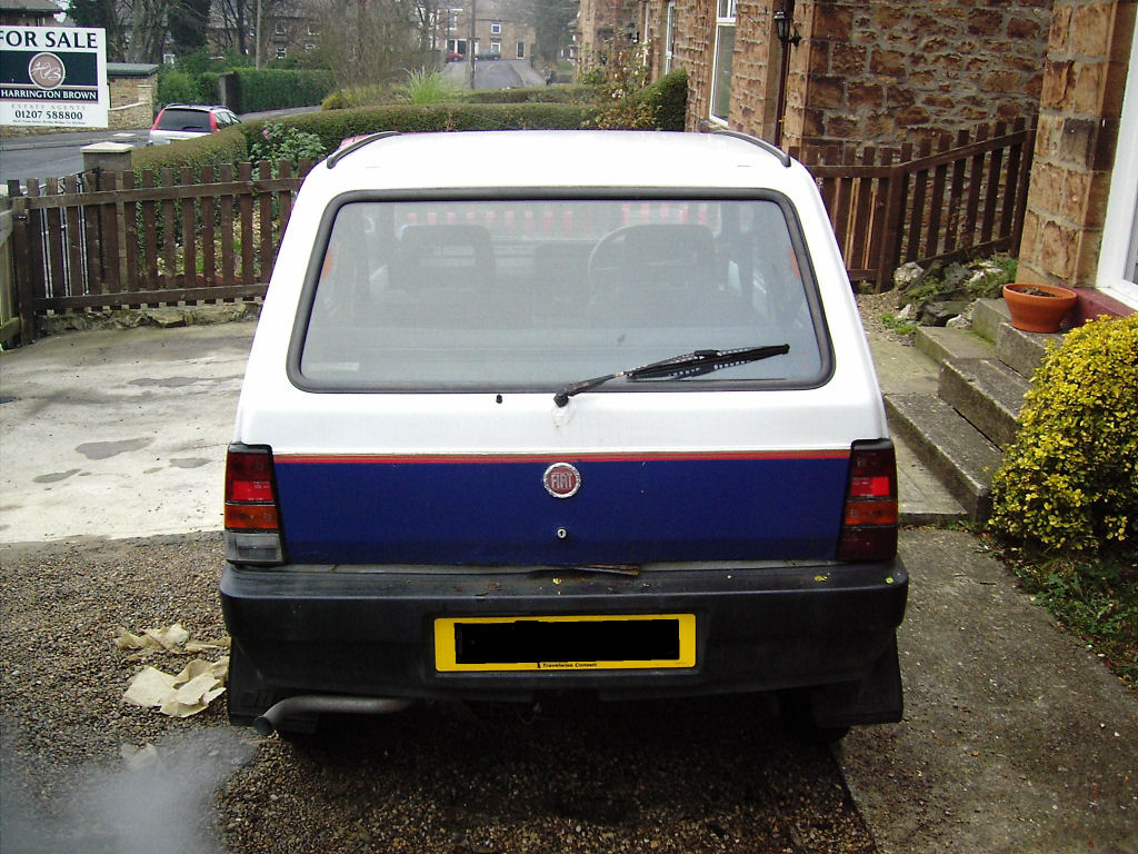

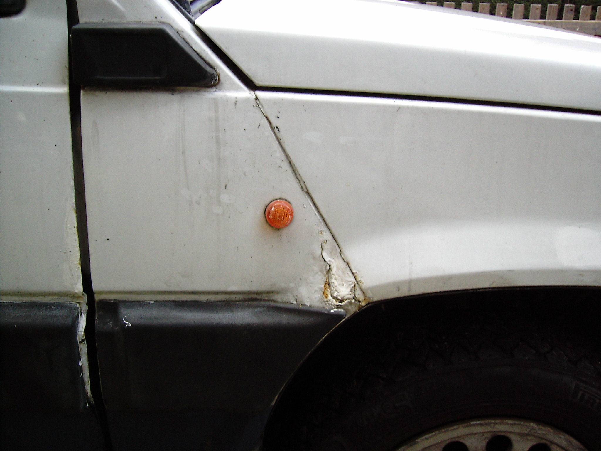

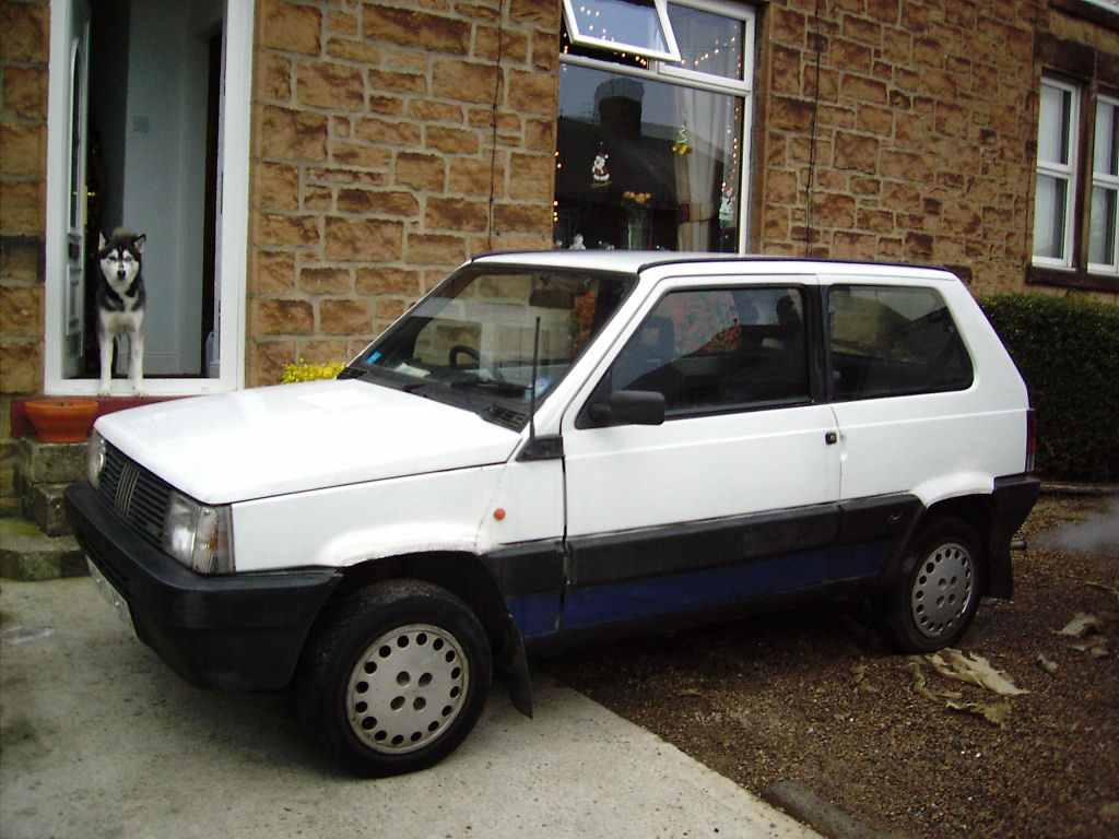

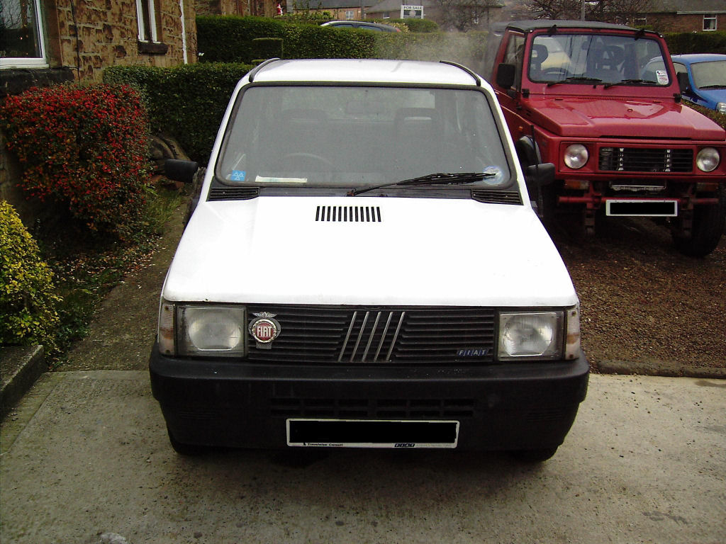

Here are the pics of the car body and a close up of one of the rust spots.

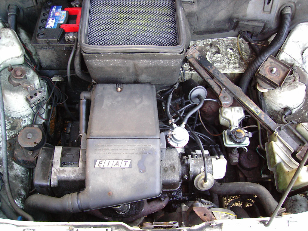

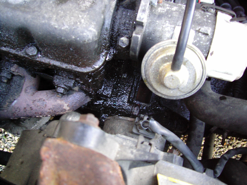

Here is the nice and black engine ;)

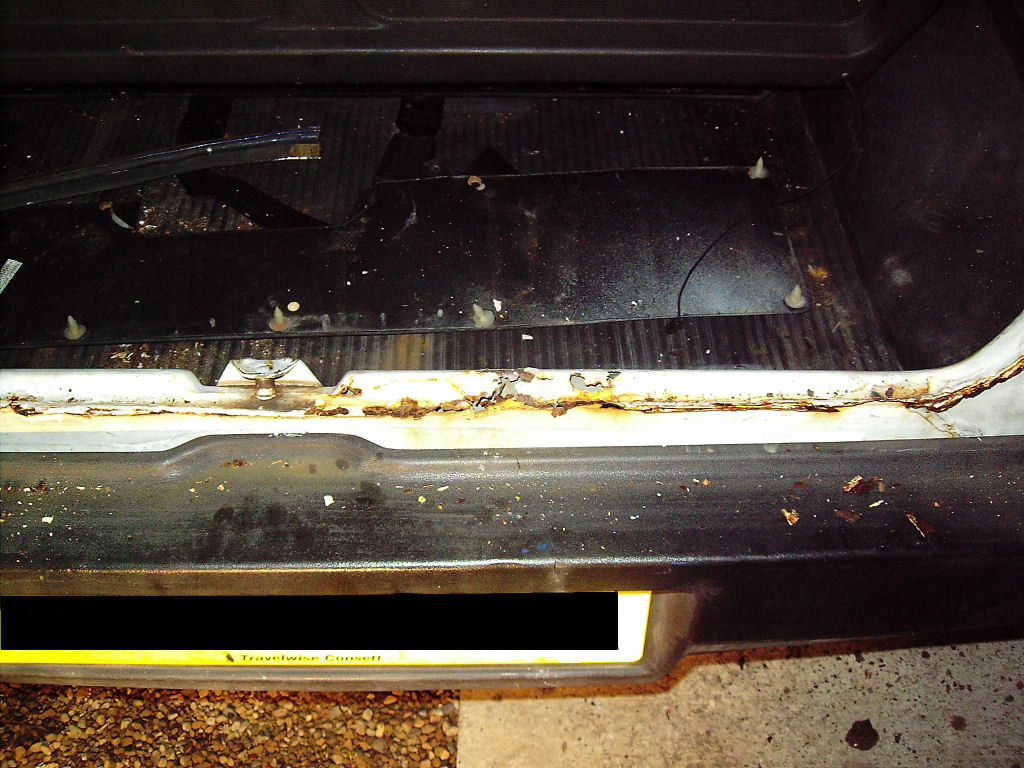

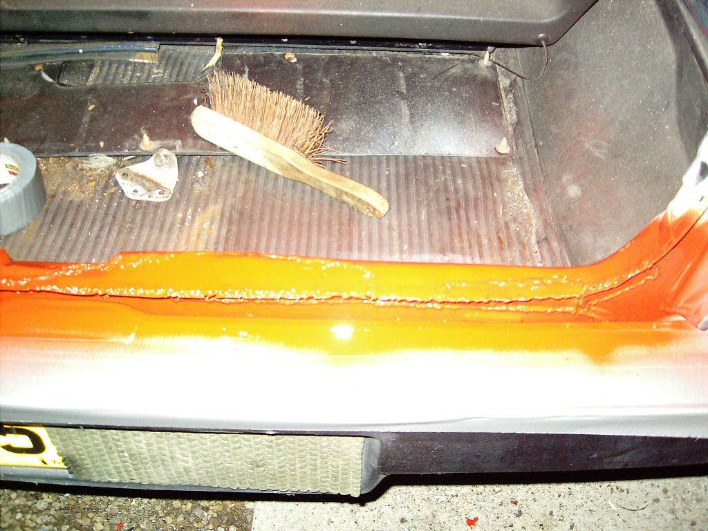

This is the first of my welding jobs. I have included the before and after.
I find there is no point just cutting little holes. Best to cut back to good solid metal then plate away after that. Makes the job a lot easier and last longer.
Tommorow i'll add the filler and you will never tell it's been plated (y)

Cool welding Darren , Que lots of panda owners setting fire to their trousers with MIGs ;) Did you use a mig welder? How easy was it to fabricate the flange where the two pressings come together Im suprised you didnt remove your rear bumper!
There was no need to remove the bumper as the metal was good within 7mm of the lip. The actual fabrication was very tricky ;)
Cut a long section from a flat sheet of metal, bend it to 90 degree in a vice. Hold in place with mole grips, weld the whole bottom section first, then start with the top where it meets the original flange. Then it was just a case of weilding plates into place at the top. (y)
All in all not a tricky job at all.
Next job is cutting out the rot in the front and rear wings / apex.
I'll do a before, during, during and after on that too.
So far my findings are that the bodywork is indeed very thin, however only where you haven't cut enough of the old rot out.
If you cut back to good un tin-rot metal the chance of blowing holes in the area are very slight. So far it's truely a pleasure to attack with an angle grinder and mig welder.
