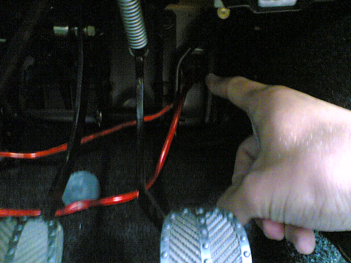

Paul, is this the grommit you mean? should be able to fit 0 gauge wiring through (i think :eek:) its the one behind the pedals, if thats the one you meant my bad :eek:

What a legend :worship:
That's one of them, I can't tell in that pic but in mine there's already some wiring comes through that grommit. Is there on yours? If so then I'm sorted.
There's also another grommit a bit futher down to the left on mine, with no cable.

In my pic theres only the two wires i fed through there, wasnt any there previously :eek:
