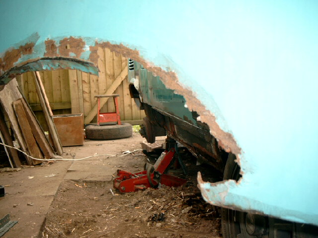

hi, the pictures "was rusty" on the msn forum was me! didn't use jag sills, they were hand made using a flat piece of steel and a scaffold bar. I also made the rear quarter panel, as this was entirely (quite cleverly) made of fibreglass... this was my first attempt at making panels, and with a bit of perseverence and lots of man hours it can be done....not the best restoration in the world, but managed to get it through an mot..I used a cardboard template of the old rear quarter, then reversed it and cut it out of steel.

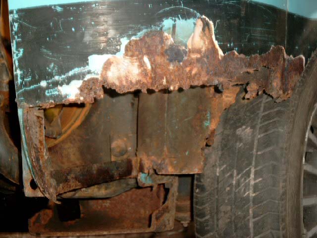

no probs, nice to get a bit of recognition...I met a bloke through the amigo friends club who made really damn good replacement panels, but is sadly he is retired/retiring....I made three different rear corners for mine before welding the final one in, and the drivers sill is made from an old locker (wont rust again) both items are at best described as rubbish, but lots better than the inch-thick-in-places fibreglass that was in its place. I'll try and post some pictures of the worst bits, according to some people i've talked to about the 900e's it's the worst they've ever seen...
found some of the pics. It was a 'little' bit heartbreaking to keep finding more fibreglass, most of these pics were taken after I'd removed the chunk of fibre resin that was disguised as bodywork...

I remember the first time I looked at those pictures was just after I'd started to find bucket loads of bodge in my own 900E. I'd fired up the welder to patch a very small hole in the rear arch and was more and more horrified as I found more and more hairy bodge...
I remember saying to my wife "Look here, we aren't the only ones with a rotten camper..." whilst pointing at those pics. I though the drivers side on mine was the "best" side but after finishing off the passenger side and starting it - it looks like it wasn't. Saying that - at least I havn't had to do any repairs to the ROOF!!
