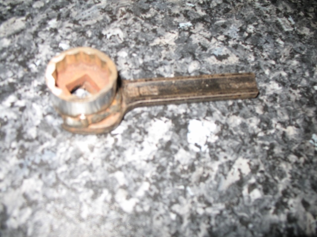

I made this tool to help fitment of the alternator belt quite straight forward.
Its a cut 24mm socket welded to an old open end spanner, Fit the belt on the aircon pulley first, then fit this tool onto the alternator pulley nut and loop belt over the spanner and turn the belt over the pulley. Its tight, but you can turn 360 degs for belt to be fully on, should take no more than 2 mins. Thats of course after you have removed the wheel, wing liner and aux belt !! Made this in 2007 , only used once still own this great car :)
