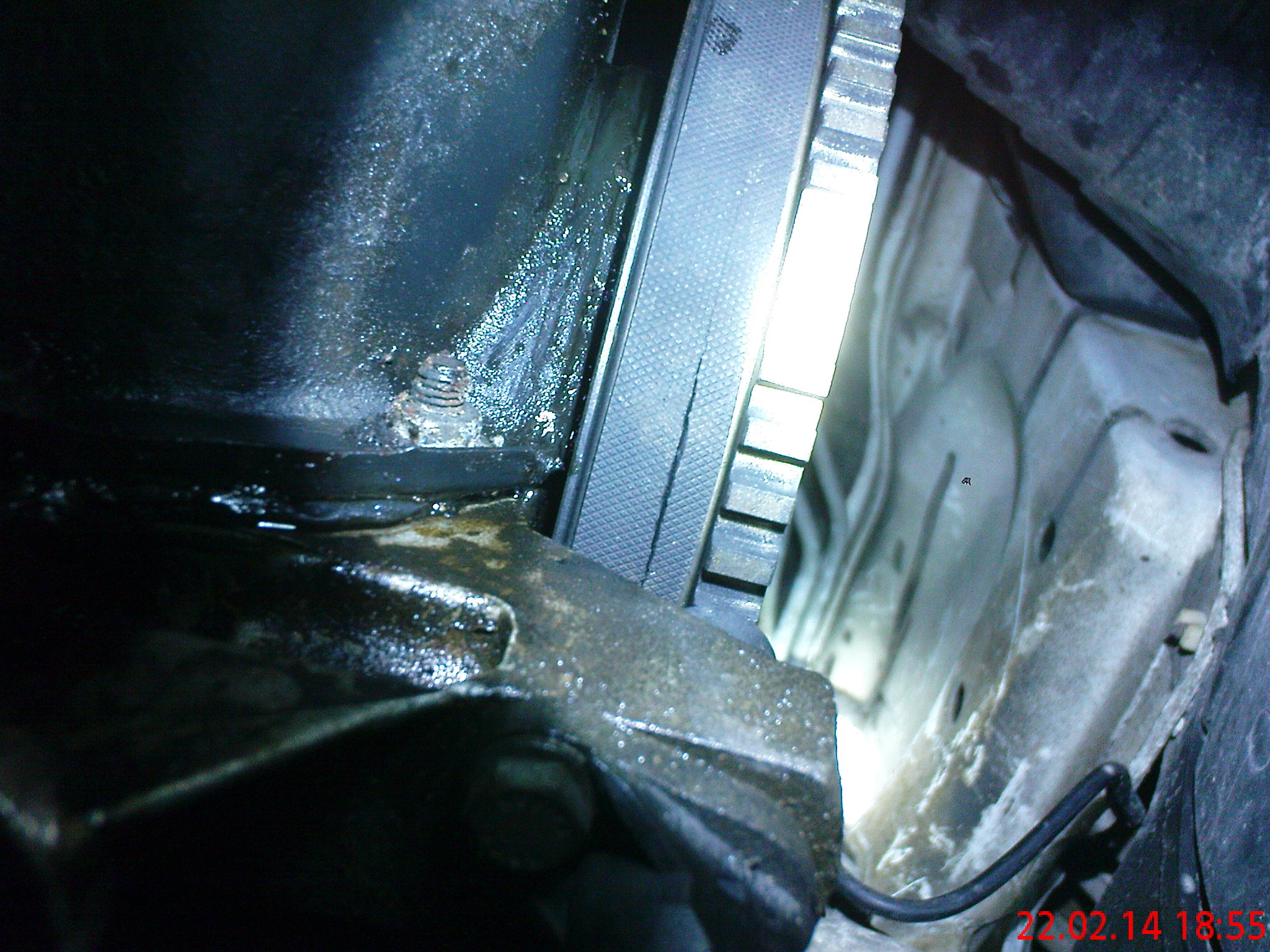

F flisko ` Parked in the garage Written 5 guides Joined Jan 20, 2013 Messages 6,122 Points 1,228 Feb 22, 2014 #5 random discovery while tightening oil sump bolts, alternator belt cracked Attachments DSC03234.JPG 762.4 KB · Views: 302
