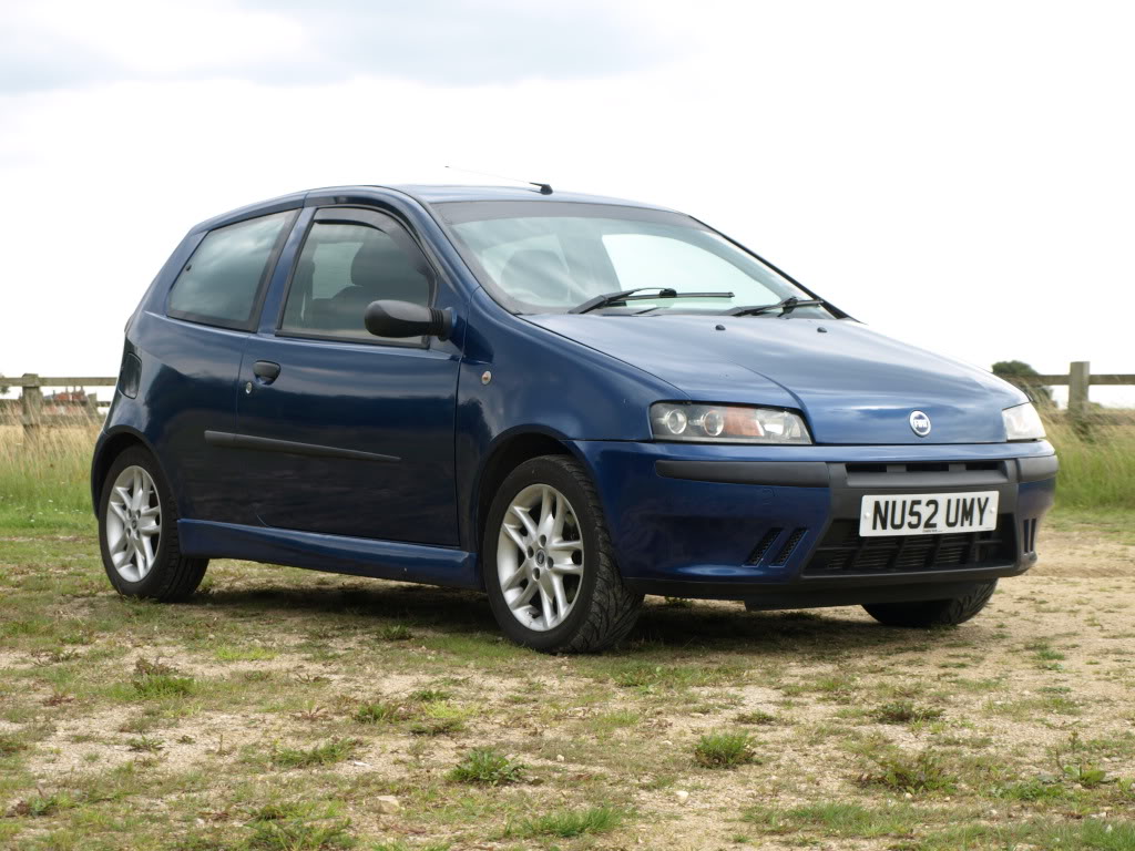

Hi, the ones from the Punto Sporting will fit. My 100HP had a set as winter wheels. Not sure if I can upload a pic but it's the 5 spoke style from the mk2 Punto Sporting.
These ones.

Thanks. Ill have a look. Do you know what tyre size they are?
Nice car the Sporting by the way. (y)
Im sorry i dont remember now. I'm sure someone else will pop up who knows. I know they were something something something 15s. I think they are the same size (or can take the same size) as the 100HP alloys.
