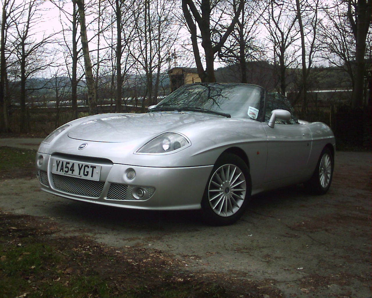

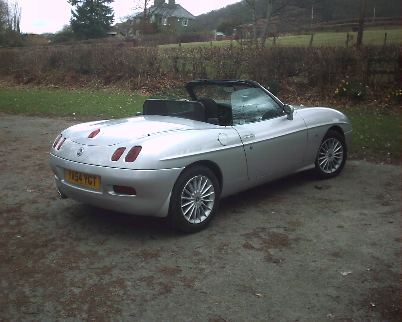

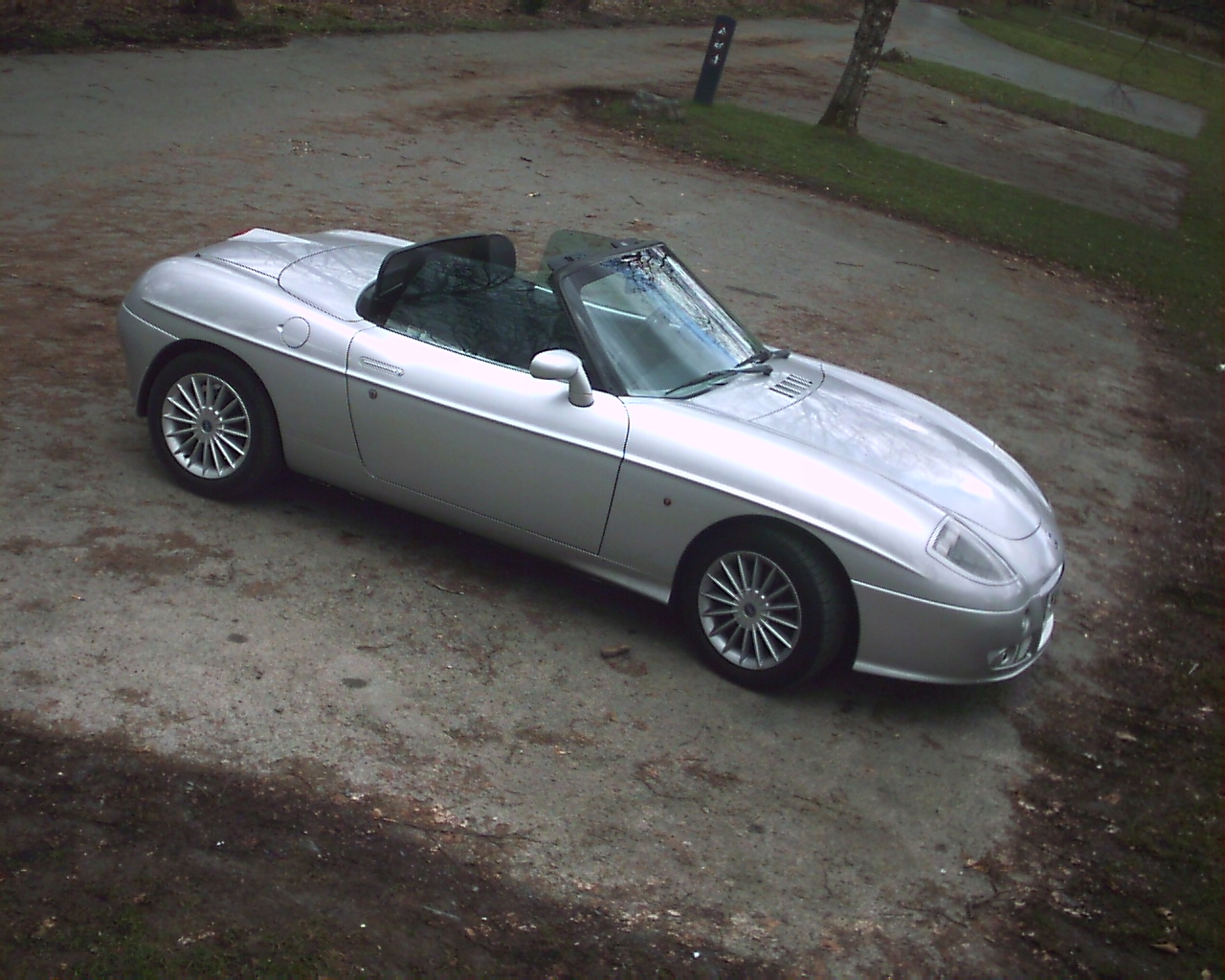

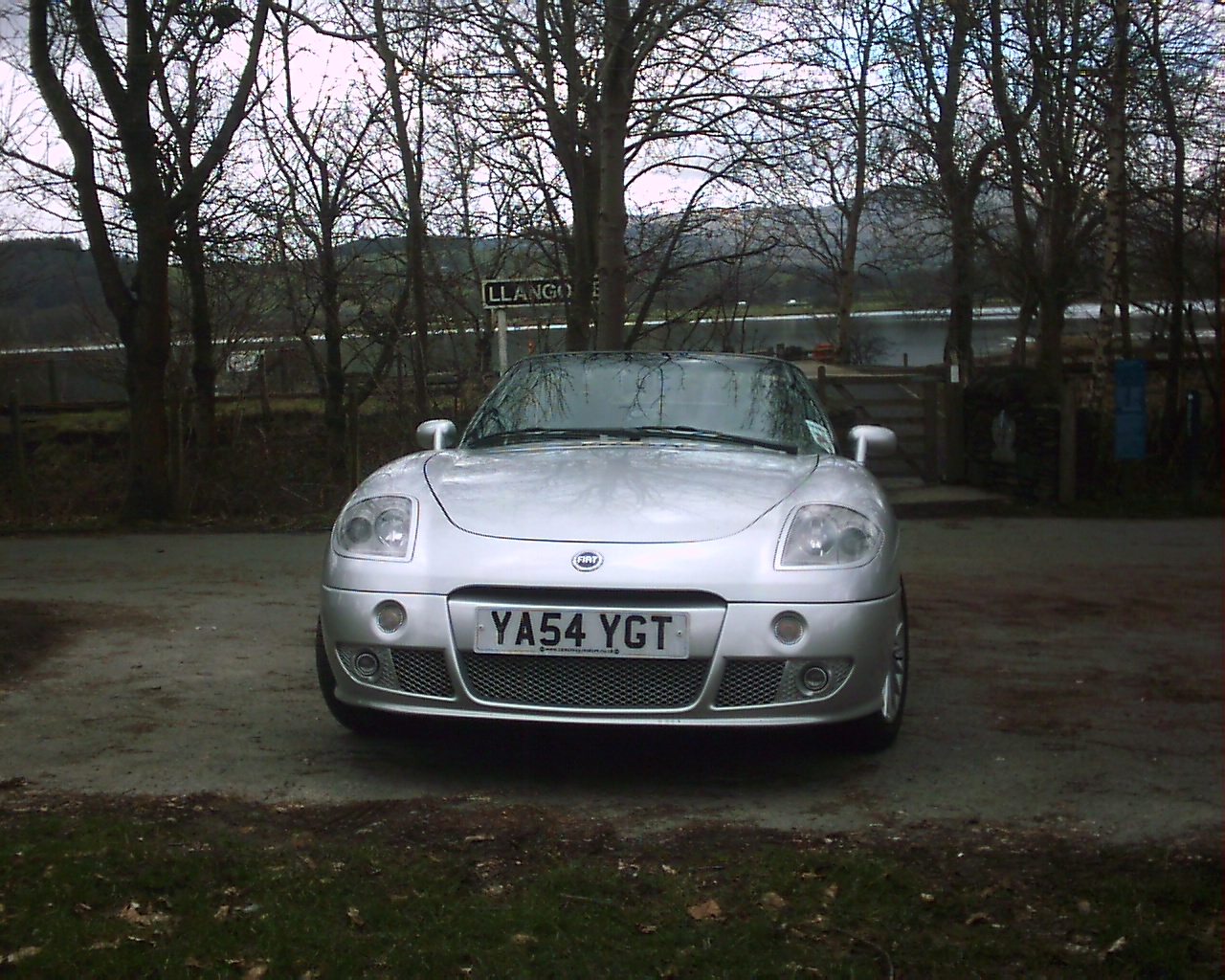

Hi, Went over a transverse ridge on motorway, bit of a jolt , and the airbag warning light on dash came on and refused to go off. Handbook says something has triggered, or a fault in system. Been to Fiat dealer but they can't do it til after bank hol. Anyone come accros this problem before, and any ideas? Finally, here are some pics of my "B"

Love the b, especially the silver grills.

The car is as I bought it so don't know about mods. In fact I didn't realise it had different headlights. Doh! I've only ever seen older cars in the flesh as there are so few around. The car has been lowered, the springs are red so I guess they are Eibach, but apart from that it seems pretty standard.

The more I look at it the more different it looks. The whole front has been silvered hasn't it? That looks like a different bit that the number plate is attached to and the grills have been sprayed. It would be interesting to have a good look and see what else the previous owners have done.
