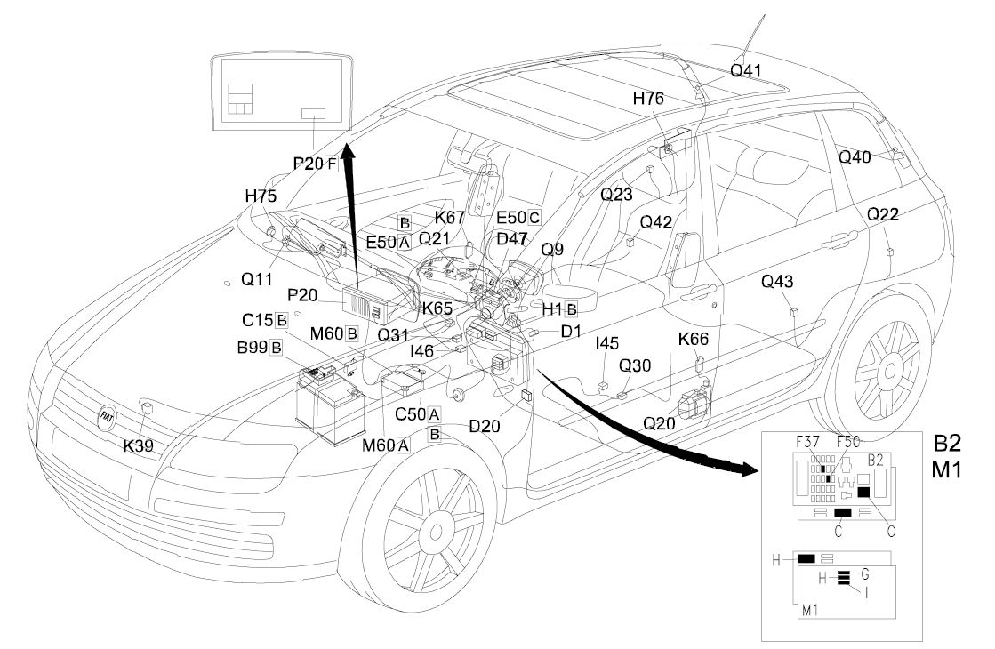

The connector for the rear seat side airbags are shown as yellow in eLEARN. They are Q42 and Q43 on this diagram. You may need to check both sides, there's often confusion with daignostic programs when referring to driver's side and passenger's side with LHD and RHD cars.

The connector for the rear seat side airbags are shown as yellow in eLEARN. They are Q42 and Q43 on this diagram..
Do you know how I'd get access to those connectors?
eLEARN is never very clear on component locations. On my MW with rear seat airbags, I've seen yellow connectors near the floor at the outer corners of the 2 outer rear seats, however eLEARN says there are connectors inside the seats that connect directly to the airbags. I'd check for them around the floor first.

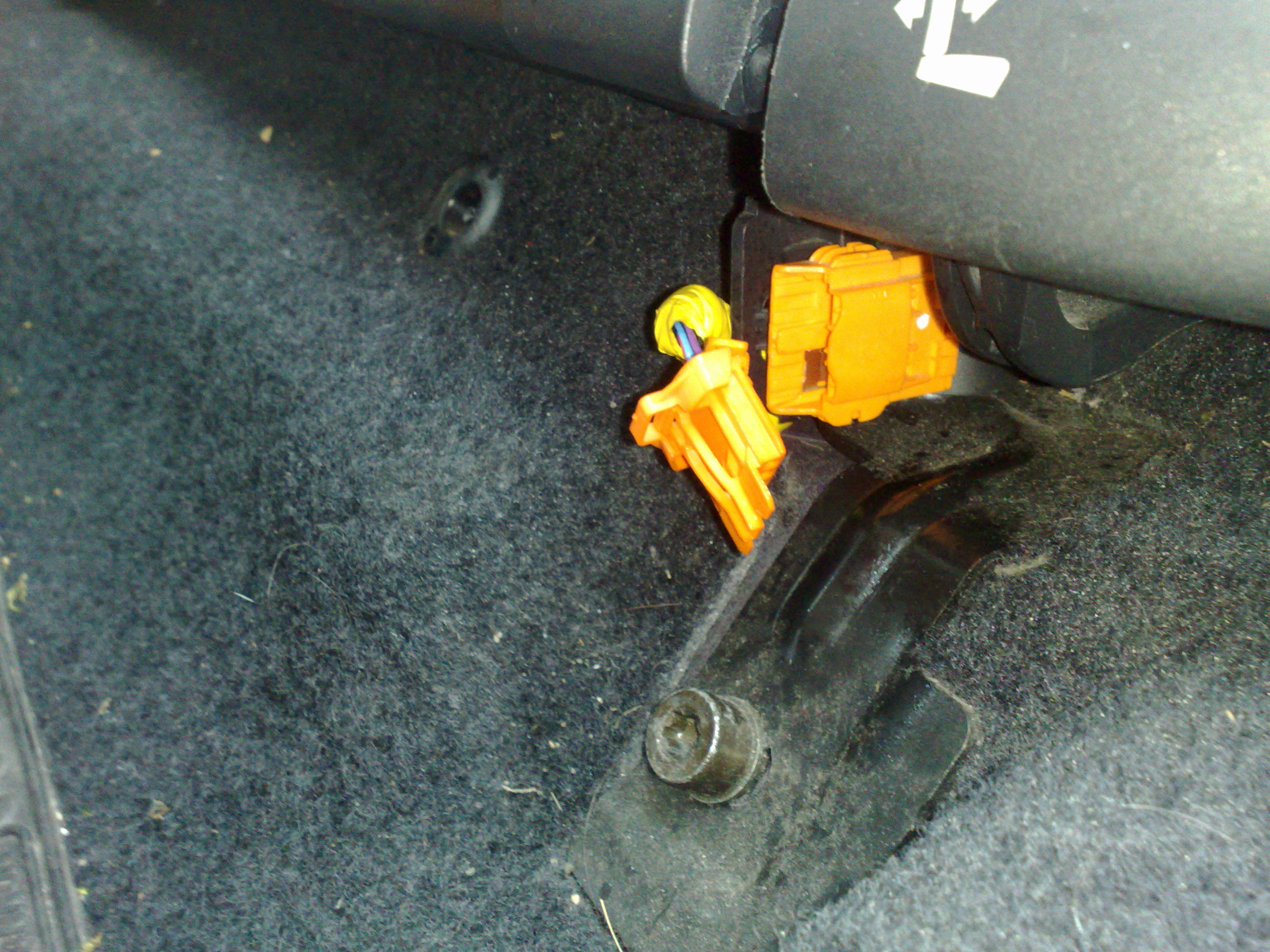

Then it's probably this connector below the levers for adjusting the rear seats (see the first attachment).
I managed to disconnect the connectors and clean the male connector, but I was not able to access the female connector (see the second attachment), does anyone know how to handle it?
