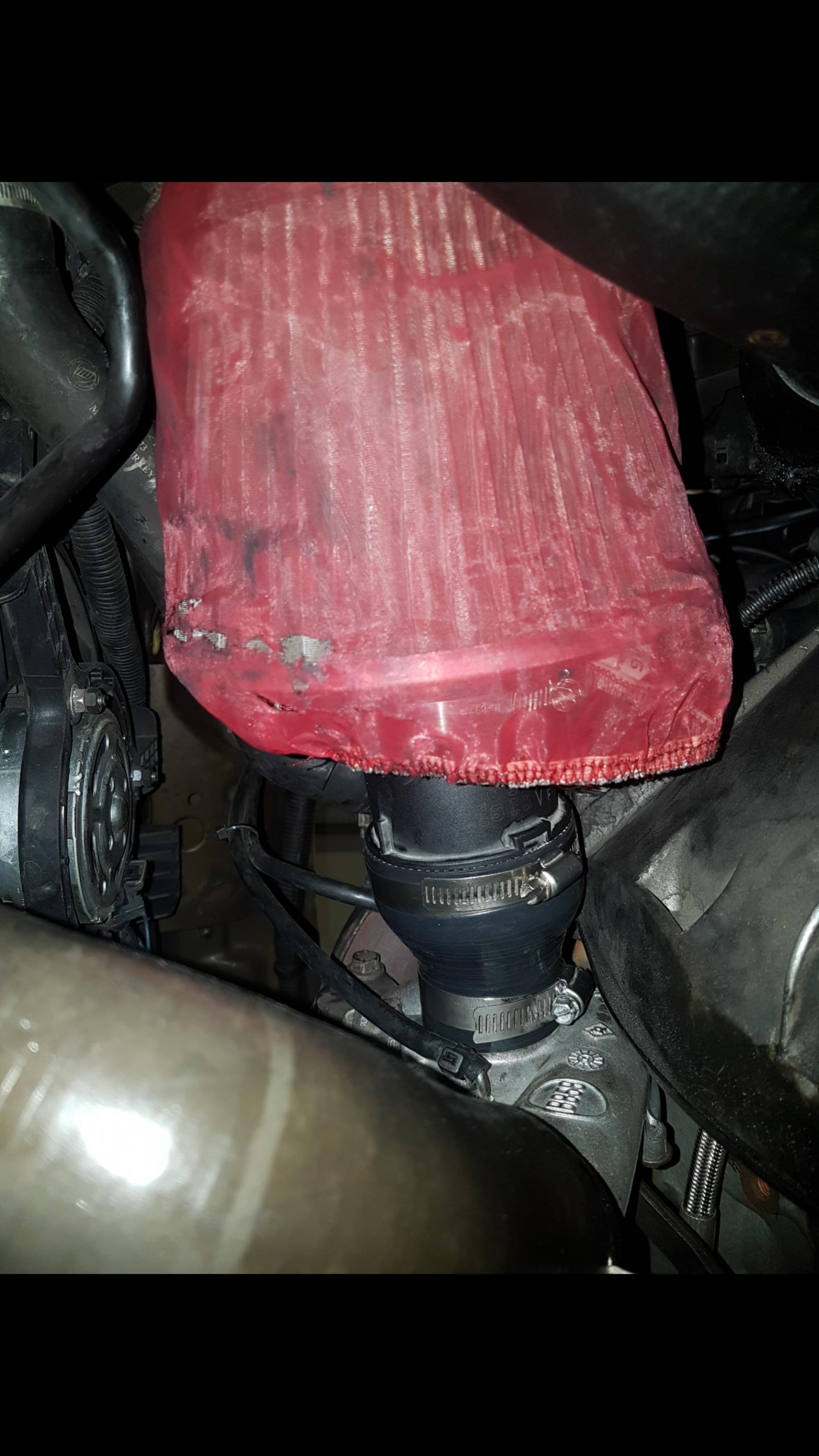

I had this exact issue too. My turbo inlet hose was clogged after 10 years due to the pcv system. Air filter was also due. The oily residue also harden and cracked my turbo inlet hose and a replacement was about $100 so i just took a 2.75 inch to 1.75 inch silicone reducer to connect the turbo inlet to the maf sensor then just stuck an open pod on it. The entire intake is now just under 8 inches. Added benefits of loud turbo induction noise and significantly less black smoke under hard acceleration. Turbo spools a lot quicker and holds the boost better up top. You would need to plumb up the pcv system elsewhere though. It is quite a gain for a $5 mod if you have an open pod laying around.
