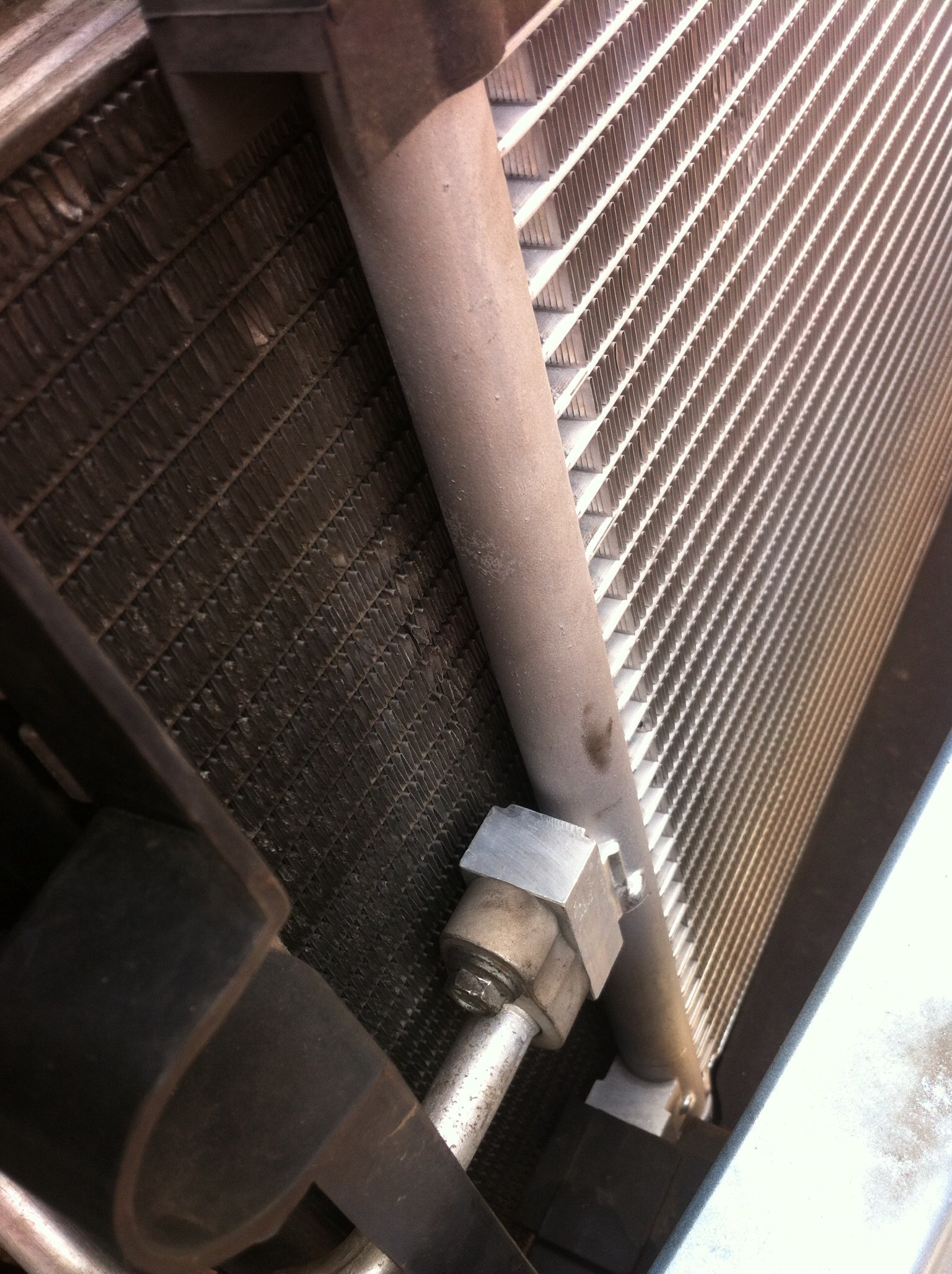

Just looking at this thread as my aircon leaks like a sieve.
Had everything off and the condenser looks like someone has hit it with a lump hammer :eek:
Not only is the condenser bent in to the rad but there's also a dent in it.
