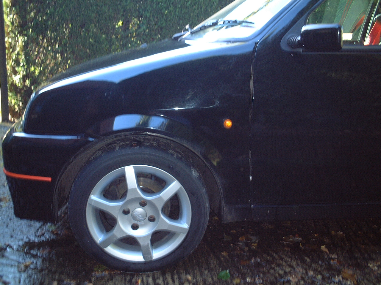

right just finished cleaning the ripper
it all went together a peace of **** just hope it drops abit more, may go take it for a good thrashing now the roads are dryish.

Donkey said:
right i have just inspected the bumperstops and yes we are sitting on them well and trully, how much should o cut off them?? and wots the easiest way to do this?? is it likly to be on the front ones aswell??
if u have some sharp siccors then u can just cut through them....
there should b a little line directly in the middle of them, where the stop goes narrow. just cut there and take half of it off.
and the front will b the same. if u have small hands an small sissors then u can just whip the wheel off an do it, if not then u will have to take the whole shock off!
by the way u really really dont want to drive it while it is sittin on the stopps, gets quite interestin so i have heard!
