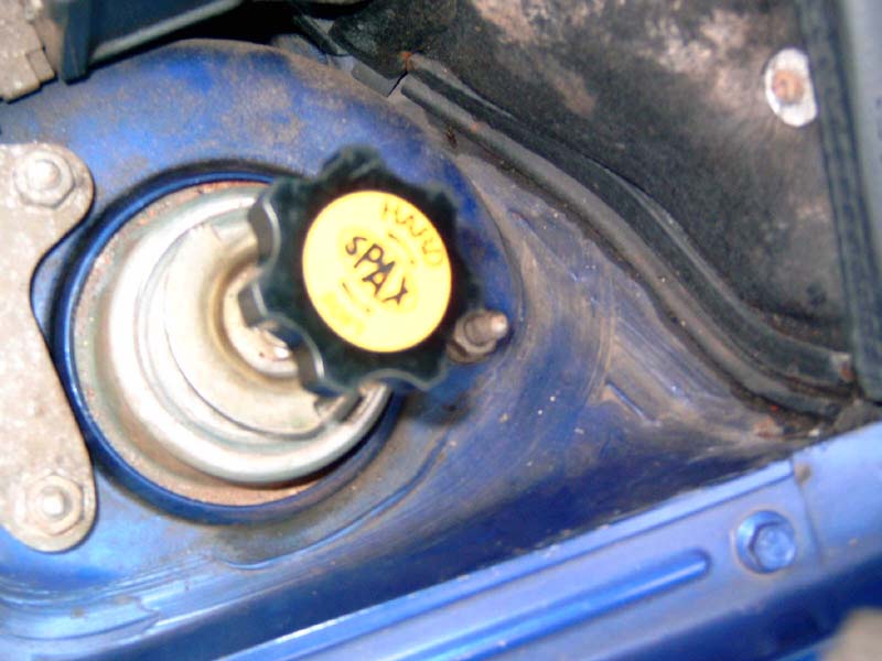

the ride is harsh, and it does bounce the wheels off the road at times. its full at the back too. i was going to source a new key and then play with the handling - but ive not found one yet.
can u take some pics of the key so i can get summit made up? ta

Arc, harsh surely can't be the word, here is a pic of the key for the front, although the rear is supposedly off car adjustment a stuby plain screwdriver will turn it back for you and maybe even a very small spanner around 6 or 7mm could adjust the front for you.
