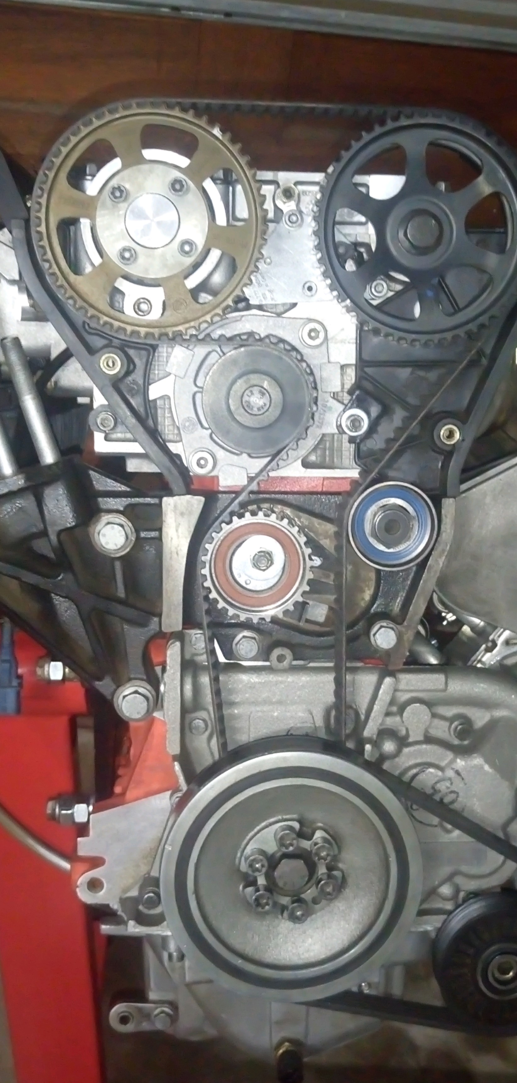

Hi
From what I can see from my photos I took while doing the rebuild.
You should be able to change the waterpump without to remove any cam pulleys.
Only thing to do is to remove cam guard screw that turn into Waterpump, turn pump about 5 degrees clockwise and remove.
I would suggest changing static pulley and the tentioner also.
Good idea to change the aircon belt, alternator belt and tentioner also.
PS! Note o-ring groove, go to the garage and get a new one ?

Smashing photo :) if only my engine was out on a stand, it would be so much easier :cool: As you know, space around there is about as tight as you can get :eek:.
Anyway, I'm now encouraged enough to try to get the pump off in situ, and if it doesn't, then off with the drive sprockets.
