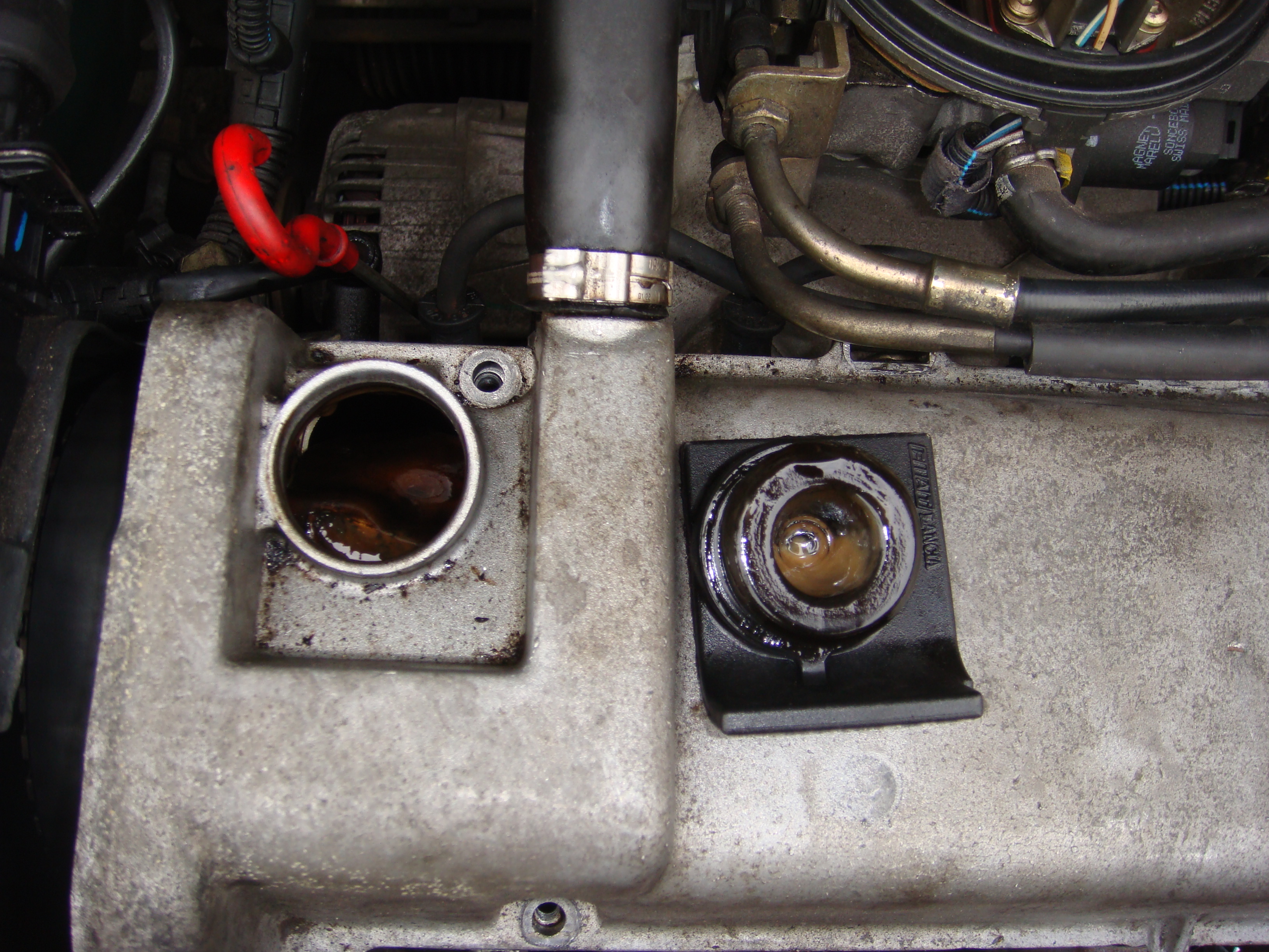

Dunno whether this helps at all with diagnosis, but the dipstick looks good - the oil is still slightly golden-ish (less than half a year old) with no mayo-like substance around. However, the oil filler cap has smth going on. Attaching pics for clarity, as I'm kinda unsure whether it qualifies as "mayo-like" or not. I'm also attaching a pic of the camshaft housing, to the extent that may help narrow things down at all.

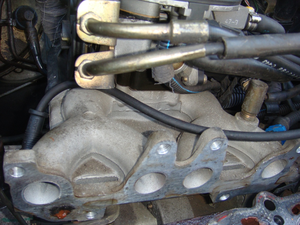

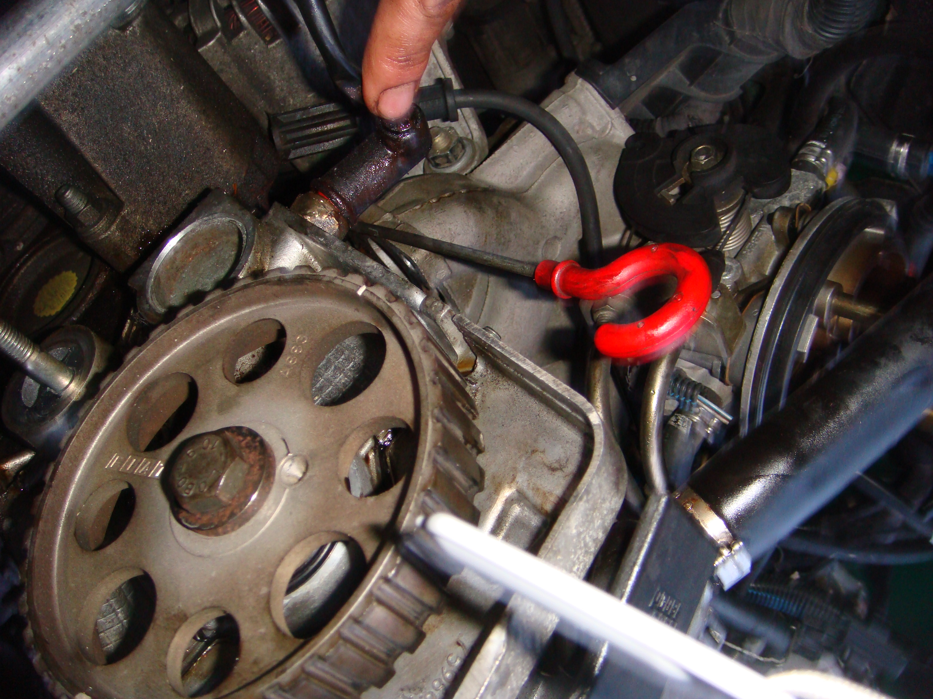

And in the meantime, how on earth do I get the plug I'm pointing to in the picture out, given that my spanner just starts to strip the soft metal?.. :bang:
/oboojoe
The overheating was most likely caused by something else (As you said earlier, possibly the coolant temp/fan sensor.) which then caused the gasket to blow. If the gasket blew then the car overheated you may get mayonnaise. If the gasket blows and the car don't run, no mayo.
Remove that right-angle black rubber boot, there should be a spade connector under it to remove. Looks like a one-wire oil pressure sender to me.

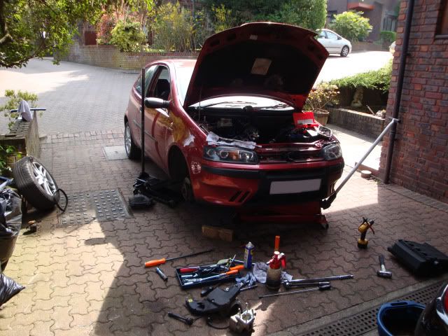

First of all, jacking was less problematic than expected, once I realized (duh!) that it's not required over time. Instead of jacking and stacking boards of wood for safety underneath relevant points and leaving until all done, much easier - of course - to jack (with boards for safety), remove front righthand wheel to access auxiliary drivebelts and cambelt, do the bare minimum of whatever needs wheelarch access, then reattach the tyre and lower the car back down. No reason to leave the poor thing jacked up while putting lotsa pressure on various bolts and what-not inside engine. This is probably totally given for those with experience, but constituted quite the "aha!" experience for meself. In any case, I got proper 2-ton fixed-base axle stands, so they'll come in handy whenever I next need to jack, i.e. reassembly-time.
On a related note, the Haynes manual says to jack the front with a trolley jack under the gear differential. Is it perhaps to be preferred to jack under the front sill arrow on one side, insert axle stand, then move to other side? I'm just concerned whether jacking via the differential is the strongest/safest option.
As long as nothing moves or falls out, it's all good. I leave the car supported with the wheel off and the engine supported while working because it's easier for me. Realistically, don't make no difference. I have the slight advantage of having 2 jacks and 8 axle stands though..
For yourself, whatever works good for you and supports the right parts at the right times. :)
Haynes is wrong; you don't jack a car up via the gearbox. Diff on a live axle, yes. Diff on an independant rear suspension, sometimes. On a transverse layout like this, no. It's a good way of rapidly separating engine/gearbox and car..
As you said, jack up one side at a time and support it with an axle stand. You can jack up the front in one go via the subframe, but if you don't need to, don't. One side at a time is fine.

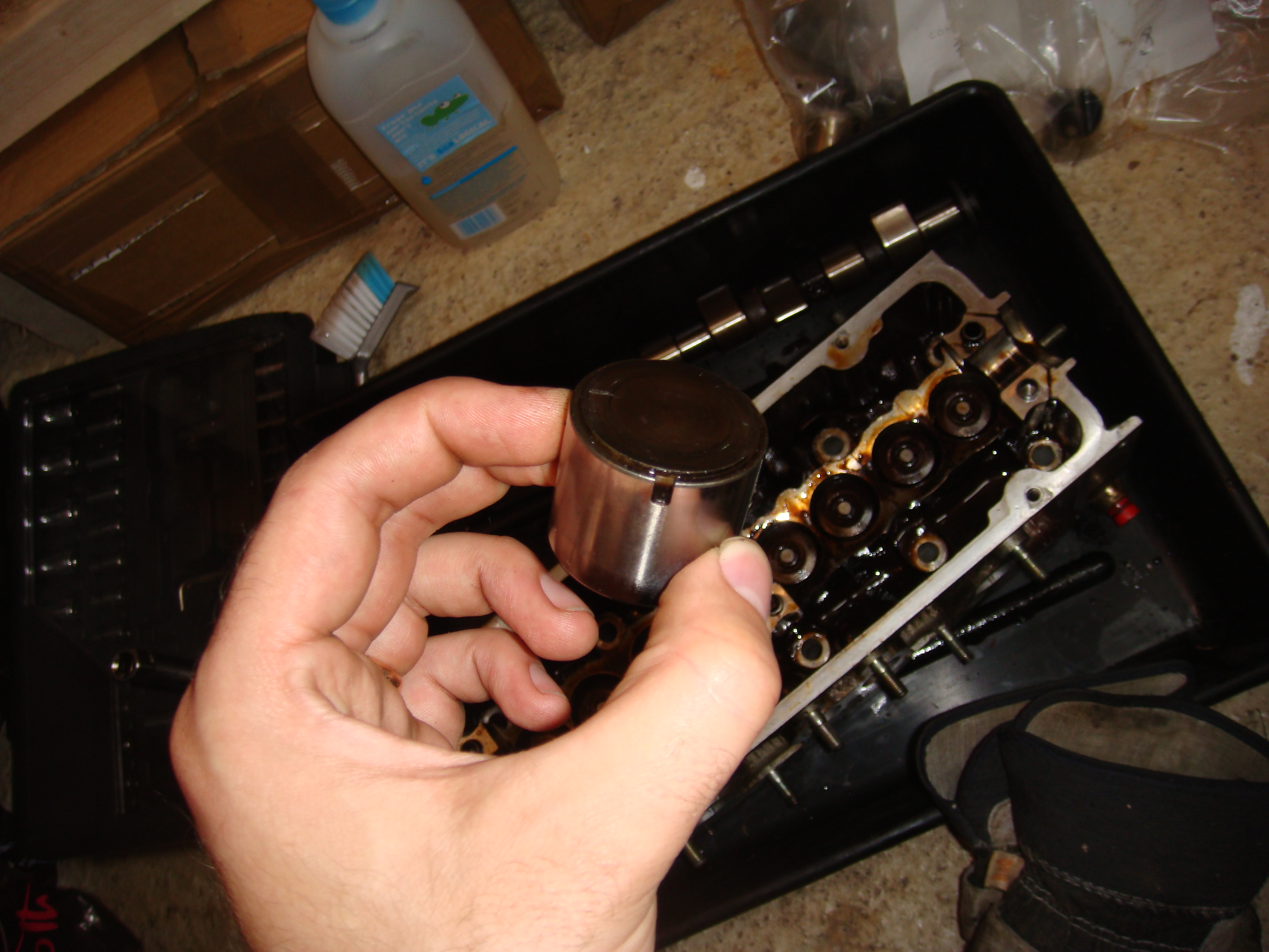

So the stage I'm at now is I've got the camshaft sprocket and camshaft removed. Now, the Haynes manual states that I should remove the shims and cam followers, but not whether to take them off as one piece (see pic) or one at a time. Does this make any difference? If so, what's the easiest way of removing the shims without the special fiat c-spanner bit for pushing the cam followers down?
Don't worry about splitting the tappets and shims. Just use a permanent marker to show which one corresponds to which valve/cylinder so they go back in the place they came from. With the cam out you don't need a tappet depressor (C-shape thing) to remove the shim.

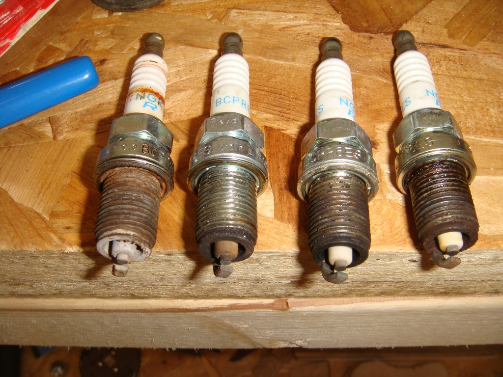

Just thought to check the spark plug condition, seeing as they're out anyhow. Nos. 1 and 2 have the normal greyish-brown deposits. But nos. 3 and 4 are practically glazed with no deposits at all. Could this (overheating, right?) be caused simply by the timing belt being off by one tooth, or is that insufficient explanation wise. They were changed quite recently (Oct 2009), to whatever extent that may influence things.
Also, while on the topic, is spark plug condition a reliable indicator of valve condition? If (two of) the spark plugs look perfectly normal (and the others are just overheating), does that mean everything's a-ok with the valve guidess otherwise, or do they still need checking, i.e. wear, cracks, pits, movement, etc.?

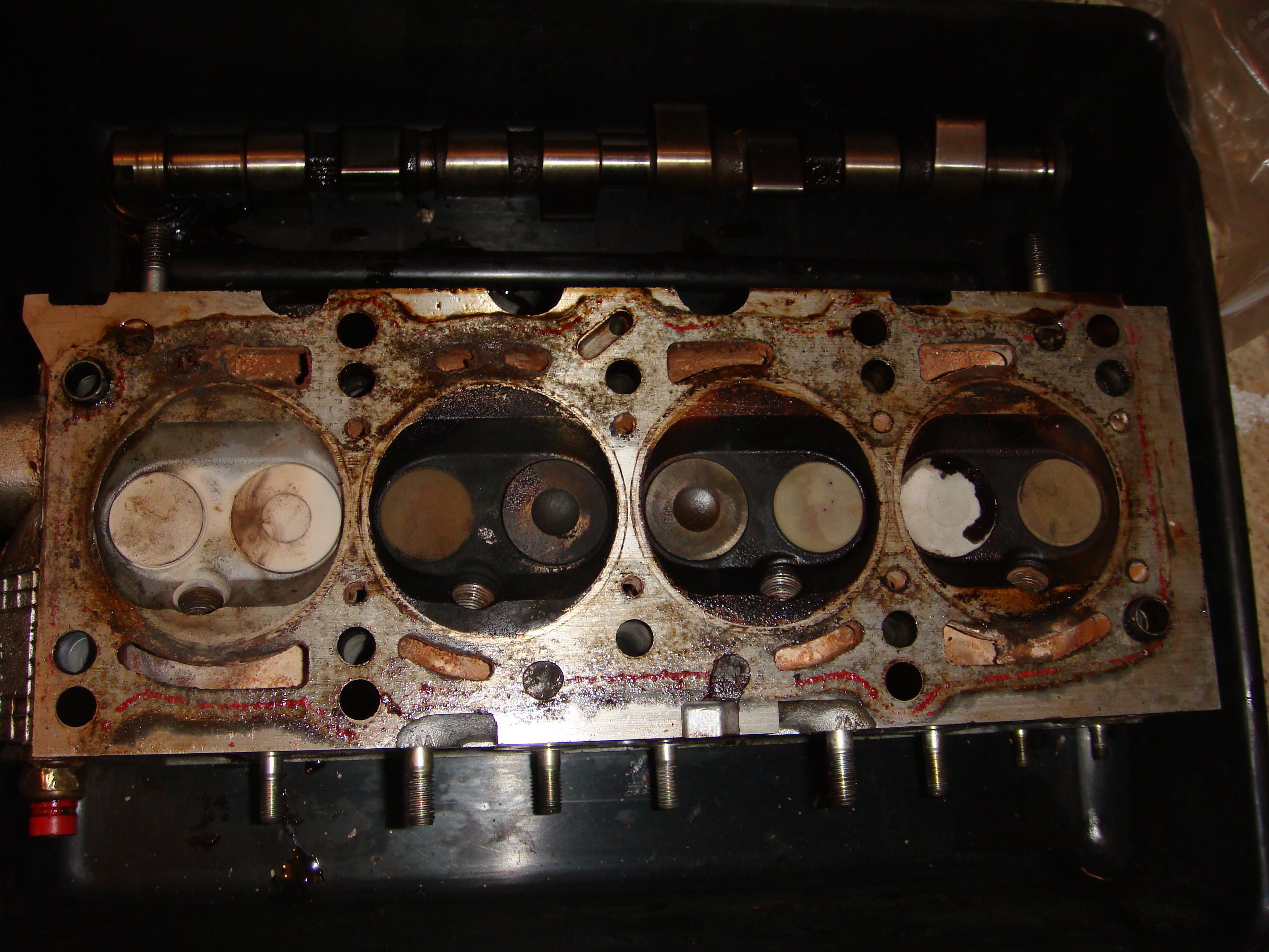

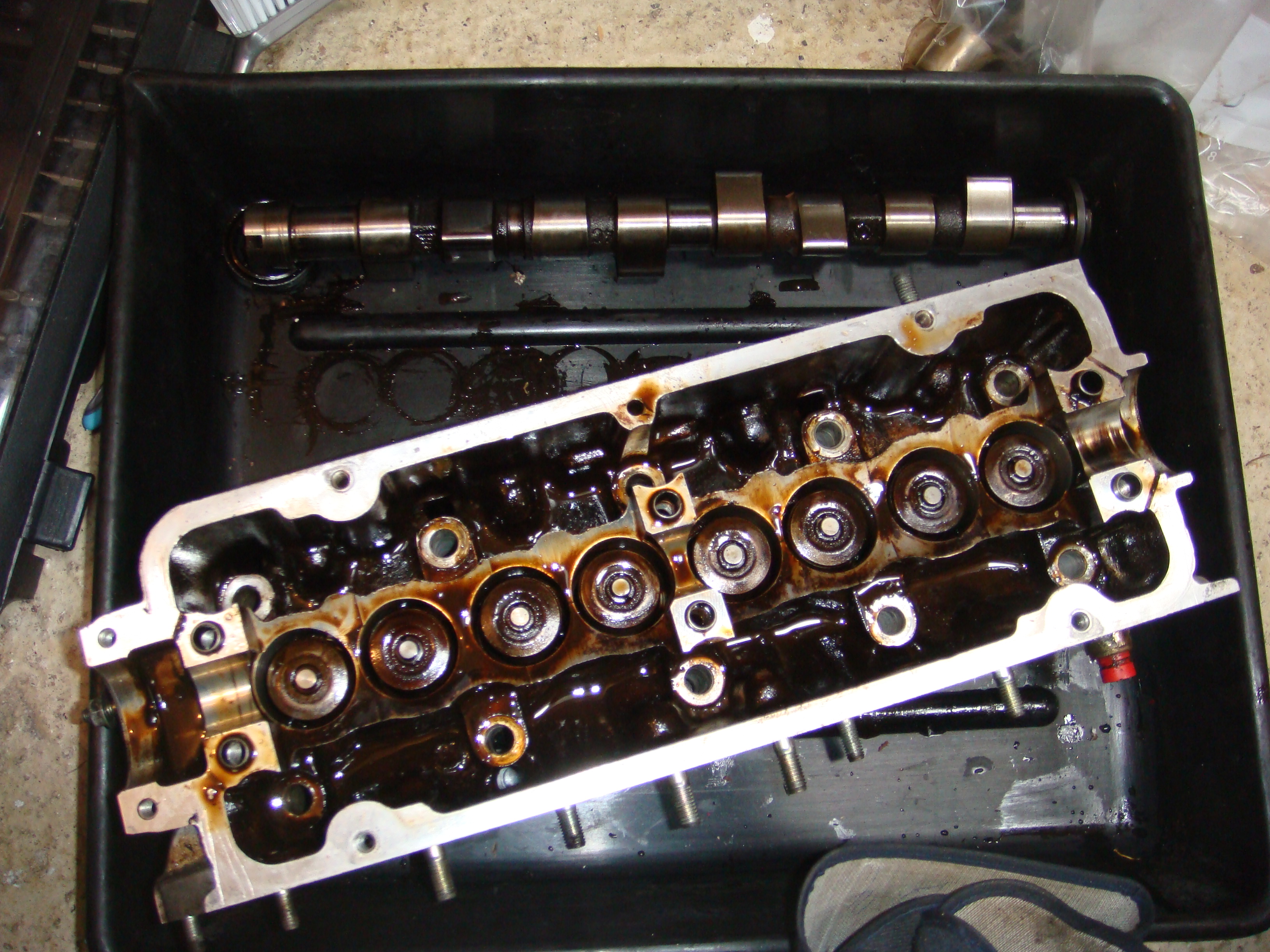

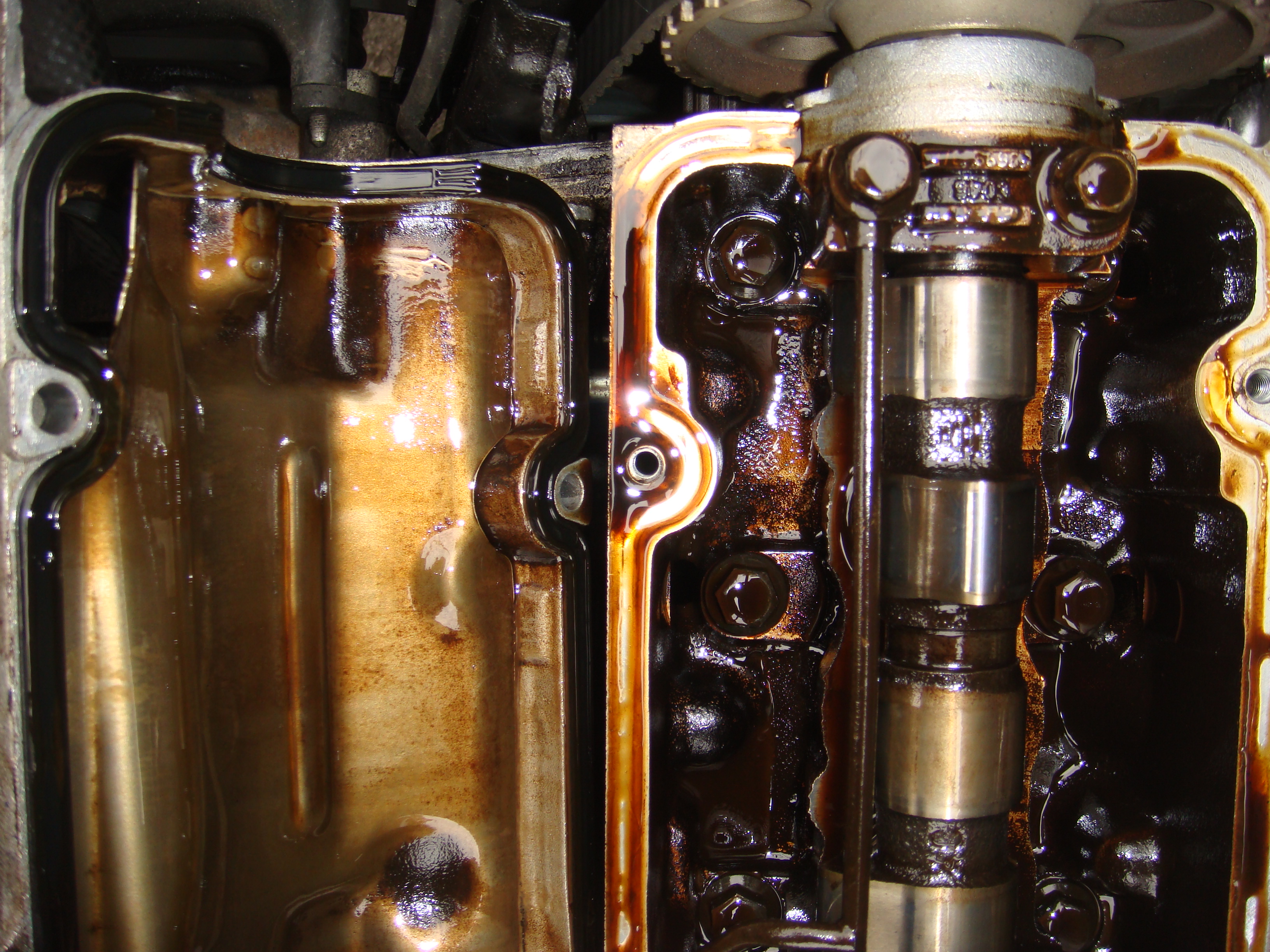

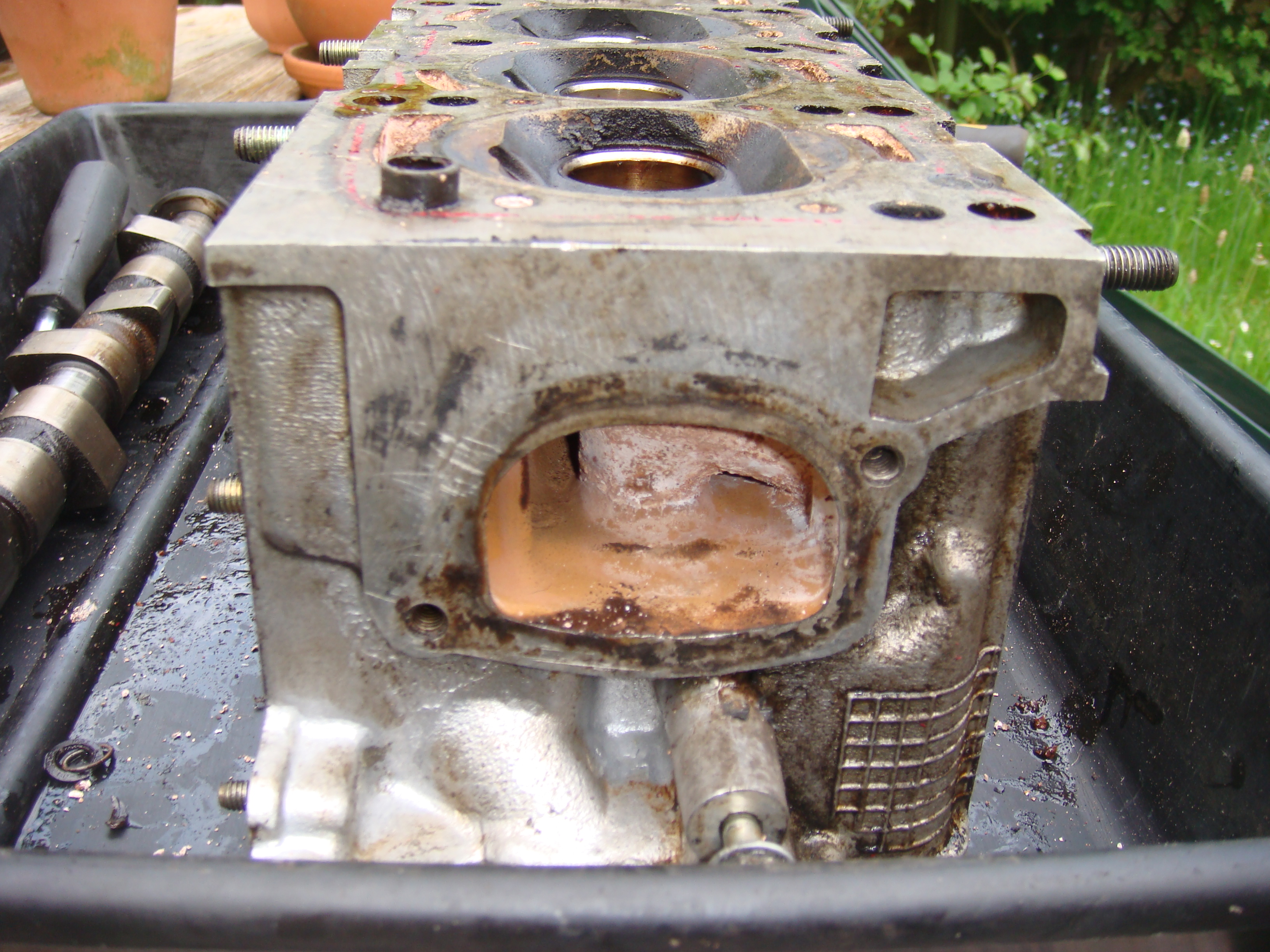

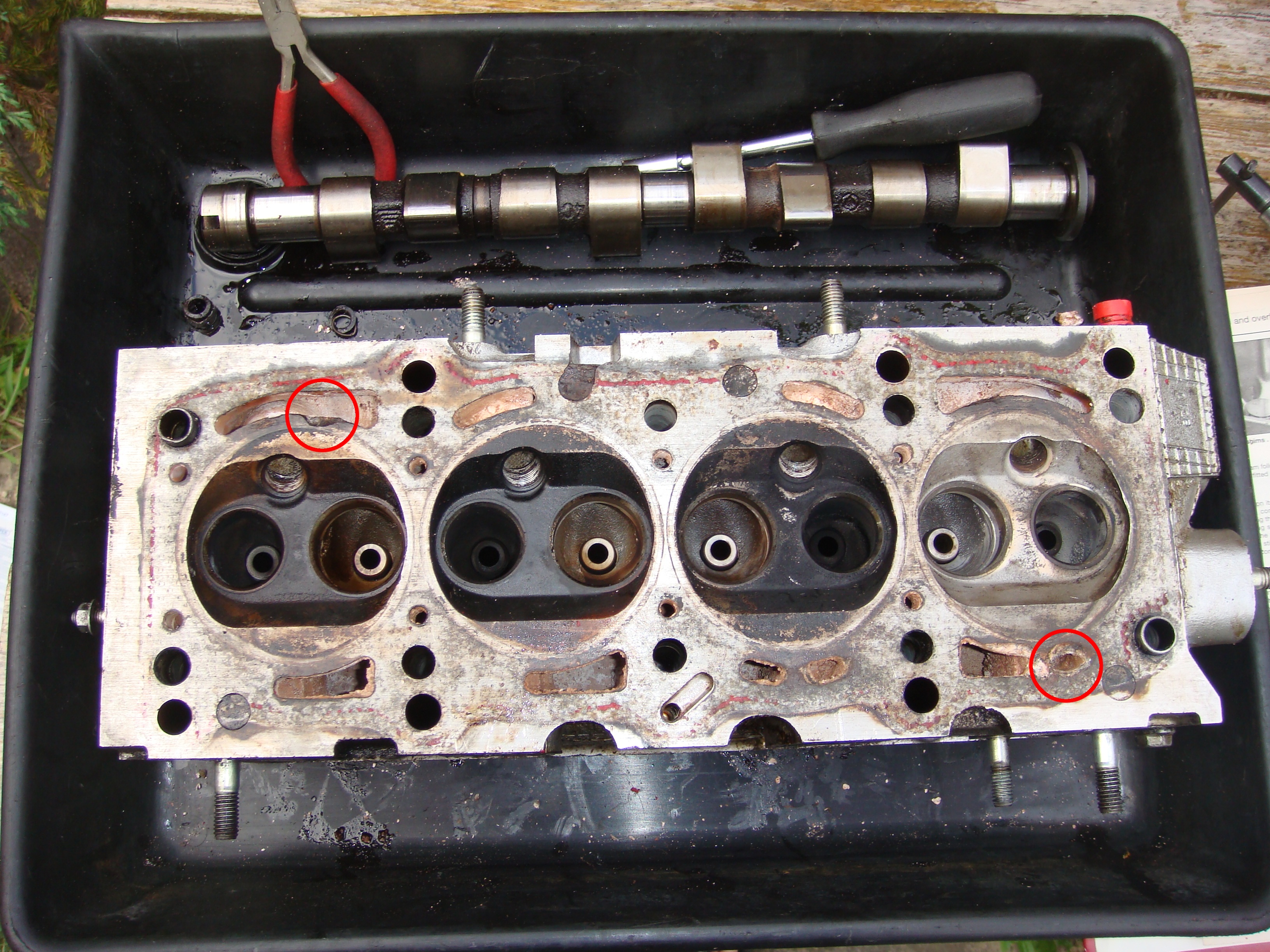

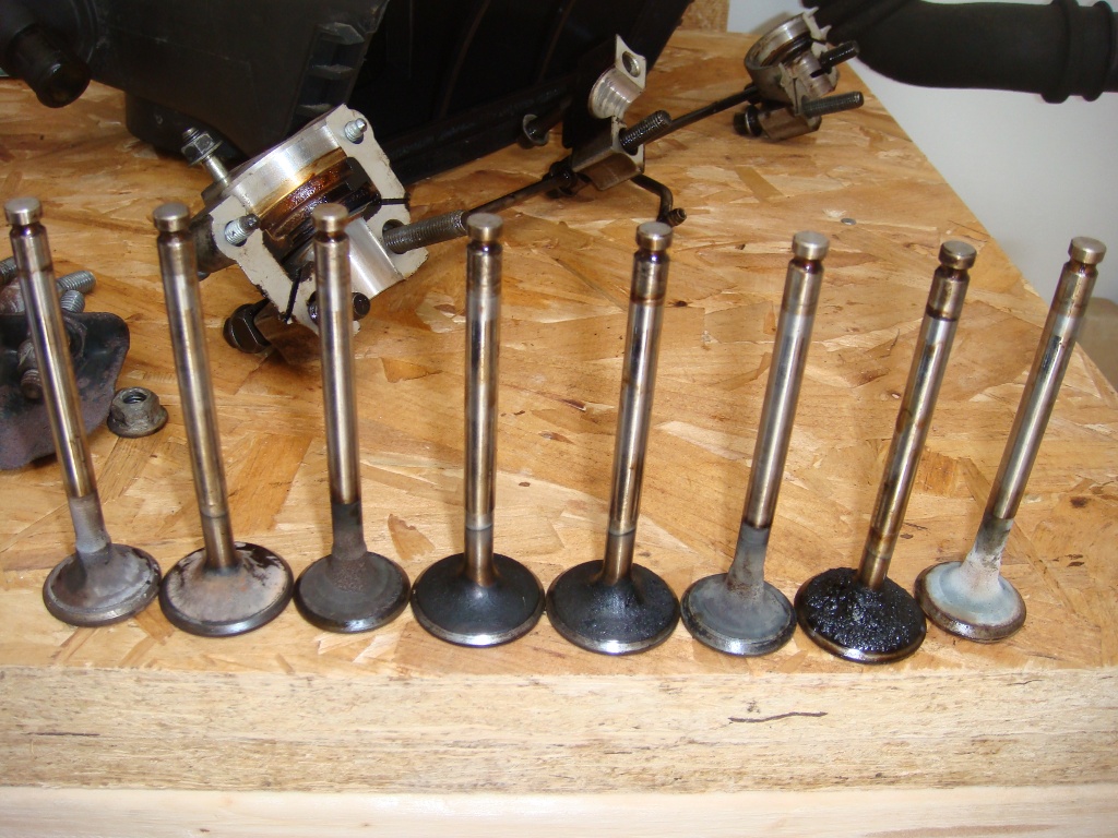

Aaalright, been a while with updates - been waiting for my valve spring compressor. It finally came, and I removed all the valves from the cylinder head. Probably going to get to cleaning it up tomorrow. In the meantime, I've got some potential diagnostic clues I was wondering if you could give your thoughts on (sorry, no direct clue on the HG, as it was so stuck to the cylinder block and head that it tore apart when I separated them).
1) The valves are different colors, as shown in the first photo (timing belt to left). Does anything here look unusual, e.g. due to overheating in one specific area, such as piston 1 (closest to timing belt). One of the valves (don't remember, but can check if it's at all helpful) was encrusted in black deposits on the inside (i.e. the top of the wide valve end, or the part you don't see until you take it apart).

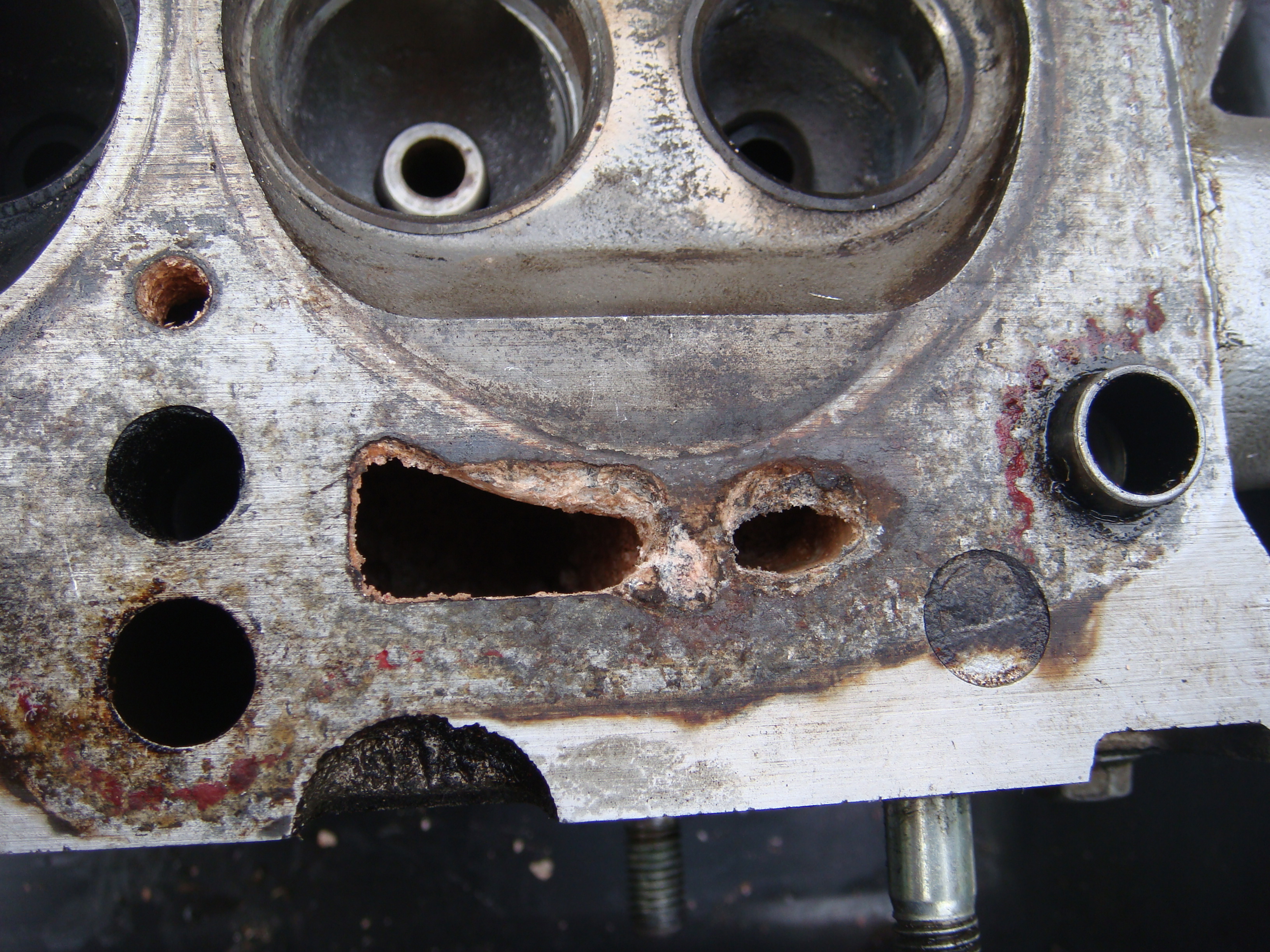

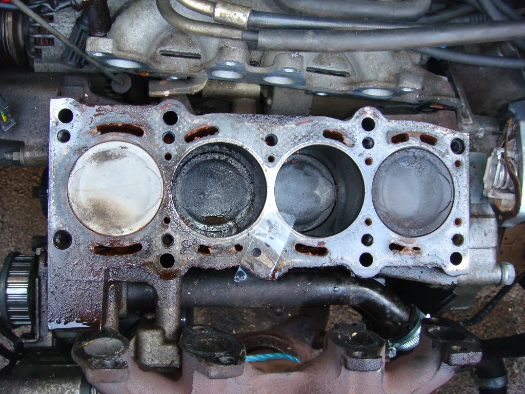

2) After removing all the valves, had a closer look at the state of the cylinder head in general, and I must say, I'm worried. First of all, see the second photo for the state of the entry coolant hole (from the water pump) - is this much deposit normal, prior to cleaning?
3) Second, it looks to me like using nothing but water (?) for coolant (previous owners) may have caused some major corrosion problems, as in the marked areas of photo 3 (timing belt right), with close-ups of a big-ass missing chunk off the head mating surface in photo 4, and one of the waterway dividers(?) in photo 5. Is that it - kaput? Or is there hope of any sort short of a reconditioned cylinder head?
Should I be thinking about returning the car to the used car lot I got it from, on the basis that they sold me an unusable piece of machinery (in its current state)?
So frustrating!

That head's f*cked, mate. The aluminium has corroded away, there isn't enough meat on there for a good seal. I bet that was the cause of the gasket going. Time to find a replacement, there are some on eBay for not much money, but you'll need to make sure you get the right one.
Is your car single- or multi-point injection? You'll need a matching head, as the inlet ports will likely be a different shape between the two. You could get a decent used head in good condition and swap and neccessary parts, would work out cheaper than a recon head. But with a recon head you know you're getting a good piece that's had a good once over by someone who knows their ****.
If that was the cause of the gasket blowing then the damage is most likely contained to the head itself. The block is cast iron and the pistons are unlikely to have sustaned any damage. Just clean out everything you can. That buildup on the valve is probably thick carbon deposit. Got a piccy?

Alrighty,
First off, a pic of the inlet manifold. Am I correct in assuming that since there are no fuel injectors attached to the four individual pipes, but just the throttle attached to the main inlet pipe, before it branches into four, that I therefore have a single-point injection engine?
Second, two pics of, on the one hand, the valve bottoms, and on the other hand, the pistons. All white on the leftmost means overheating there, right?
Then, a pic of the 8 valves, set up so the leftmost is the one from closest to the cambelt, then moving away. Valve 7 has some serious crud on it, which also, coincidentally, happens to be from the cylinder with the big chunk missing on the head of it (as in the photo from a previous post, detailing the cylinder head damage).
Finally, a pic of the spark plugs, again leftmost being closest to the cambelt. The first has greyish deposits, the second brownish, while nos. 3 and 4 look glazed - meaning overheating there, right?
Also, I'll reiterate a previous question in a slightly different way: Is the amount of corrosion (as per the photos in previous posts on this thread) in the cylinder head unusually severe, or is it only to be expected of a -99 Punto?
