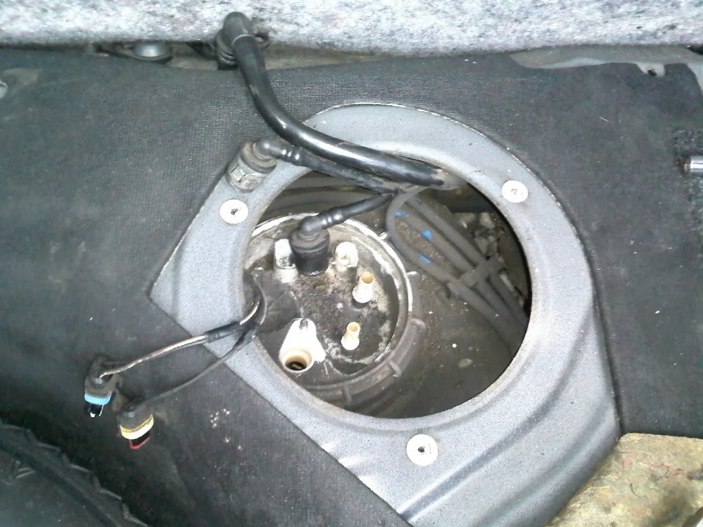

First try something simple clean the electrical contacts on the fuel pump, it might fix the gauge problem too. If you lift up the boot carpet there is a triangular plastic cover with three screws holding it on, take it off and you can see the pump. Unplug the connector and use some electrical contact cleaner on the pins.

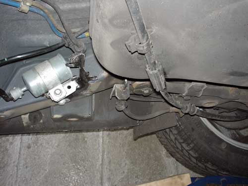

The Bravos fuel filter should be replaced once a year it is found under the car in front of the rear wheel on the drivers side hidden under a plastic cover you can see a example in my picture attached.

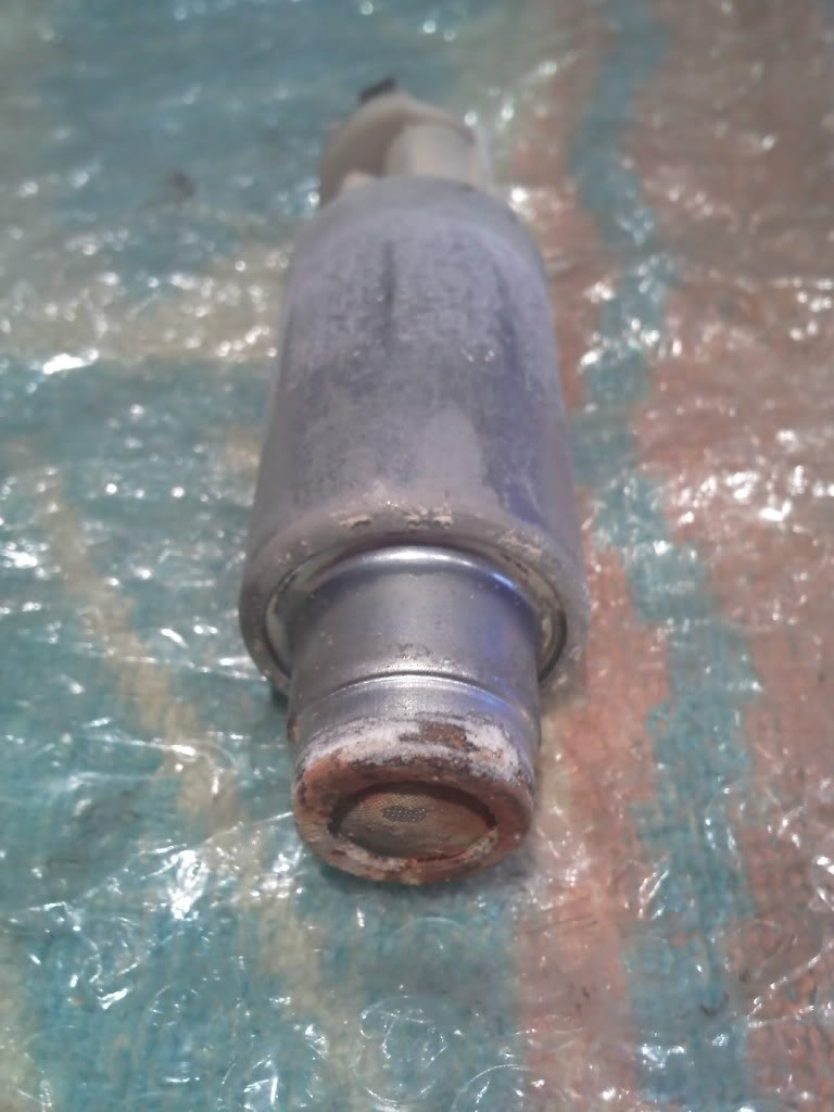

I think changing the fuel filter and getting some good fuel in the tank would be best to try first. Then perhaps next removing the fuel pump and looking at the gauze/mesh type filter on the end of the fuel pump motor I have seen these blocked before but cant find a picture again.
