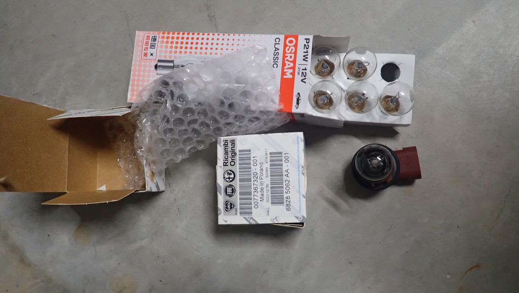

replaced both DRL bulb holders today because driver side had melted, was giving intermittent blown bulb error
part number: 0077367320-001
also, new bulbs
