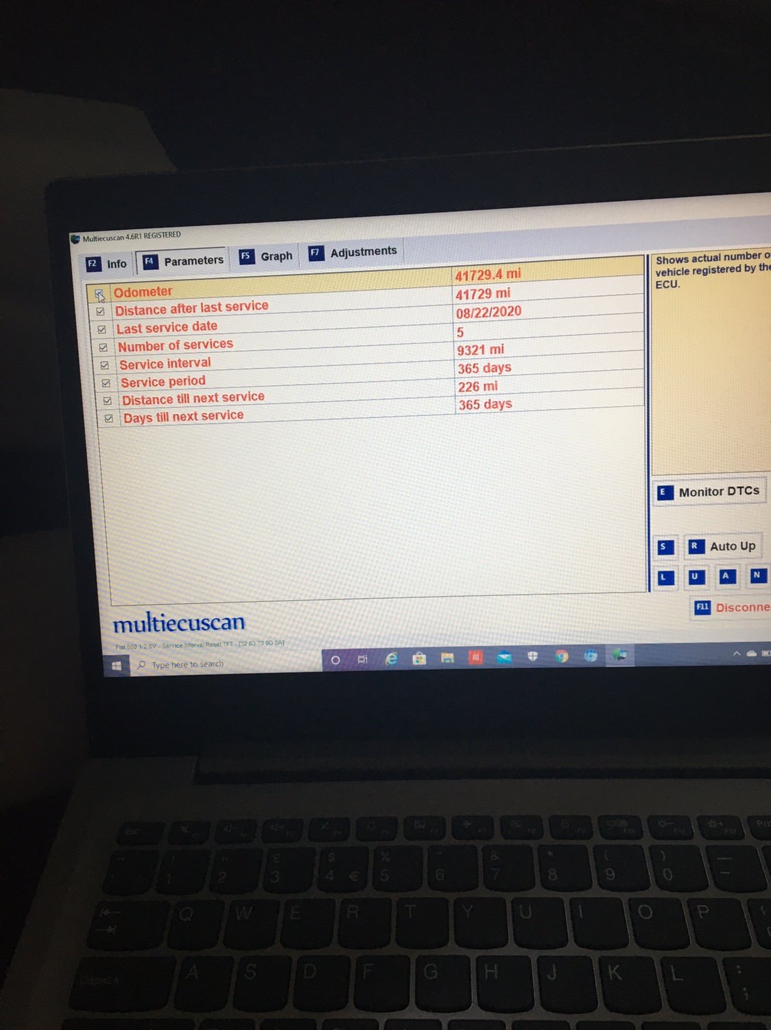

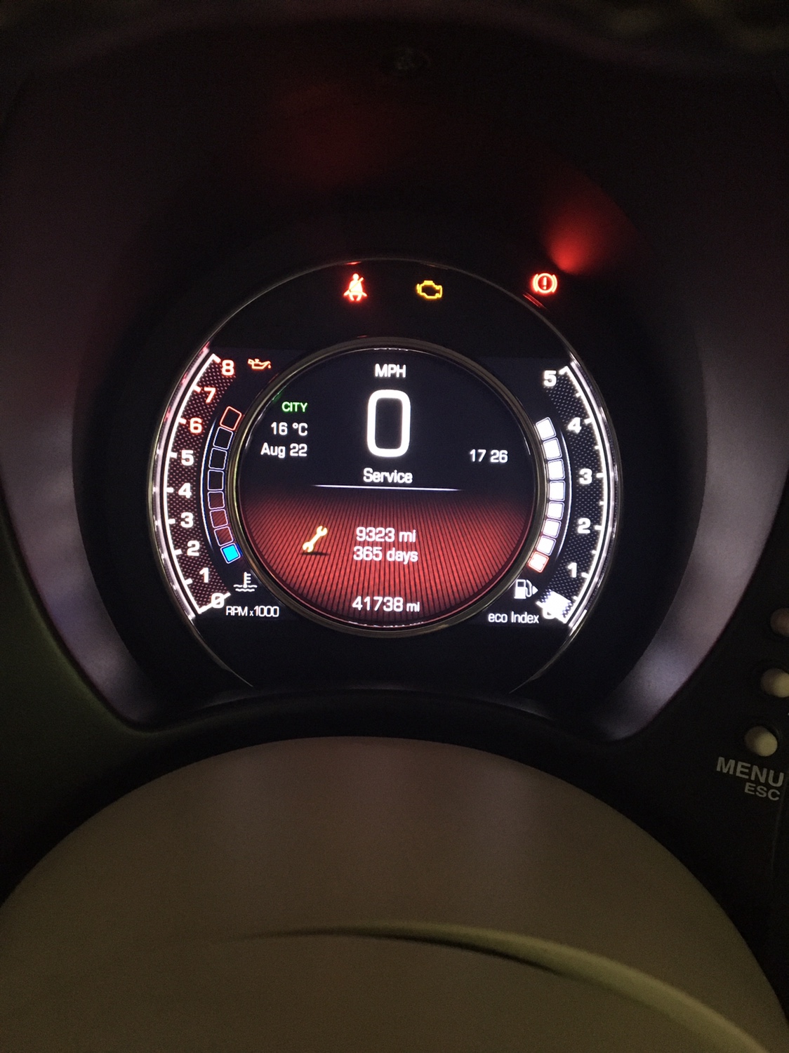

Just re set my service on my TFT and I don’t understand what it’s saying [emoji38] I’ve added a pic of MES after re set and a pic of my service due on TFT display
Can anyone advise as it seems confusing!
I only had a reset option I couldn’t add a date it just reset from today IMG_5144.JPGIMG_5145.JPG

I only had a reset option I couldn’t add a date it just reset from todayView attachment 212018View attachment 212019
Hi,
Is your display saying your next service is now due in 365days and 9300 ish miles?
If so then you have reset your service display.
Cheers
Jack
The car will now count down from 365 days and shout at you in a year. If don't go far, change oil in 6 months and keep paperwork. I do. (y)
So.. in a thousand miles of driving.... it would need 4 garage visits
I KNOW its a 'baby Ferrari'
But dont think thats how it works ;)
