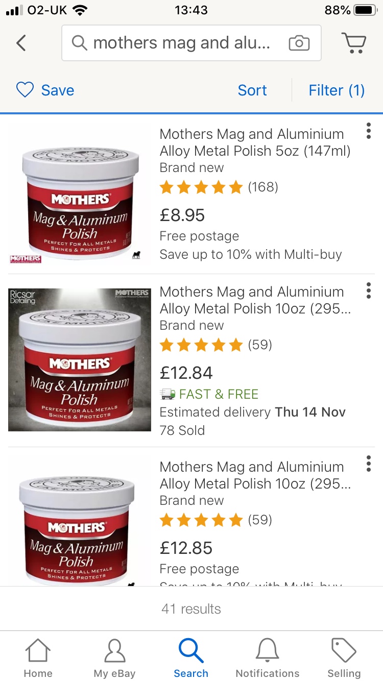

The Mothers Mag looks like a metal polish.. which I guess must be similar to Solvol Autosol or similar. I didn't go that aggressive yet... I started on toothpaste, then tried Safe-T Cut and then Full Fat T-Cut and none of them do any damage or make toooo much of a difference, the way I polish it (by hand). I get the impression that all I'm doing is removing bugs and stuck on road grime, more than removing old polycarbonate.
I might dig out my old tube of Solvol and give that a try... :)
