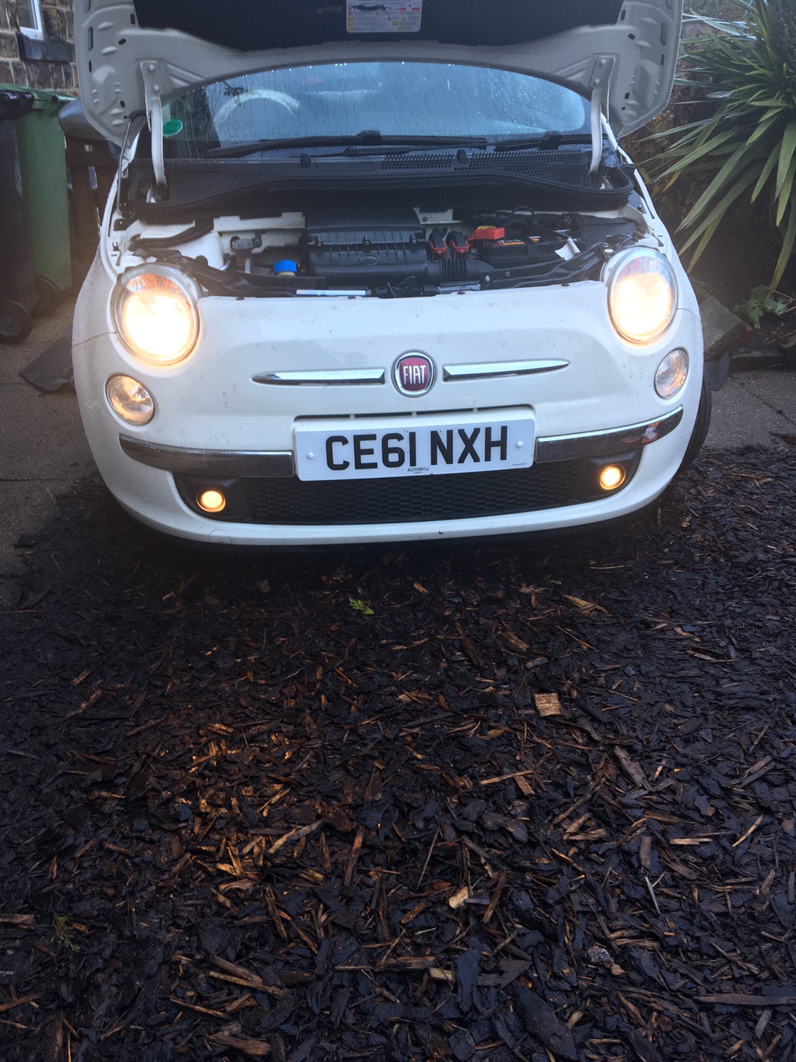

Well got it done! Still having a hard time getting all the air out grrrrr had both valves open too...... I also fitted front fog lights I got off flea bay!! Got the whole kit inc switches .. didn’t need em but thought why not!! IMG_2772.JPG
