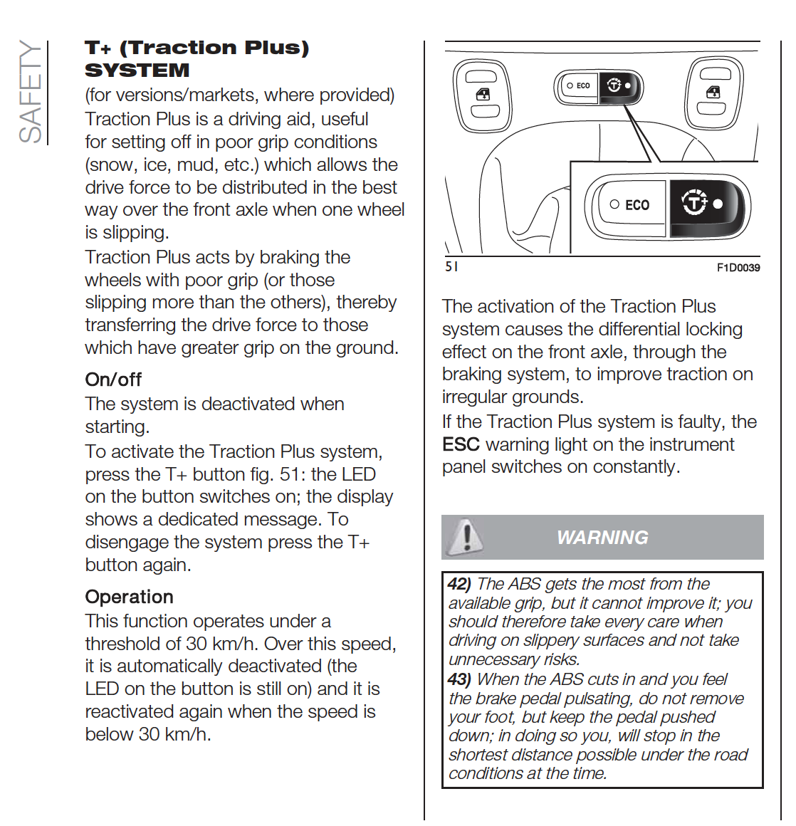

The City Cross has traction control, in other words it brakes the spinning wheel so the other front wheel will give some drive. My City Cross did well recently when I had no option of driving on very muddy grass.
Sorry to say, the City Cross ‘only’ has the same ‘traction control’ as other Pandas, that (as part of the ESC system) cuts engine power if it senses a loss of grip on a road - such as pulling out too fast or cornering too quickly. What it does not have is the ‘Traction Plus’ function offered in the now defunct ‘Trekking’ version - which would work as you describe on snow or wet grass and apply the brake to a spinning wheel, and which was turned on by pressing the T+ button alongside the ‘eco’ button.
Even so, I've read that the ability to turn off the traction control in the standard Panda can still be of benefit in tricky conditions, especially with decent tyres fitted. Hopefully I'll be able to test this out for myself over the coming months just to see how effective that is. I guess that the theory is to maintain full power to any front wheel that has grip until the other one finds some grip and propels you forward?

Maybe not wrong from the dealer. The Panda (and most cars these days) has 'ASR' (anti slip regulation) as part of the ESC (electronic stability control) system. The handbook describes that as working the way I said - reducing engine power if both wheels are loosing grip. But (news to me), it also says "if slipping involves [only] one of the driving wheels, it intervenes automatically braking the wheel that is slipping"... so it was me that was wrong! That does lead me to question what 'Traction Plus" does differently, as that 'extra' is still included with the 'Trekking" versions of the 500L and Qubo - and the Panda handbook still refers to it... maybe it does "the same but more of it"?
(extracts from the handbook that describe each system, below)

I was going to have a play about with the ASR button this morning as it was -6C when I left the house. The main road had been salted but not where I was heading for. Hard to say if there was ice below the hard frost covering the untreated road and car park but I didn't feel any lack of traction from my winter tyres, so didn't think that I would learn anything. The car park was almost empty but I reckoned that my relative inexperience could still lead to a bump if I started to get cocky :D
Traction Plus is basically the ELD but just on the one axle, so the ABS r.educes / stops wheel slip on one wheel. If Fiat explained better how both systems worked I could see the trekking being a great option for a lot pf people and more than adequate for the job in nearly all on road conditions.
