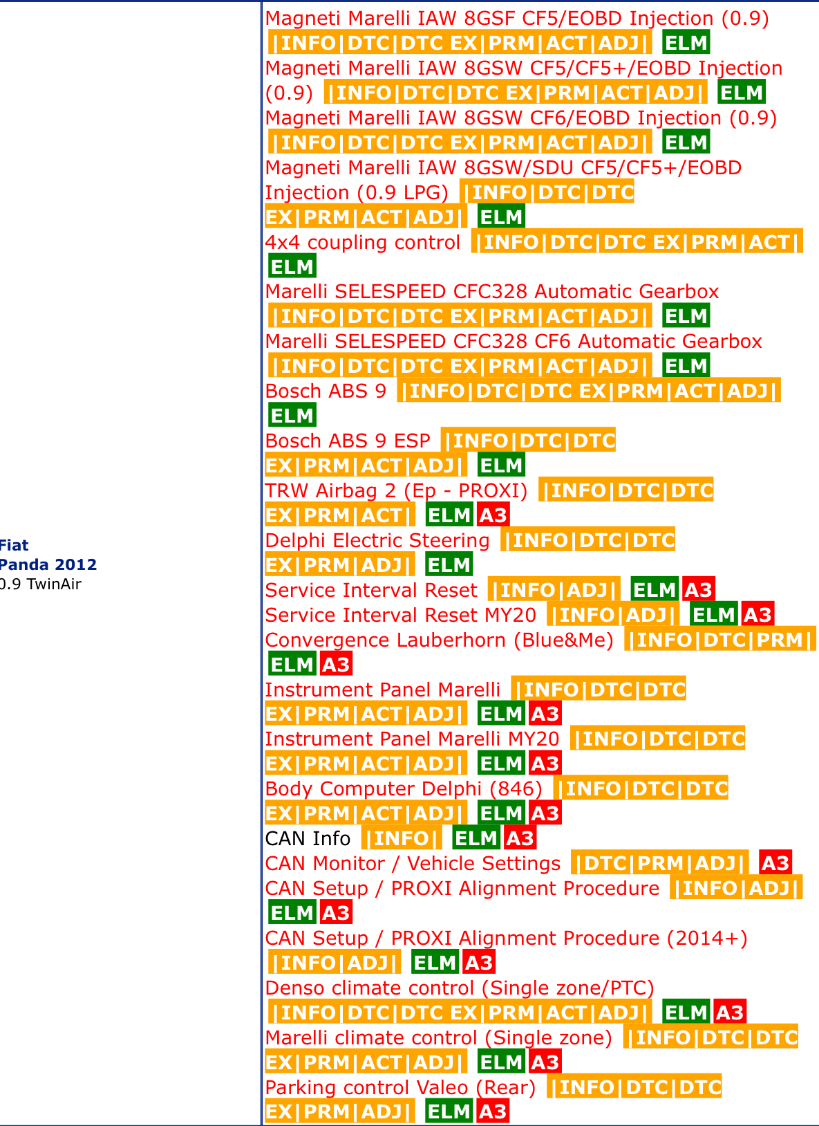

See this table for Panda TwinAit here: https://www.multiecuscan.net/SupportedVehiclesList.aspx
The adapter is only required for: Airbag, Service Reset, Instrument, Blue&Me and Climate system. With the adapter in use you will not be able to see the other systems.

So I only need the yellow adapter to communicate with the modules marked with A3? The rest I connect the vGate directly?
