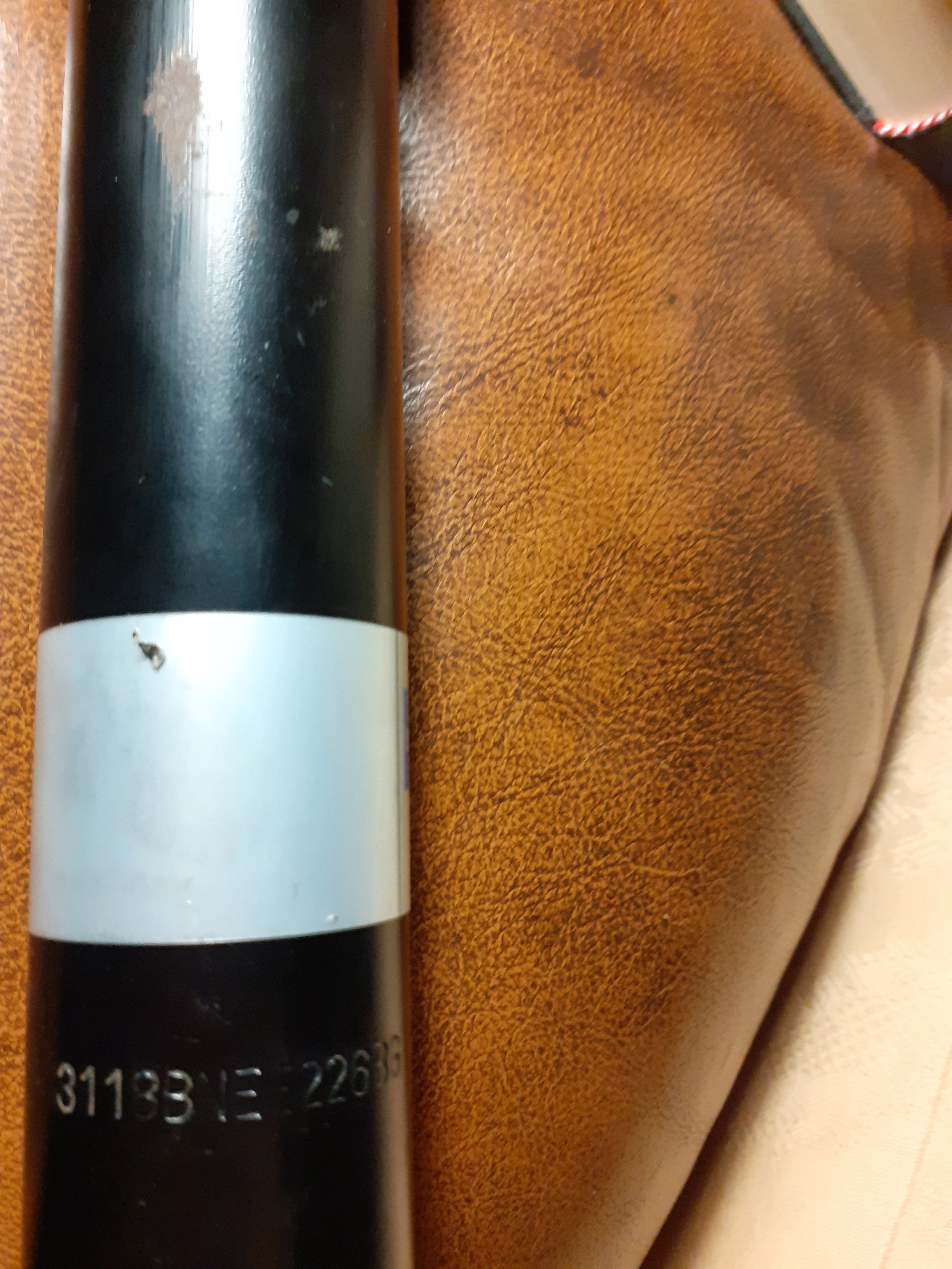

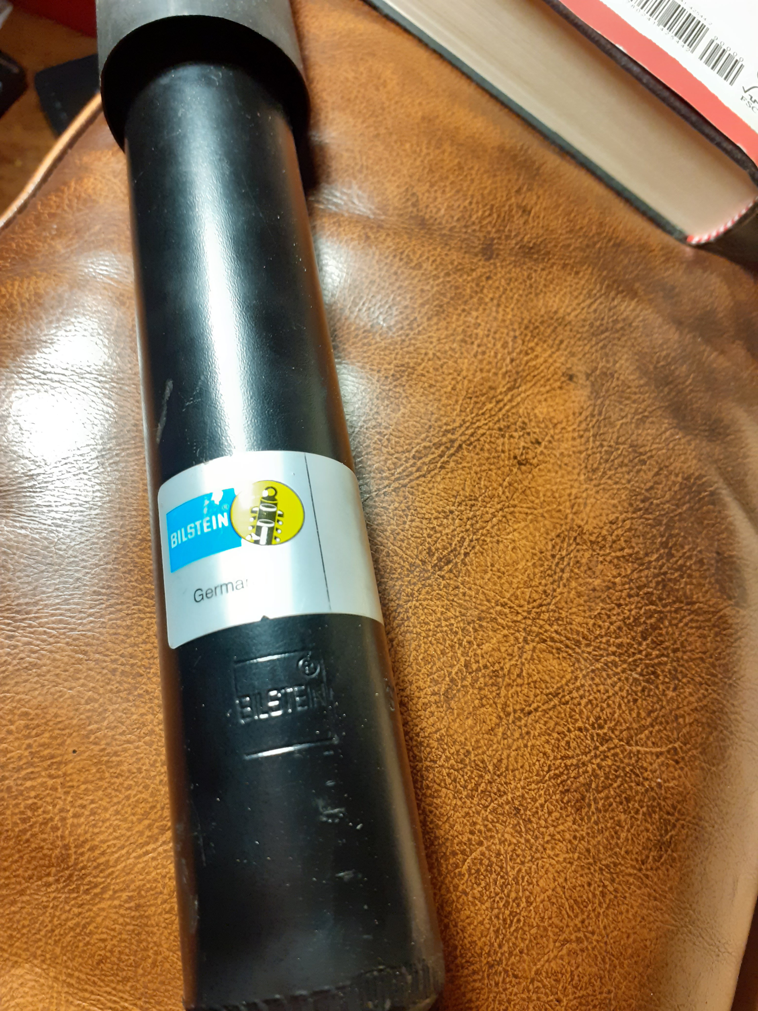

Will check tomorrow
3118BNEE226BG Is the number stamped in the metal

Monro fitted now are just as good as the Bilsteins, they have been doing fine for 2 years and are still good. The correct size bushes too.
Nice controlled ride and way better than KYB I fitted to my Panda 100. They are gas filled too. Panda 100 KYB's failed their test a fter 4 years.Bilstein PArt that have used and still have
Bilstein B4 - Gas Damper 19-142265​
Does anyone want these.. Current retail is £48 each! I am gloing to put them on the classifieds here for 1 month and them throw them away so if your interested please shout.
Thanks for getting that, when you ordered them was the part 19-142265 as that is different to the ones they say fit the 500 which is 19-184104?
I wonder if that’s why it rattled about and they’ve changed to 19-184104
