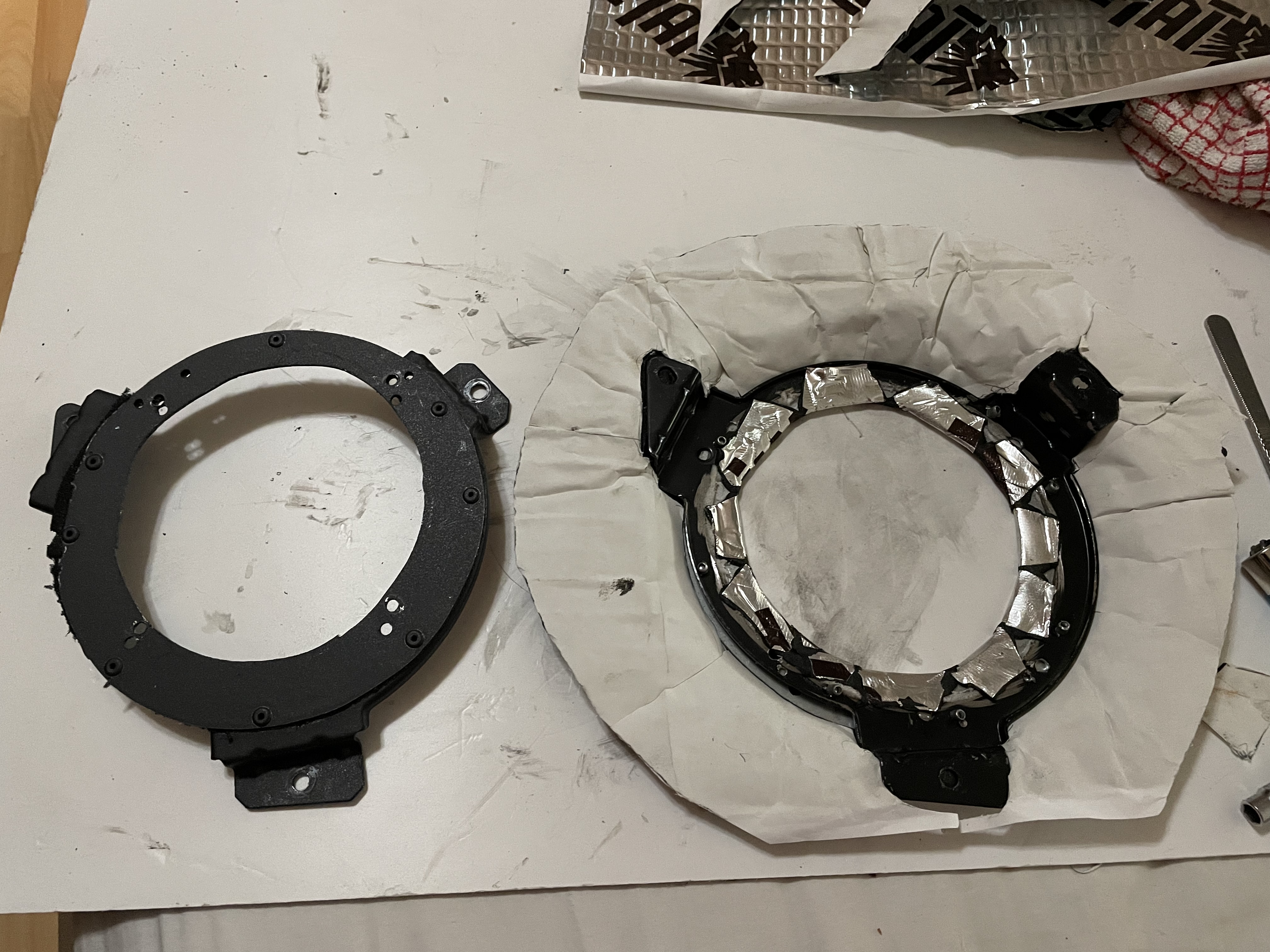

Mine, a 2013 had completely different speaker mounts, it’s been had at before by someone who wasn’t too tidy with the wiring, maybe they used non standard mounts, they’re pressed steel, drivers door bolted on with rivnuts in door skin, passenger side riveted…
I’ve modified them back to a 5.25 from a 6.5 inch speaker after cutting them previously. Covered them in sound deadening to seal the gaps between the front and rear of the driver.
