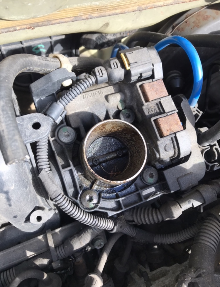

Hmm, it's the plug the arrow is pointing to here that's smoking and I can see it's charred on the underside.

OMG!!!! That is the throttle body and it really doesnt want to look like that! You can remove it to make cleaning easier and it alone will improve your running substantially! Carburettor cleaner spray will remove all that back muck with ease. The four star bolts come out easy enough and there are a couple of wires also to un clip. Once removed you can see inside the inlet manifold . I'll bet a £ to a penny its full of crud, The MAF fits into the manifil fron underneath at its far end. U used a clean cotton rag witha bit of carb cleaner sprayed on as the final clean, but had to wipe out a lot of sudge first.. If you remove the throttle body take not its easy to drop the bolts down the back of then engine. One of mine went down and was never seen again in spit if using magnetic tools , a usb camers, and hours, and I mean hours of searching. The bolts are NOT very tight and should only be just nipped up with your finger pressure something like 4Nm if I remembe rightly. The throttle body has an inbuilt gasket. Take great care not to damage it as they are expensive. I used a small amount of automotive silicon sealer on mine before refitting. I would clean this part first, clean the manifld second, send celan rag on a wire rod into the manifold to wipe the MAF before refitting the throttle body. You cant actually really see the MAF so I just wiped until the rage fed in, came out clean. I would also replace the breather hose / fire trap as its about £15 if I remember and it gets you a clean srart. If that doesnt sort you then get a new MAF but It will be very fiddly I suspect to fit. I think it just clips into the maifold from underneath and has a wire connector that plugs in to it.
If you search catch cans on here you can see I fitted one to collect the sludge that comes out of the breather pipes. It was only again about £15 but needed a bit of fiddling to get the hoses all joined up. SInce doing this I have had to empty the can every week to get rid of sludge but teh car has run fine. I have also since cleaned teh throttle body again but jsut with a carb cleaner spray (engine Off and some clean cotton cloth. The car performs so much better since doing this I could barely believe how good it felt after.

Nothing looks wright in your photos
The rusty VVT solenoid normally look like new with 100k miles on them
There shouldn’t be oil
There shouldn’t be arcing
The butterfly valve in the throttle body shouldn’t be gummed up like that
The arcing is probably due to all the muck under there
I would start by cleaning the coil pack up
Clean the HT leads
Inspect where the HT plug into the coil pack
Inspect and post a photo of the plugs

Wel Ive never seen smoke from a coil either. Looking at the state of the throttle body it looks like a case of excess crankcase pressure and one can only hope it was not wiring frying. I am always amazed people pay for an expensive assest and let it become worthless by not maintaining the thing. Theres a balance for those not afflicted by OCD(Panda) but you see it so often. Best to stay on top of things so its hopefully just one issue at a time, I have to say that I tend to agree with your diagnosis. Hopefully not the end of the world. I think we have a head gasket issue developing but dont want to get into the freewheeling cam pulley issues of doing DIY so its going to be a bit costly.

I would be over concerned about the throttle body. Although I would take the 4 bolts out and look underneath for a pool of mayonnaise due to it stand for such a long time
