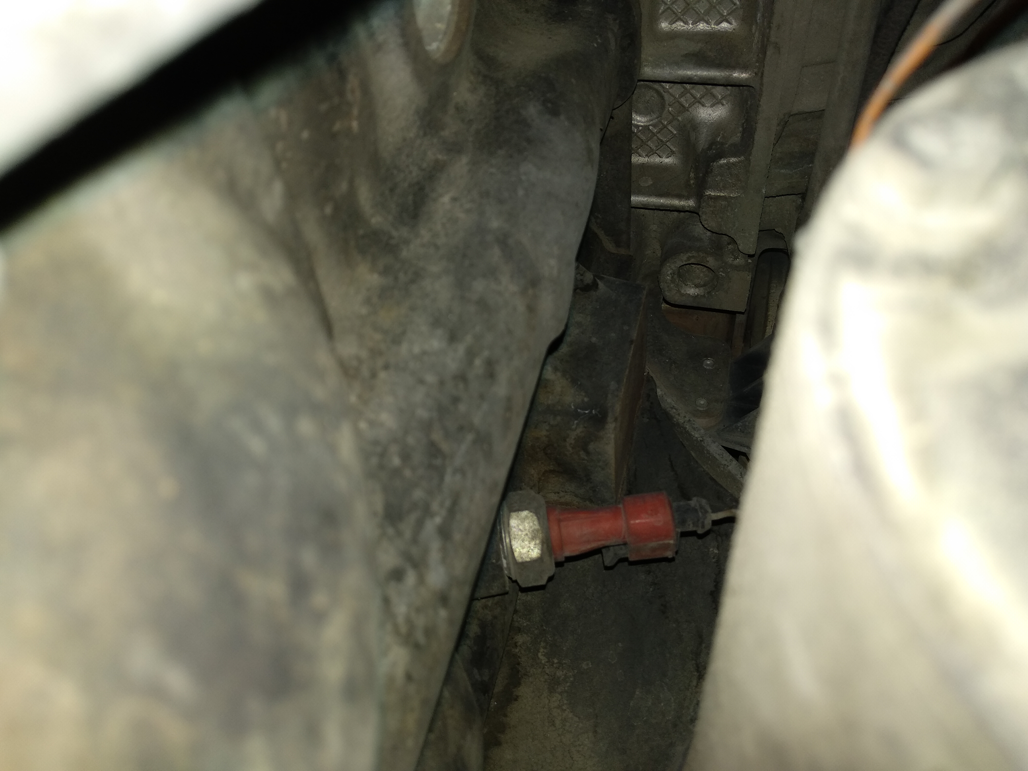

I think I found the oil pressure sensor under the oil filter, is this it?
Hi, The oil pressure switch / sensor is behind the starter motor. If you put your hand over it you'll feel it on the engine block.

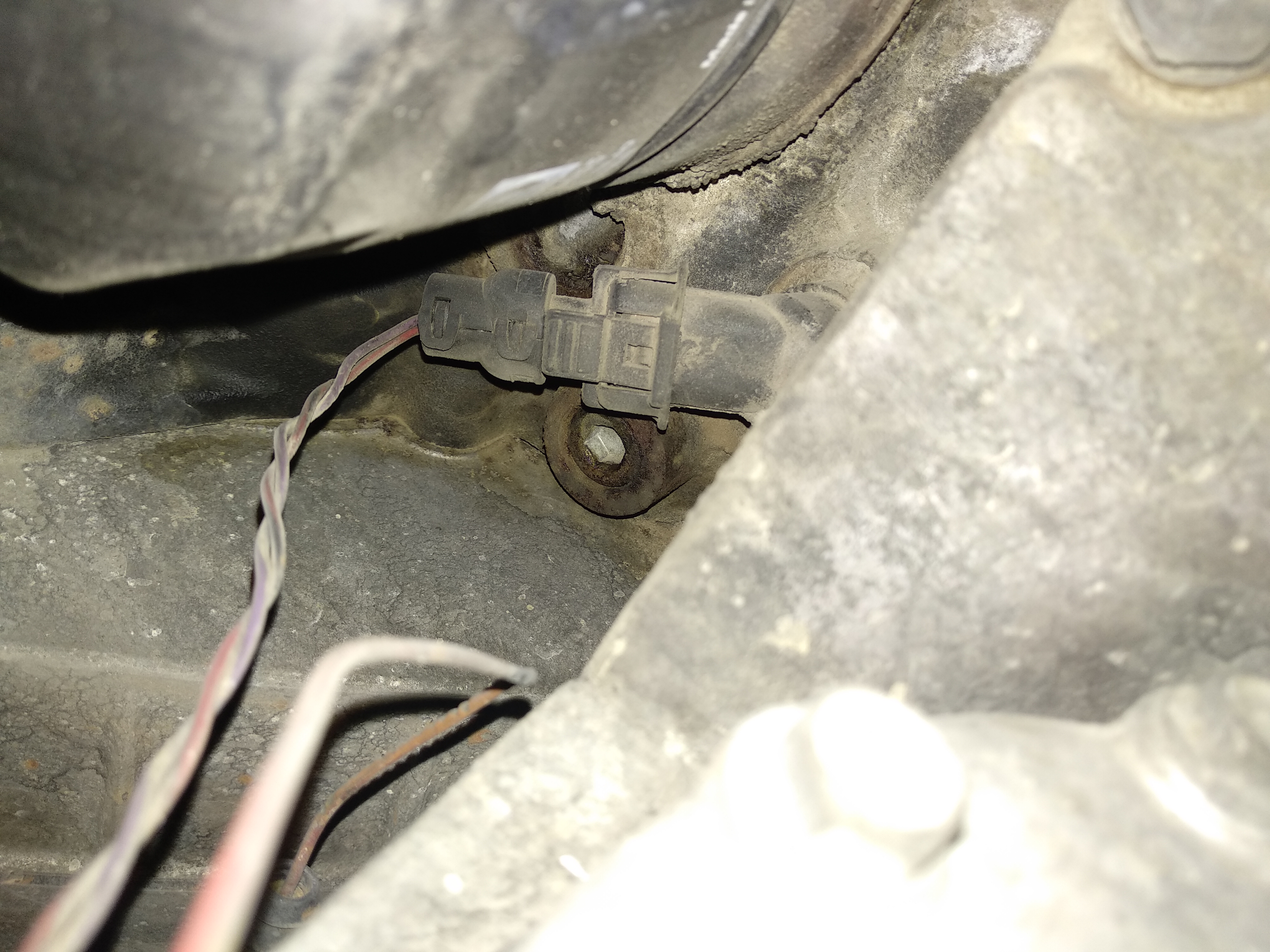

So I found the oil pressure sensor behind the starter and here's a picture of it.
In the mean time I flushed the engine and adjusted the drivers seat. The guy who drove before me was a bit taller and my foot might have been slipping on the clutch... Either way, I don't seem to be having the problem any more.
