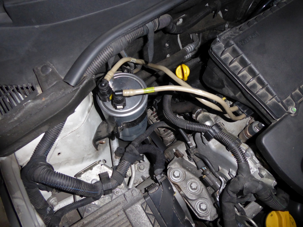

Thanks you reply am going to change the big filter in engine bay don't know which that is where would other one be thanks
Thats the service filter.
The primary is built into the fuel tanks 'liftpump' ;)

Primary filter is just a mesh-wire style located directly at the pump IN the tank. The main fuel filter is under the bonnet, attached to the right wing. Picture of mine shows two pipes but yours might have a third one (return), doesn't matter. You'll need to (firmly) press on each side of the quick connectors to release them. You'll aslo have to disconnect the water in fuel/temperature sensor at the bottom, remove it and re-install in the new filter...
