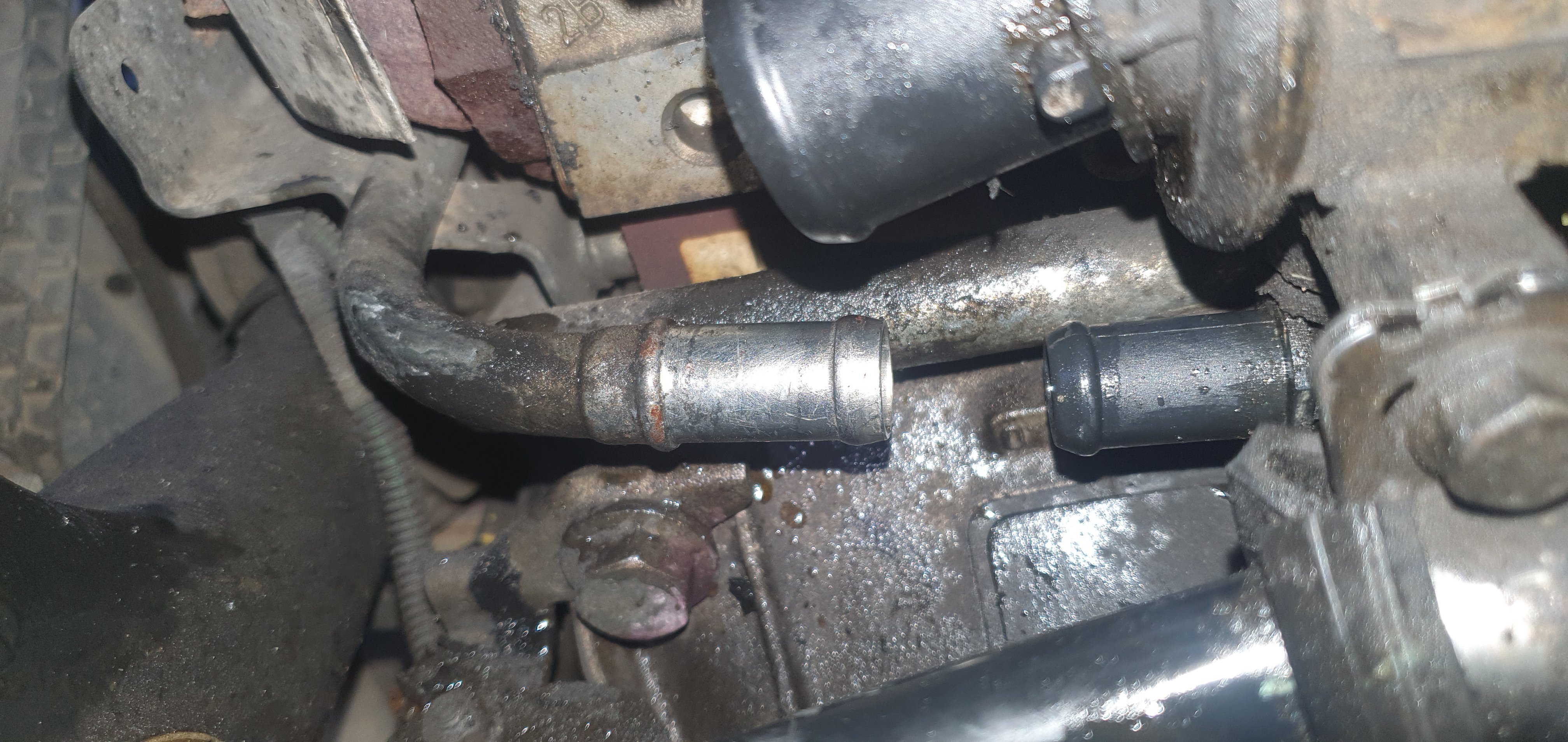

I have sourced the small pipe, it feeds the thermostat, but the next question is how do I reattach it, the pipe is 3" long and the gap is like 1"?
Unless you undo what ever the pipes goes to at on end, the only thing I can suggest is what we used to do in the old days with mini bypass hoses, instead of the flimsy corrugated rubber replacement we used a correct length of heater hose greased it up and bent it double and popped it in place then opened the clips and fitted them around the hose afterwards. I don't know if that is possible for you as I have never changed one on a Fiat Punto.

Thanks, never thought of that. The pipe and the housing seem to be fixed in place. Not keen to start removing housings etcetera.
Warm it up a bit, roll around and work it in your hand, then grease it up, make sure no sharp edges and with luck hose will pop on, then you just have to fiddle with the clips.
And it worked, struggled with the limited space in there, but got it on. Many thanks to you.
