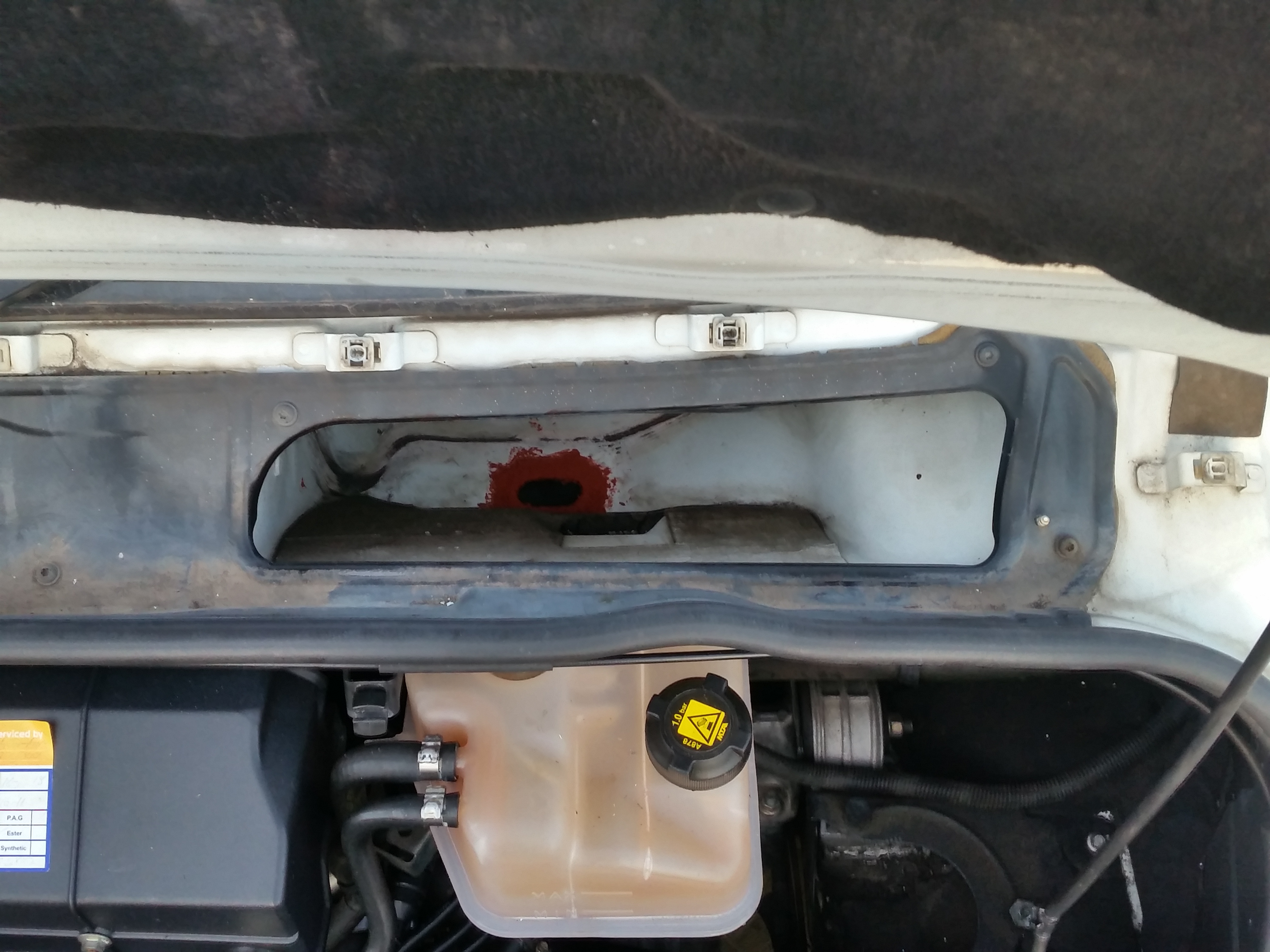

I noticed a leak coming from the passenger side below the windscreen.
There seems to be a funnel designed there in the van which directs water into the engine bay from just below the windscreen by design. I noticed it leaks from the pipe that passes into the inside the engine bay and collects at the left hand mount near the auto gearbox. Will need to sort that which means removing trim below windscreen and just above the bonnet.

I understand you dont't understand about the funnel shaped below the windscreen which
goes into the engine bay right above the electronic connector for the auto.
If it sounds stupid...it is because it is stupid.
It is a dumb design because mine leaks. At least I have spotted the leak.
Water off the windscreen funnels to it through a grill at the bottom of the windscreen!
I know why people have complaints with the auto failing.
Hoping I am not too late to seal it and fix it? (Thunderstorm and heavy rain now!)
I would need to remove the passenger side grill to seal the bottom to the pipe.
Water is going around the seal of the pipe and dumping directly into my engine bay ...with the bonnet closed! ....at least i know!
Just need the rain to stop ....so it dries ...then I can seal it.

Communicator
I understand not understanding my description.

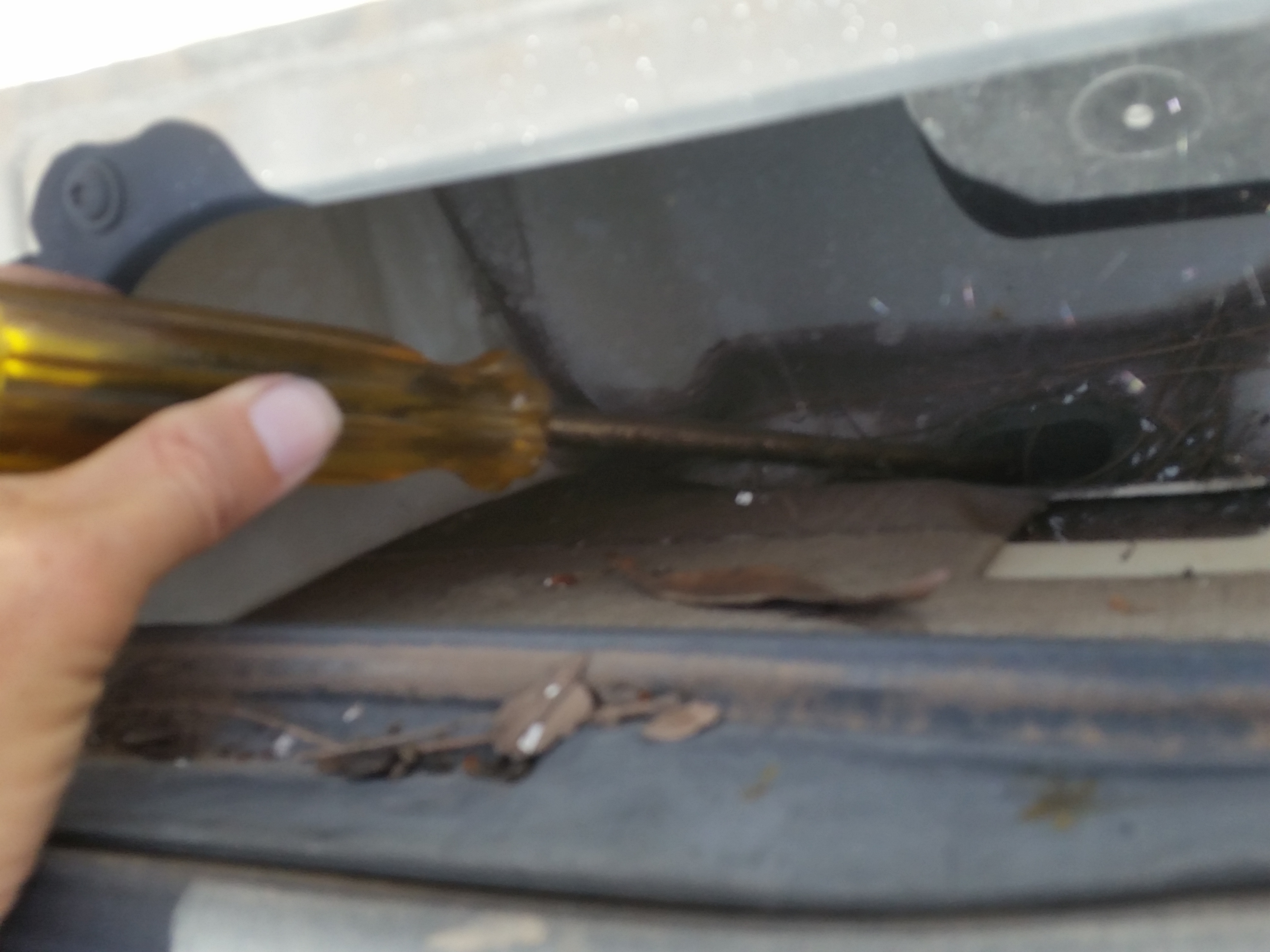

Here is some pictures of the windscreen funnel.
It was leaking inside of the engine bay!! Mainly onto the Auto electronic plug and mount.
I have sealed the funnel now. Orange sealant.

here is another pic of the sealed windscreen funnel.

Thanks for the photos. I took a photo through the grille last night. The arrangement looks to be the same as mine which has a manual box. I think that what I was not understanding was that it was the connection to the drain pipe which was leaking. On my vehicle the moulded rubber drain hose passes over the gearbox, before discharging behind it (from memory).
The use of a non circular hose connection seems to be the weak point, with the longer sides (back and front), tending to distort inwards causing the leak. Mine looks OK so far. I suspect that a warmer climate could be a factor. Is your drain pipe clear, or could there be a collection of rotten leaves in it? Have you tried some water down the hole?

Now that you see that windscreen funnel. It is approx 30 cm deep and was bypassing that outpipe and basically dousing the engine bay over the auto gearbox electrical connector.
Water in fuel from condensation is my next suspect...although there is no warning on the dash?
I will have to test if my sealing did a good job for the windscreen funnel.
It is in a very awkward spot and was hard to get the surface clean also.
