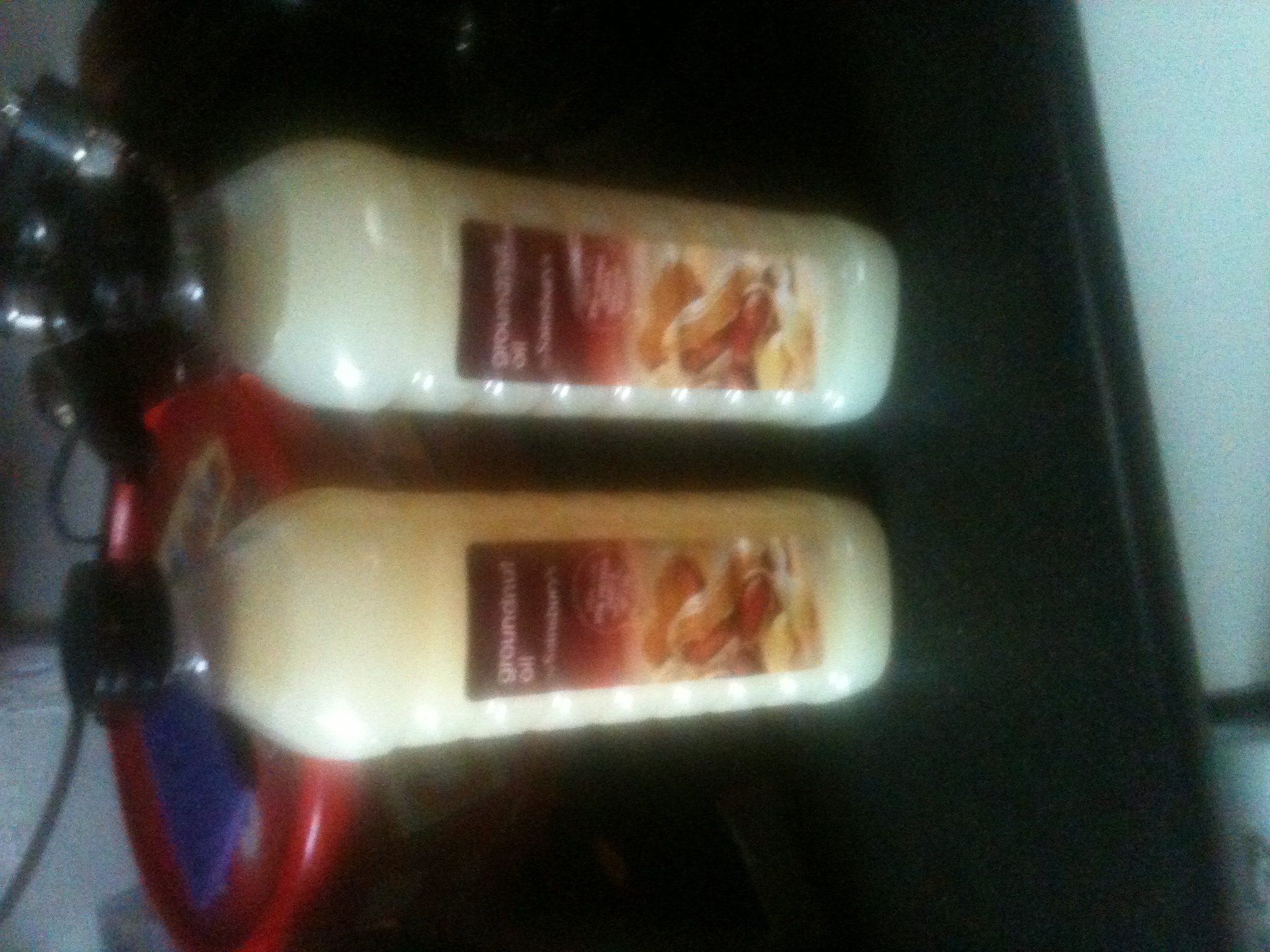

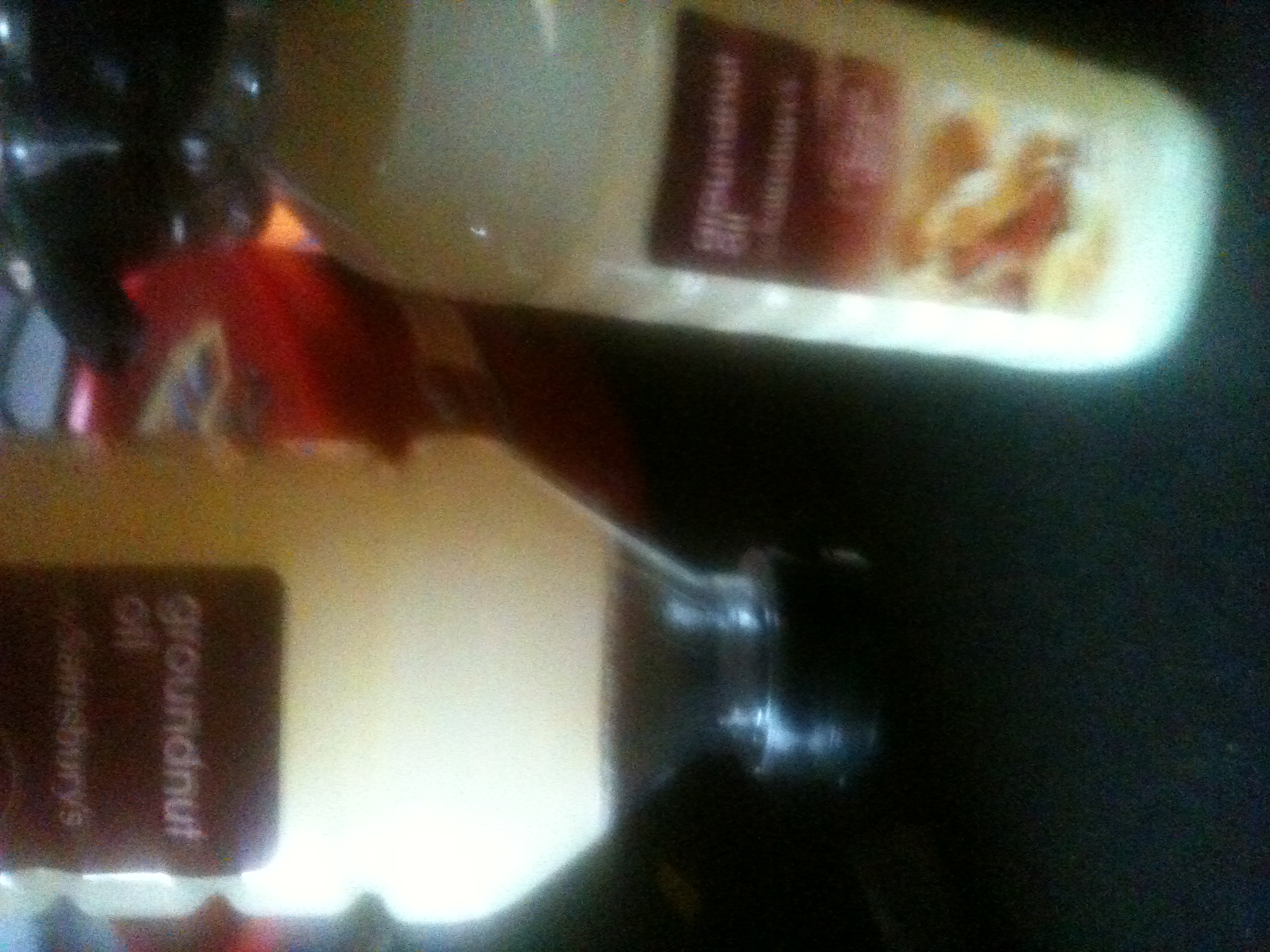

ive also tried peanut oil this summer but i wouldn't recommend using it at this time of year as it goes like candle wax this sort of temperature.
this was the penut oil left in garage at about 5c to 10c it just solidified, ive been told it wouldn't/ doesn't when mixed into diesel but i didn't like the thought
