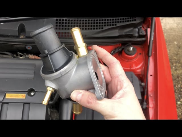

Let's throw the disclaimer out there at the very start. I've changed the thermostat on my 2.4 today, so that is what the pictures show.
Now I've changed stats on the JTD models before and I know them to be technically very, very similar, so please use this guide as a useful reference for changing the 'stat on your JTD too.
Second disclaimer please note the number of pipes and location of them may differ slightly from that shown in picture depending on model and year. The principle is the same, they've gotta come off the old one and go back on the new one.... simples
