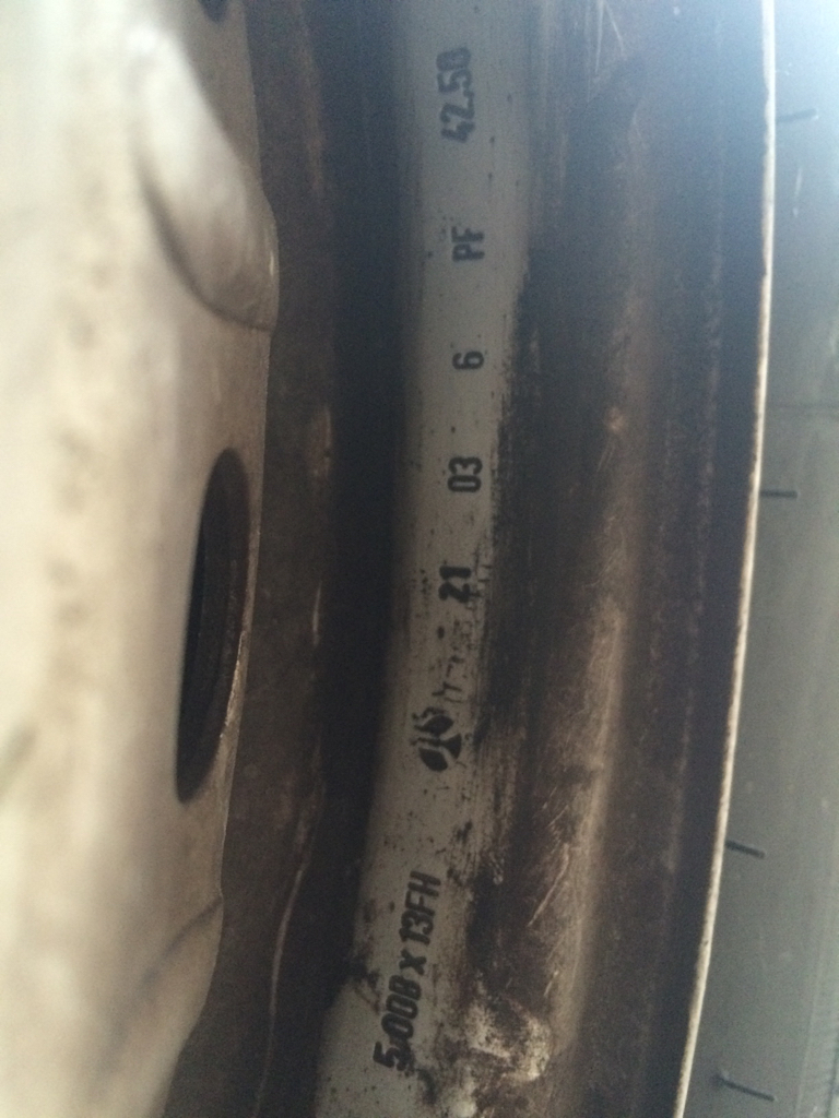

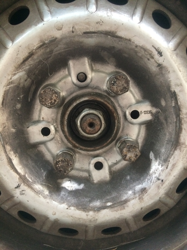

Give us the info stamped in the original rim, like ET ( offset) etc.
Tire size is not accurate enough.
(I'm almost sure you can use a rim from a Fiat Uno....)
I recognize those figures from my former Fiorino Pick up...
You can search for a rim 5Jx13, ET 42,5, 4x98.
Maybe more luck to find 4 Fiat Uno rims...??
Btw, ET may be lower, about 35, this will give a bit wider track...( only if buying 4 rims...!!)
You can even try to find like 5,5Jx14, ET 35, 4x98, and fit lower section tires...
