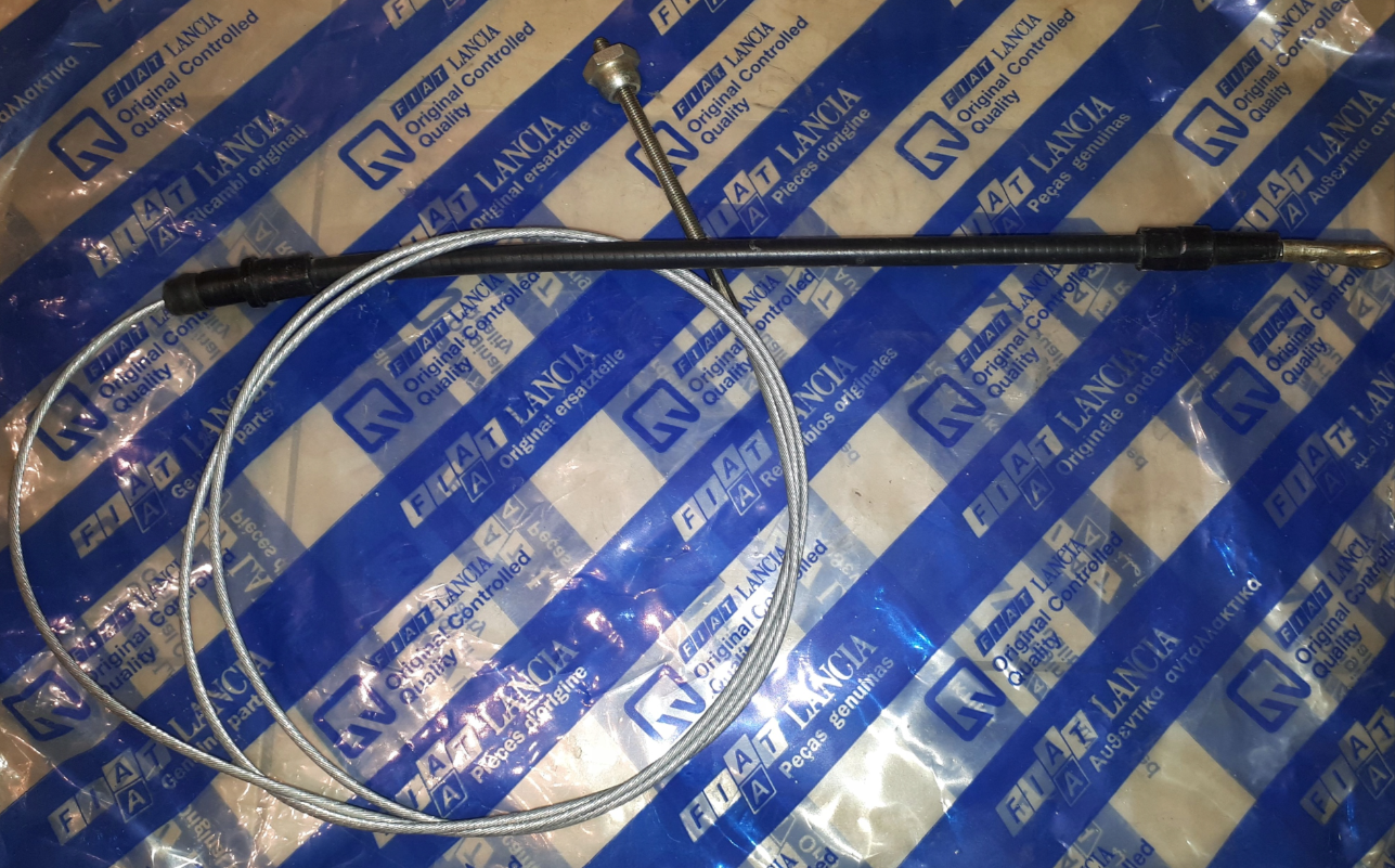

Thanks for the advice! There are some springs and one was missing earlier which I already replaced. I now ordered a new cable to replace that since it is a cheaper replacement first. If that will not work I will go further and look at the clutch itself.
Alright bit of an update, and if people dont mind I will keep updating this for others who also ran into this problem.
Clutch cable operates really smoothly after replacing, the clutch never felt this smooth. But after a 20+ minute drive the same problem showed up. The clutch got worse and worse. I will still try to adjust but accepted that I will need a new clutch. The pressure bearing seems the most likely to be the issue but replacing the clutchplate and pressureplate at the same time seems the smartest thing to do.

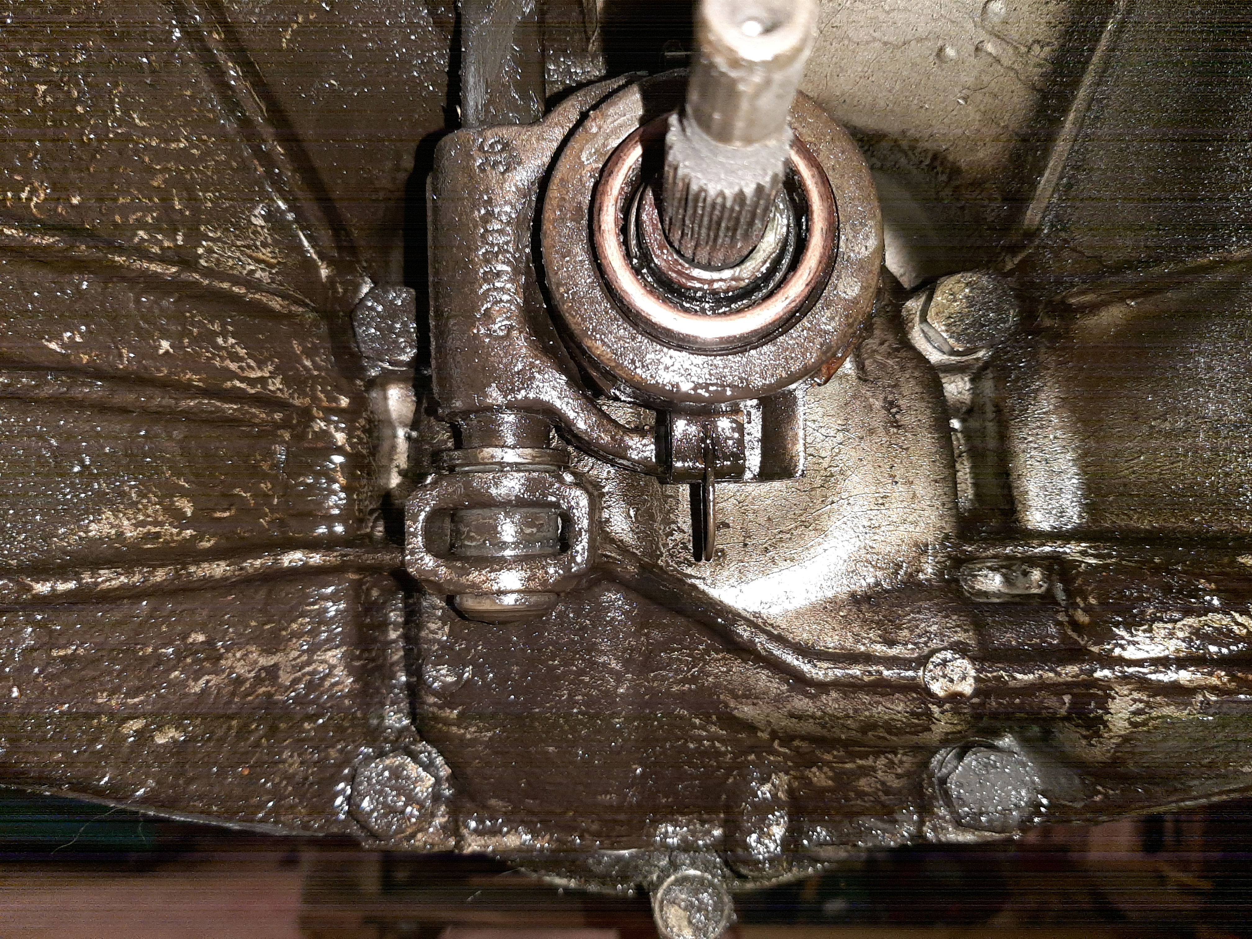

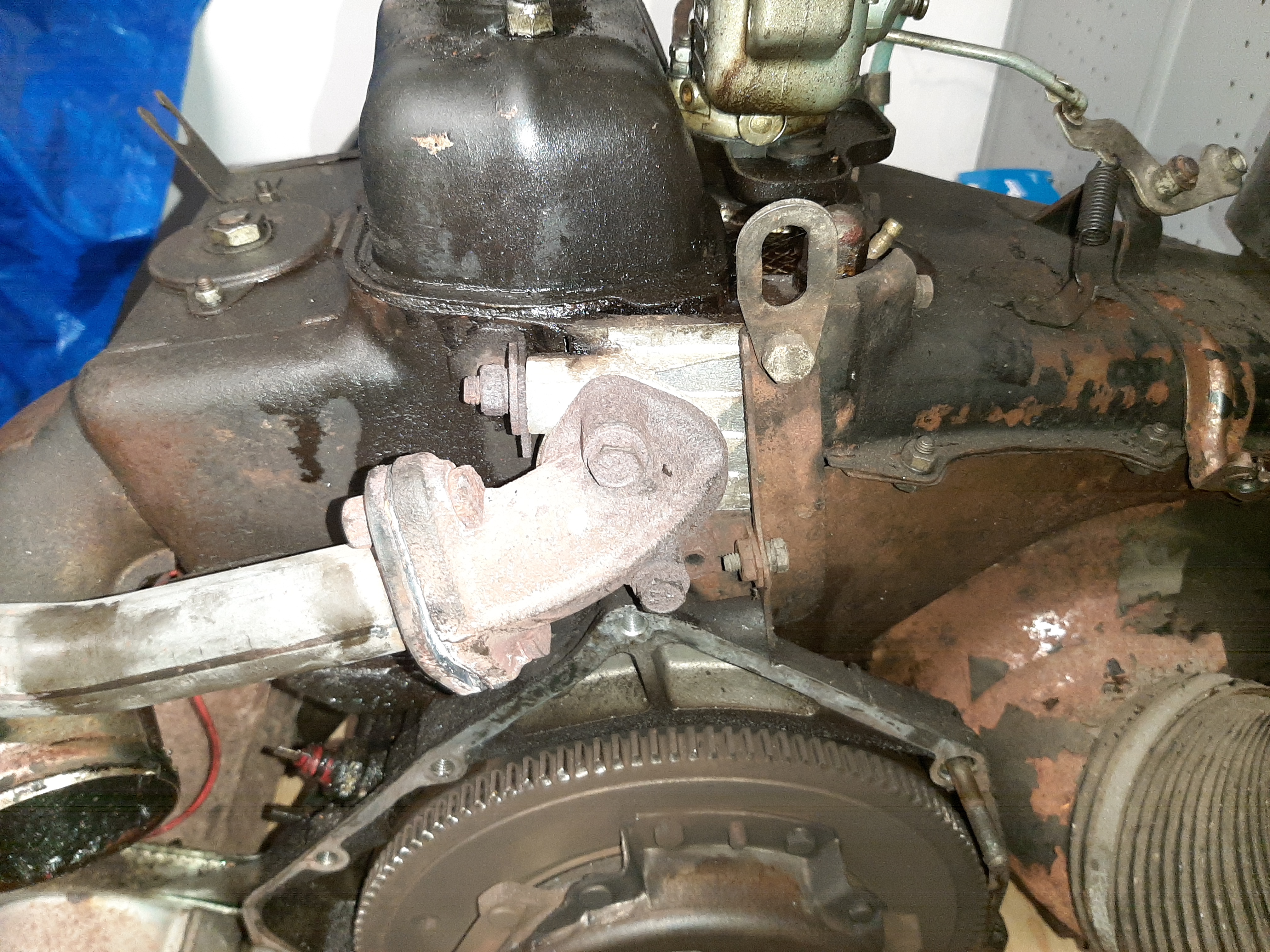

Alright, time for an update. I could use some feedback on what to do next. Pictures of what I am describing are included. Over Christmas break I have time to work on it so that is my intention.
Today I removed the engine and tomorrow I will start to clean EVERYTHING because there is lots and lots of oil everywhere. I will also remove the current clutch and pressure plate tomorrow to see behind there and will post pictures of that aswell. Because the current pressure group looks clean I have a feeling the leak is from the gearbox. Any idea?

On the last photo I'd say the leak comes from under the valve cover. That seal loves to leak all the time :(
Yes and I have ordered a new gasket which should arive tommorow.
I will replace the valve cover gasket and the priceas(transmission input shaft) seal since I do believe that are the two main leaks which cause all the lost oil. As always, hopefully it will work and I will send a update when everything is together.
