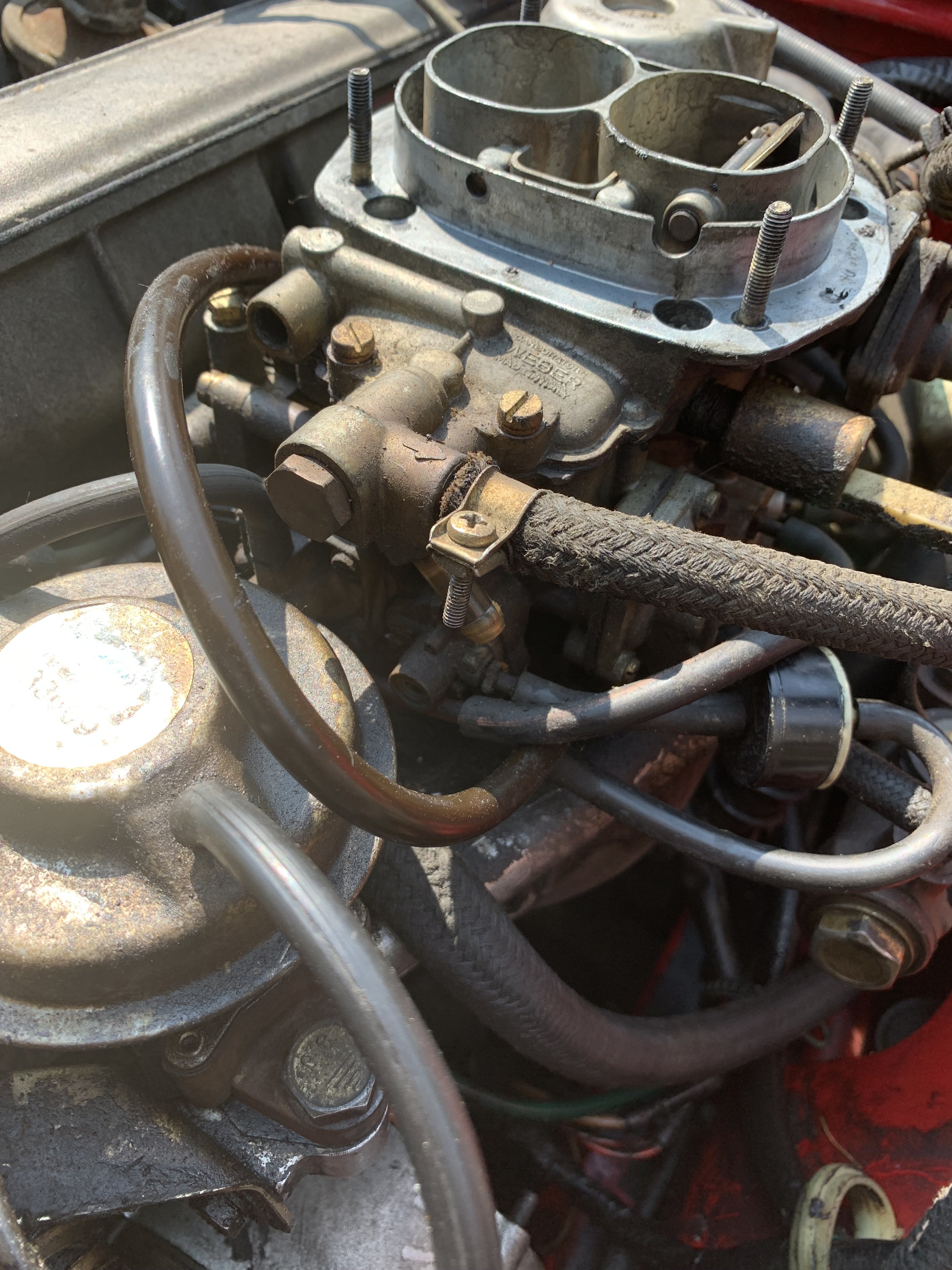

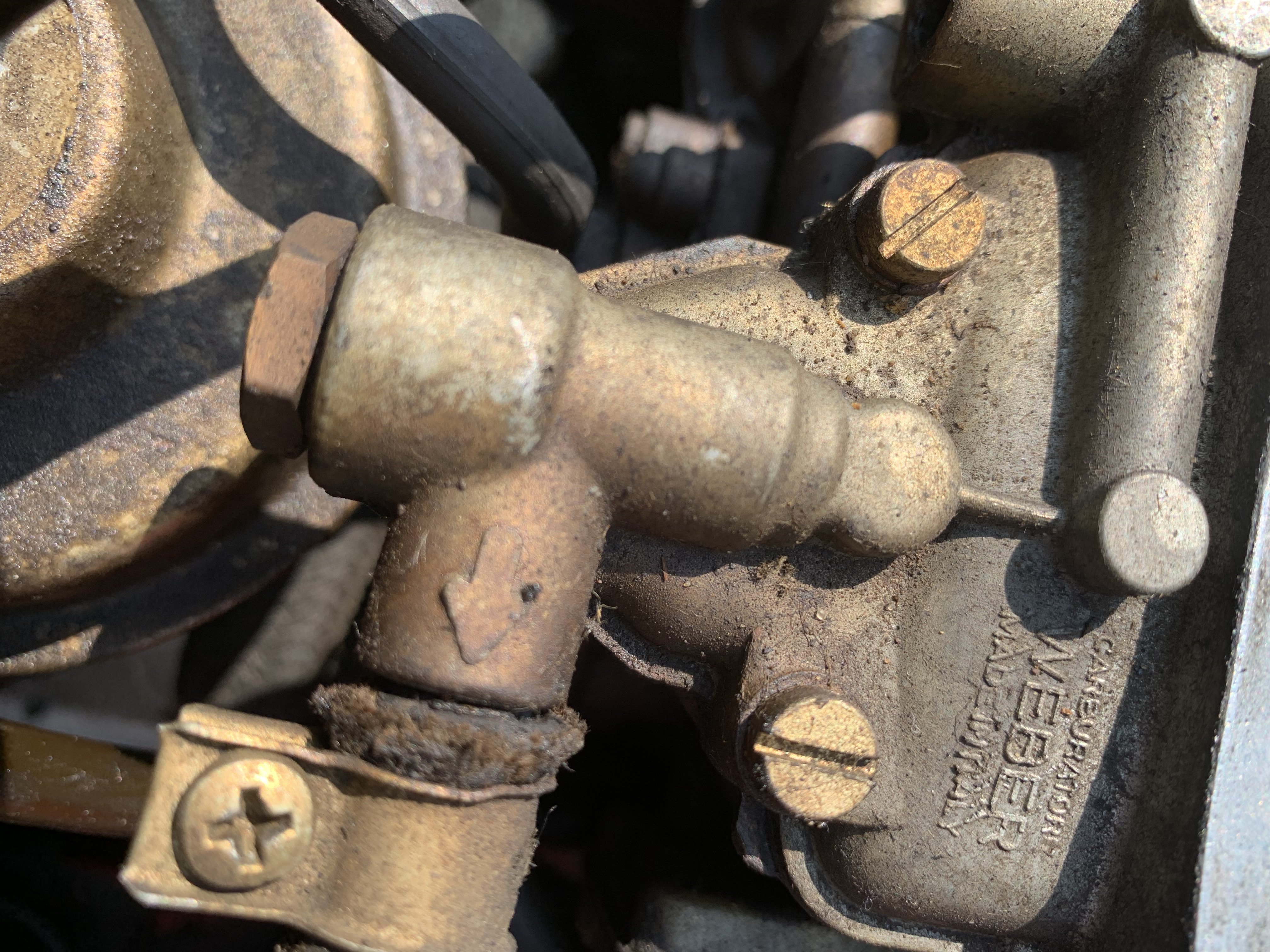

Pulled the mechanical pump today and of course dropped spacer and can’t find it. Anyway, I think I will go to electric pump. Saw many videos and wondering if a regulator is necessary. For safety will connect to oil pressure. Will look for pump with 2-4 psi.

Sorry, this is the line that goes back to the tank. When the float closes off has will this keep the carb from flooding

All you can do is try it, personally I would be happier with a regulated pressure.
A small point if you refit the old petrol pump without the spacer it can cause the operating arm to snap off and drop inside engine as it affects the position/depth of arm onto operating cam. It is there to keep heat from the fuel pump like an isolator but it is also a spacer.
