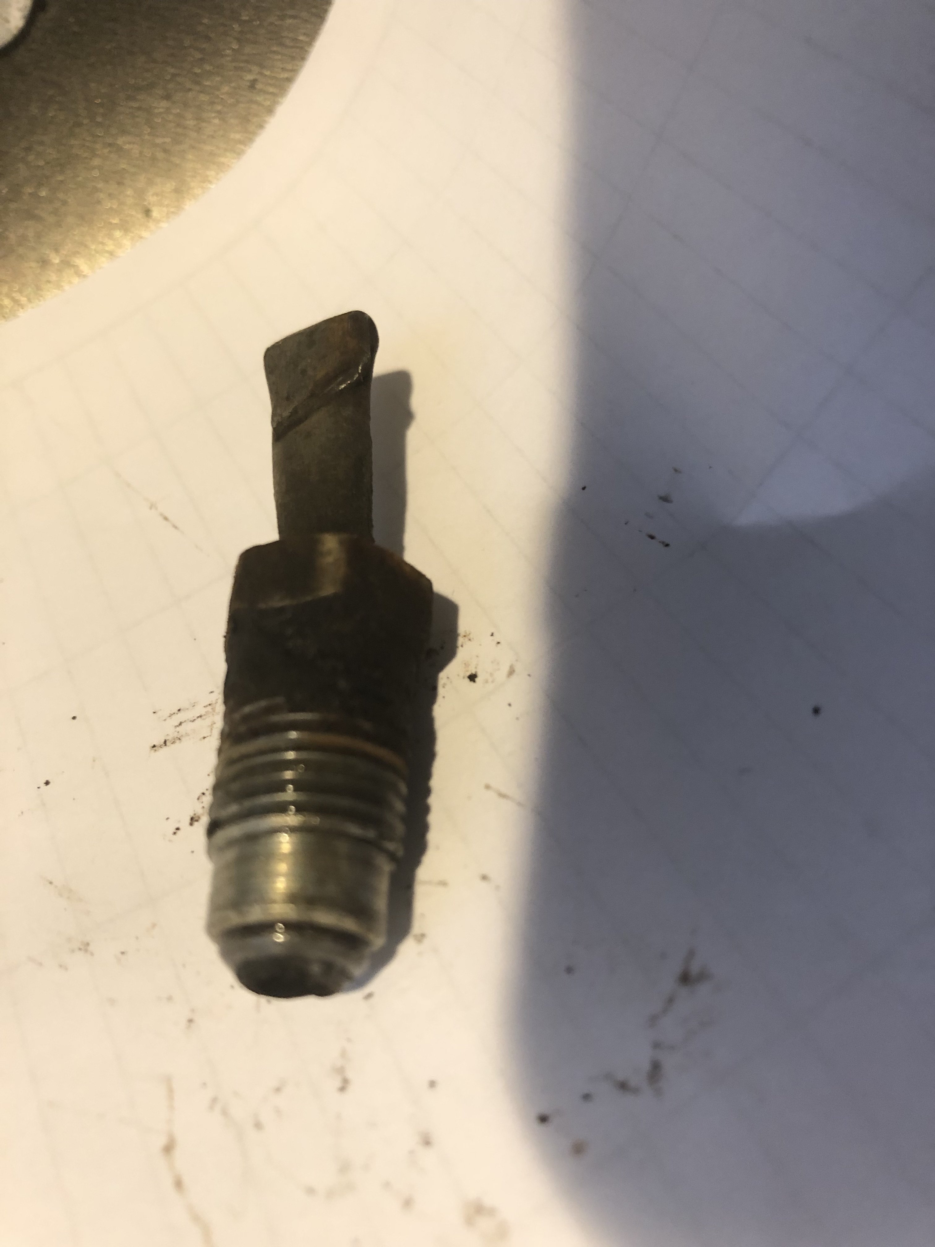

There is a part above each spark plug that I have no idea what are they - see attached photo. Looks like they are dicommissioned by kinking the copper pipes on it.

There's one of those doodahs above each spark plug. I wonder if they're knock sensors since this is a US model and is likely to have had all sorts of random fuel/ignition/emissions devices on it compared to what we're used to.

I found my US spec 128 manual, it only states:
a valve on the carb to do with emissions but on cold start, same on X19
Seat belt sensor
Detuned engine, again to do with emissions
