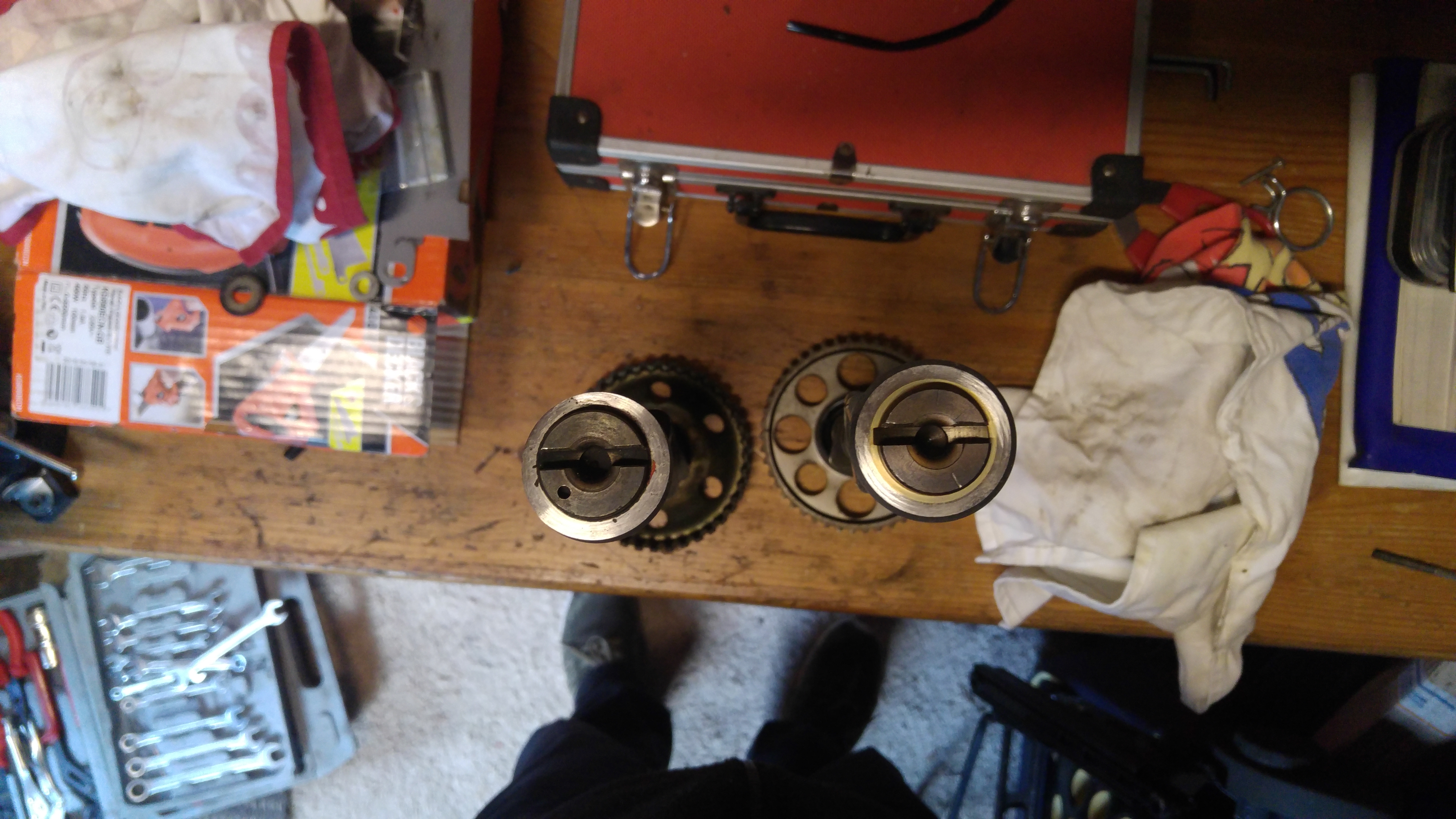

Was going to buy a seicento sporting for full engine swap but ended up not going for it. Same guy has an 1108 engine there too, ive no ecu etc for it so was going to go down the route of bottom end swap instead. I am supposed to go get engine today but am i just throwing money away?

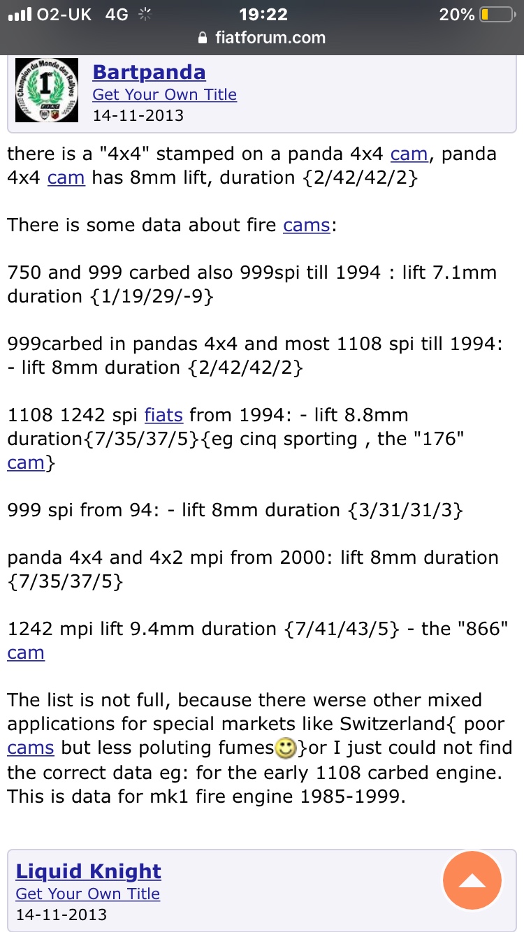

Ive been told to upgrade my cam as well but have been looking online and dont know where to find one.
