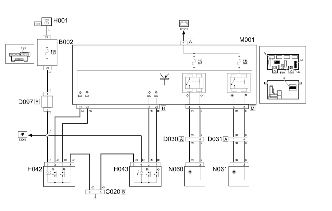

The body computer node M001:
  • receives the signal from pin 14 connector H for raising the driver's window;
  • receives the signal from pin 24 connector H for lowering the driver's window;
  • receives the signal from pin 15 connector H for raising the passenger window;
  • receives the signal from pin 25 connector H for lowering the passenger window;
Having received the commands, the body computer node supplies the electric motors for raising/lowering the window.
To raise the window, the body computer node supplies the electric motors N060 and N061 from pins 3 (driver's side) and 4 (passenger side), connector M.
To lower the window, the body computer node supplies the electric motors N060 and N061 from pins 2 (driver's side) and 5 (passenger side), connector M.
It's all controlled via the body computer
