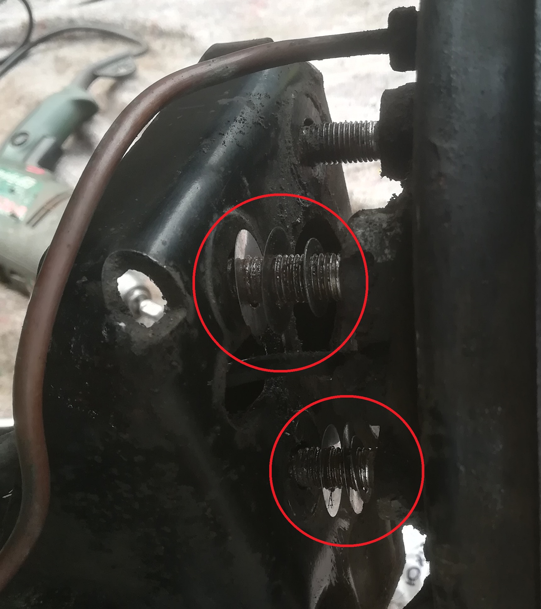

For modifying a 500 axle, I would -
Make flat plates that accurately fit the stub axle face and bolt on with LONG "all thread" studs.
Weld strong temporary brackets top and bottom to the swing arm.
You can now cut out the excess chassis metal and measure the gaps accurately.
Fit 25mm spacer blocks (and longer bolts) between the stub axle face and the temporary bracket. This retains alignment while you weld it up. Weld it up and finally cut off the temporary brackets.
This temporary bracketry is needed to copy the old bracket location and later jig the new position. "All thread" studs and spacer blocks keep it all square and aligned. The other way would be a full jig that the whole axle slots into. Even then, the stub axle brackets are your only datums.

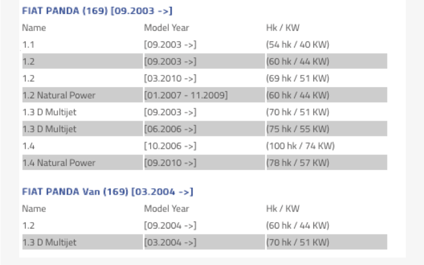

there's a few description like this
FITS
Fiat Panda 2003-2012, Diesel and Petrol, RHD and LHD both models
Fits both Brake Discs and Brake drums form 2003 to 2012
FIAT NUOVA PANDA - MY - CLASSIC
1.2 8V
1.1 2V - 1.2 2V - 1.3 2V - 1.4 2V
ACTUAL
DYNAMIC
EMOTION
2-SEATER VAN
VAN 4 SEATERS
ALESSI
1400 16V CF4
Please Note: This item will not fit
4x4 cars
NATURALPOWER
TREKKIN 4X4
CROSS-4X4
CLIMBING4X4
ADVENTUR 4X4
