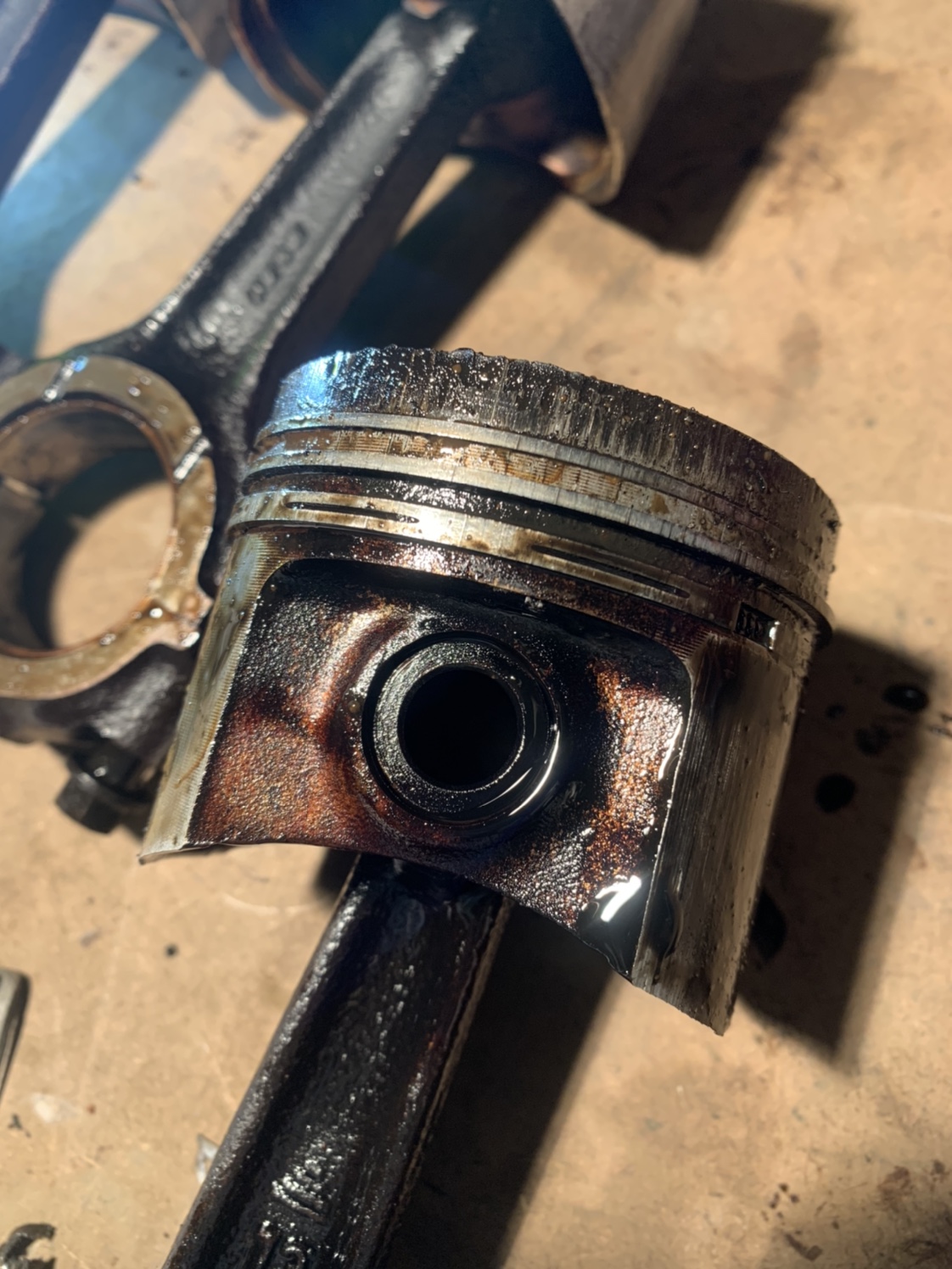

Yup, 1108 block marries up. Extra capacity is in stroke not bore so to keep it standard you'd need to swap in crankshaft and rods, but easier to just take the extra cc, the carb will run it no bother. Keep the original head for simplicity, injection heads don't have the hole for the rod that drives the mechanical pump and you'd need to be pretty accurate to drill it out.
