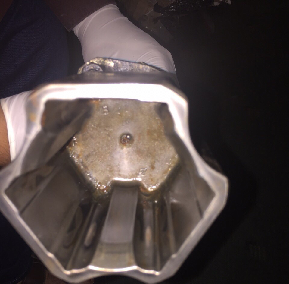

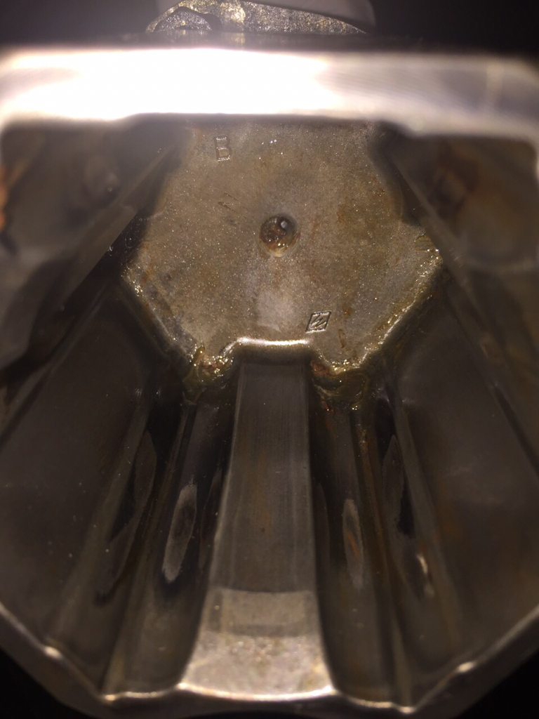

Which side has the longer driveshaft? Is it the drivers side?
A lot of damage on all sides of the cup (drivers side).
ImageUploadedByFIAT Forum1438295070.417720.jpgImageUploadedByFIAT Forum1438295749.158430.jpg
Replaced the full driveshaft on drivers side.
Yes I had to replace it, it had wear on them.
Will keep a look out now and replace the grease
