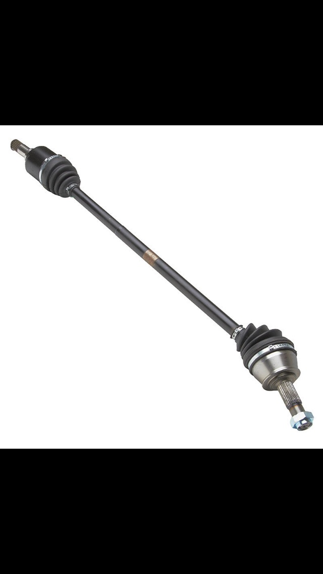

Hi i recently had a problem with my bravo as it vibrates at 40mph and its been diagnosed with a o/f drive shaft problem. Im looking for a decent second hand shaft but all the ones ive seen my mechanic has told me they dont look like mine even tho they state they are for fiat bravo 1.4 2007 onwards. Apparantly my o/f shaft has a knuckle in the middle were as the ones ive seen have one at each end of the shaft. Im no expert but i was hopefung someone on here could help me with this problem and give me advice with what to do thanks.
I have attached a image (if it works) of one of the shafts for sale
