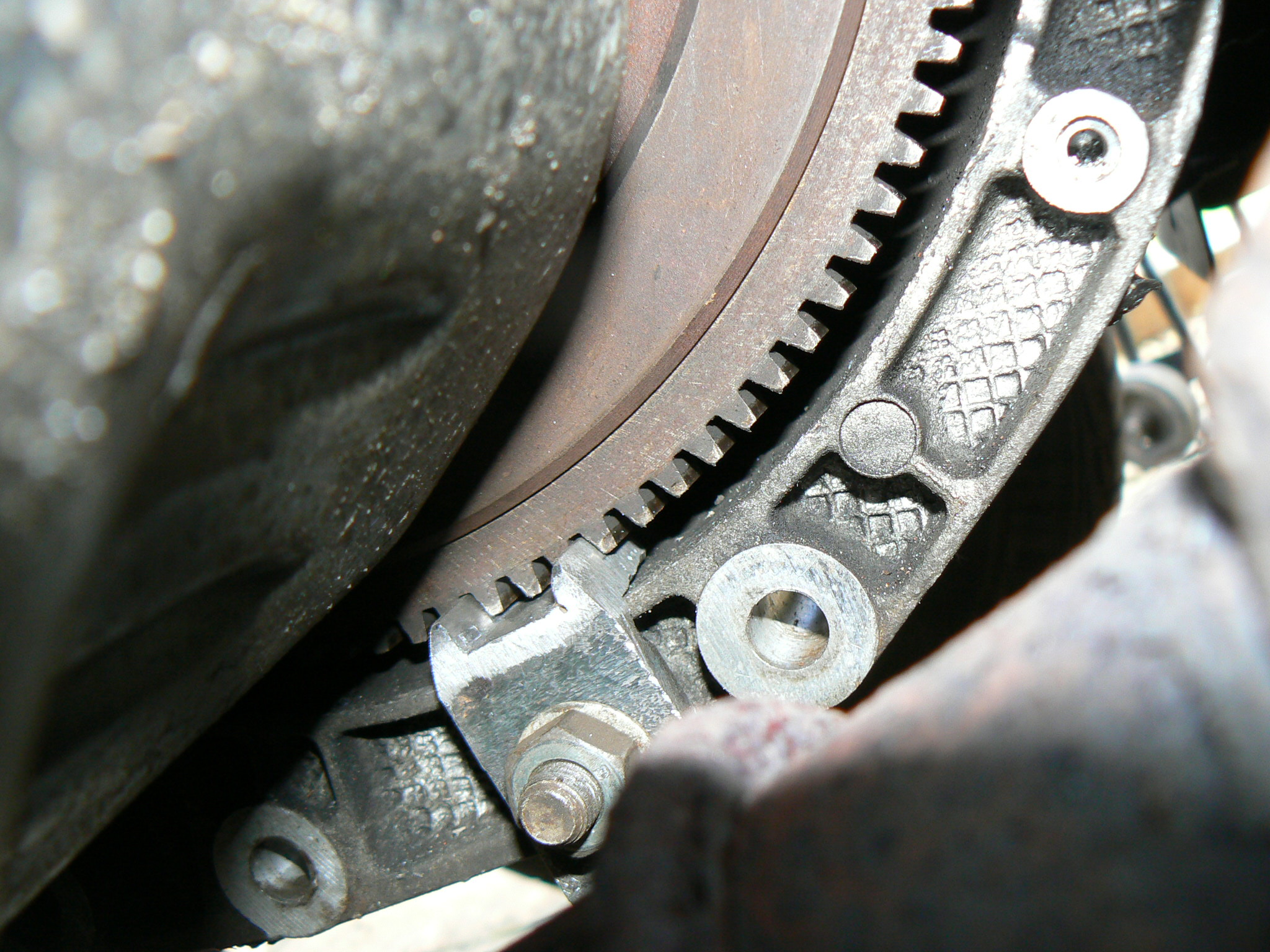

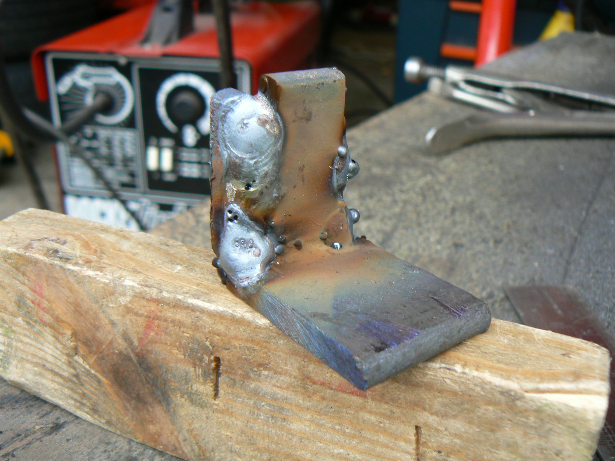

Pugglt Auld Jock said:Last year, before I started on the cam belts, I had a look at what would be involved in undoing and subsequently torquing up the crank pulley (sprocket) bolt. Having had these off various engines over the years I know how tight they can be. Some seem to recon that the crank locking tool is strong enough to do the job. But, as it only uses the 6mm bolt which holds the belt cover and the aluminium lug it screws into on the front of the engine doesn't look all that robust, I don't think I'll be trying that. Of course you can jam the flywheel ring gear with a large screwdriver but this is awkward when it comes to angle tightening the bolt on reassembly (I work on my own). The Haynes manual shows a DIY flywheel locking tool which I decided to make. The Haynes one has only one "tooth" I decided - without thinking too deeply about it - to make one with two teeth so it would be strong! (The bolt goes up really tight!). What I hadn't thought about was that a considerable degree of accurate filing is needed to make one with two teeth because you have to accurately replicate the pitch of the ring gear teeth! Anyway here, for your delectation and my satisfaction, is the device I made - which, of course I then didn't need as the seals weren't leaking!:
Very nice job on that locking tool! I wish I were more capable when it comes to metalwork. I have a fully stocked workshop for working with wood but very limited when it comes to metal. Welding in particular is a skill I have yet to acquire but one I frequently could make use of. (Another job on the list for the 45/ZS is some under body welding for starters...) I certainly appreciate the difficultly in recreating the teeth too (I've made some wooden gears for jigs before), so you have my respect for getting it done!
